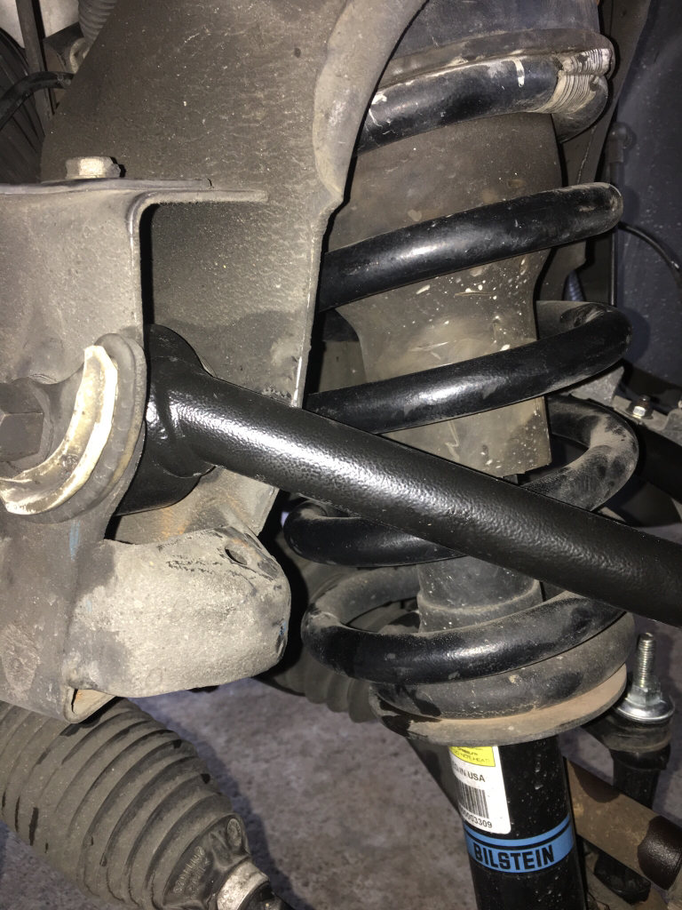

So I finally got the 2.5" front and 2" rear supreme suspension leveling kit installed along with rough country UCA's. Also installed rear Bilstein 5100s(wow at the much better ride!) I did not have to use the rough country shock extensions with the 5100s. It seems the previous owner had already replaced the front struts with Arnott/Blisteins (part #SK-2487). I looked these up and it seems to have came with resistors (although I can't find them). I also installed resistors on the rear and as of now I have no dash lights or warnings. My question is do I need to pull fuses (I did before installing resistors but put back in) and leave them out? Also do I just leave the compressor installed? I think I'm sort of done for now until I order actual bilstein 5100s for the front. Included are several photos of different parts. You can see how much more clearance the rough country UCAs have over stock
