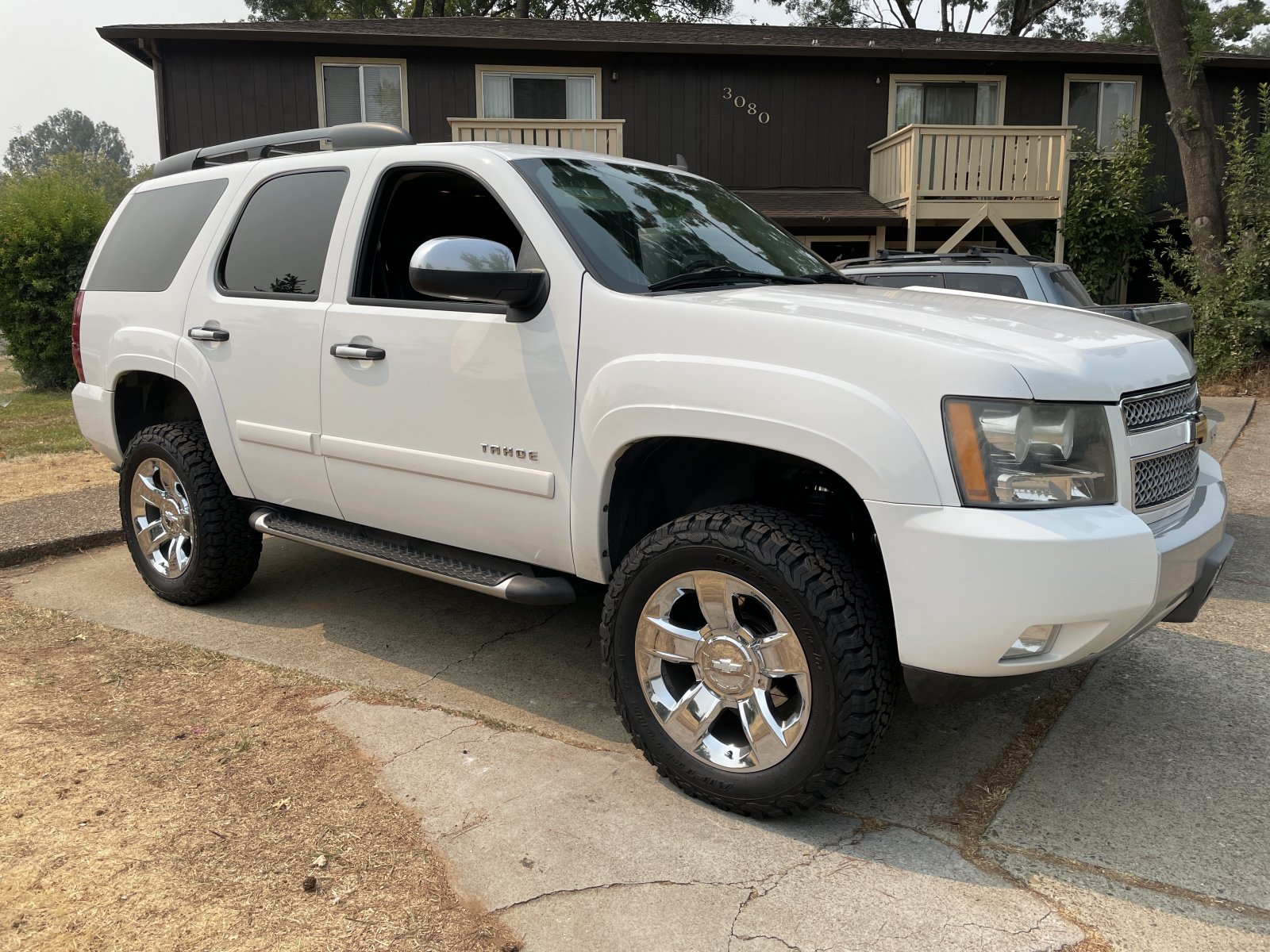

I would rather go with bilstein 5100s with spacers over lifted Rough Country struts.
Here is my Tahoe, the details and build log are in my signature

I fit 35s on stock wheels and x10 wides on a 3” leveling kit
I cleared 305s on 20x12s with a 3.5”
Here’s my thread with plenty of different lift wheels and tires configurations
Rough country shocks suck and personally I diddnt like the bilstein “lift struts” rode way to rough I’d opt for fox coil overs if the pocket allows it if not run stock shocks with a upper and lower spacer
Anything over 3” really needs control arms and differential drops
