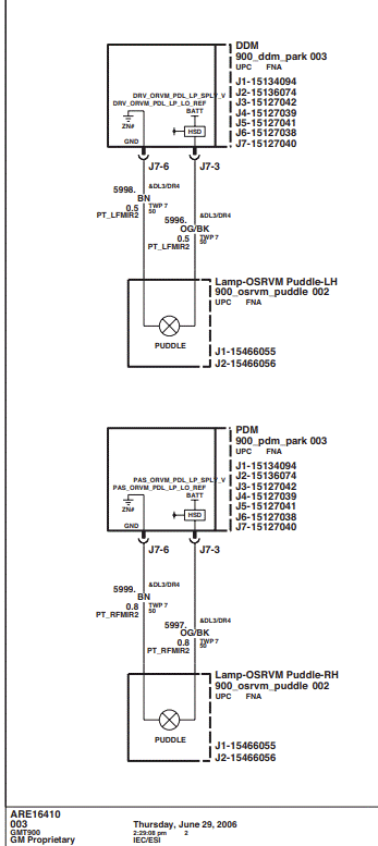

looks like they get power from the respective door modules (switches)...
which probably get the signal to turn on puddle lamps from BCM is my guess.

My driver's side puddle light stopped working. Both mirrors are aftermarket TYC assemblies that I got from RA. If you look at you tube, it showed the bulb replacement with one like you would have in a dome light assembly. I removed the puddle light housing and it is all sealed. To fix, I would have to get the correct assembly, likely from TYC and splice it in.
