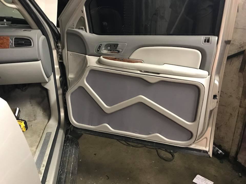

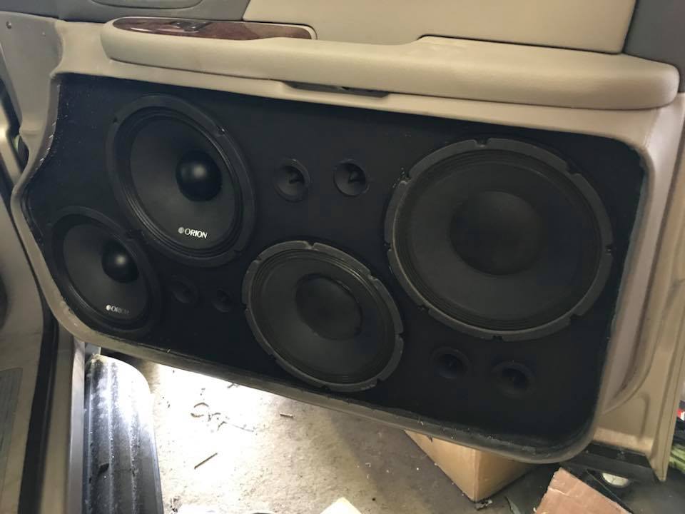

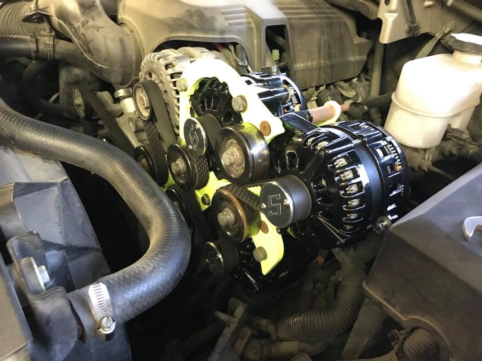

A little something I did in my Suburban
iPad Pro 9.7"
optical to Audison BitOne
8 10" midrange's in the front doors
12 Tweeters
4 15" Sundown Zv5 15's
2 Taramps HD10000's on subs
1 Taramps HD10000 on 10's
3 Singer alternators

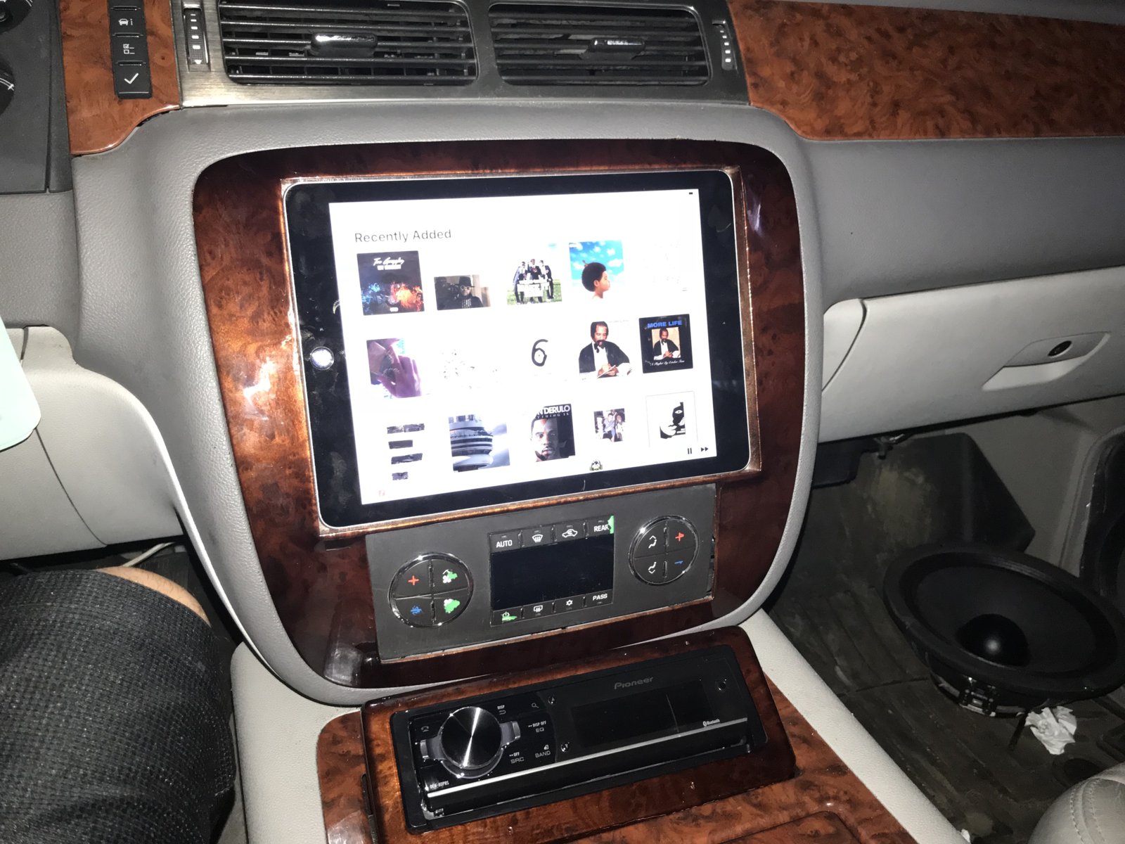

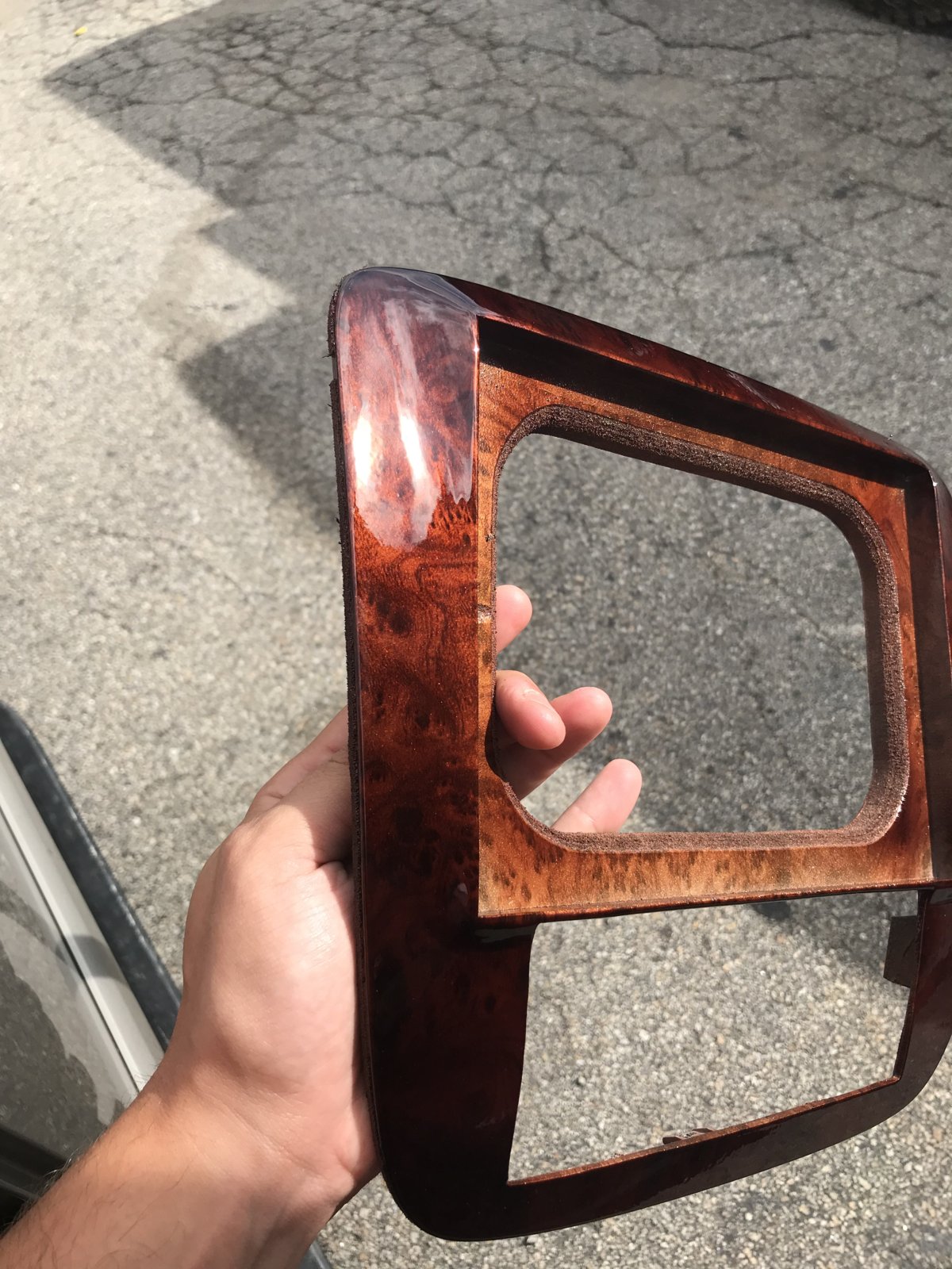

Dash isn't 100% yet. I still have to get everything perfectly smooth then vinyl wrap it with some 3m Burlwood to match the rest of the woodgrain in the truck

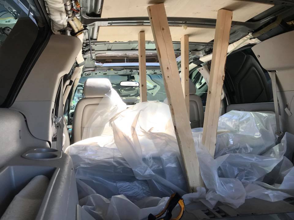

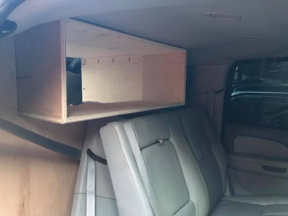

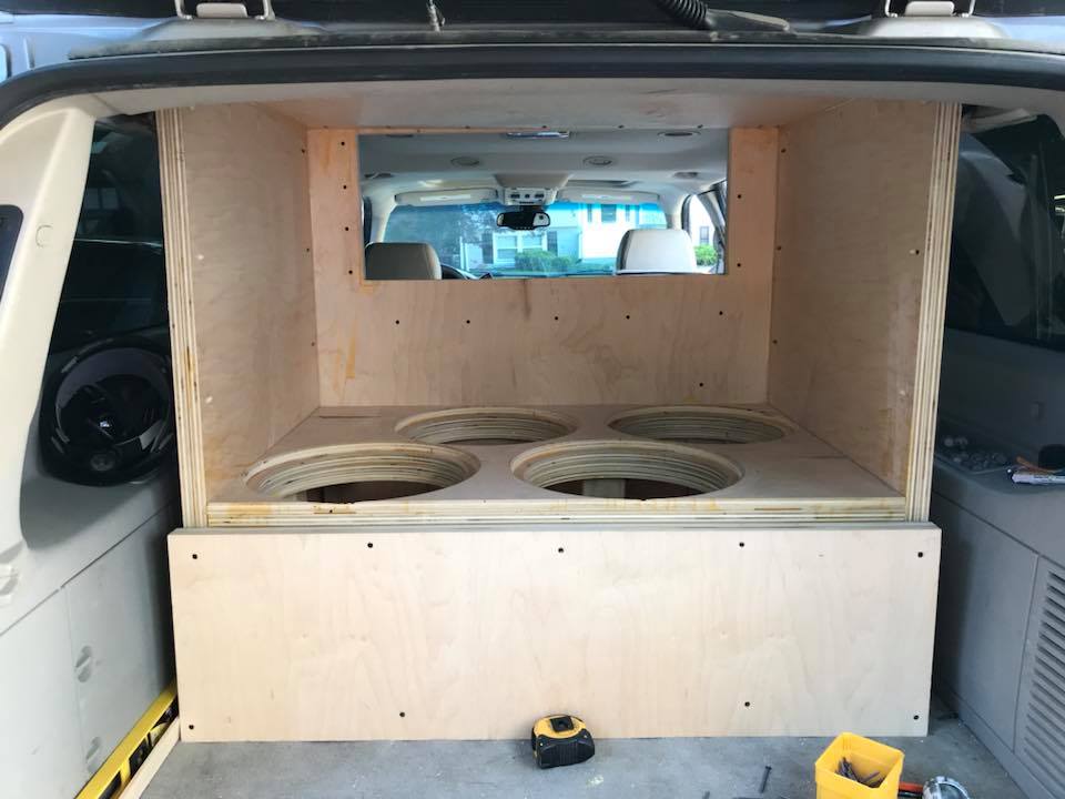

Wow. Wonder how that's gonna sound!

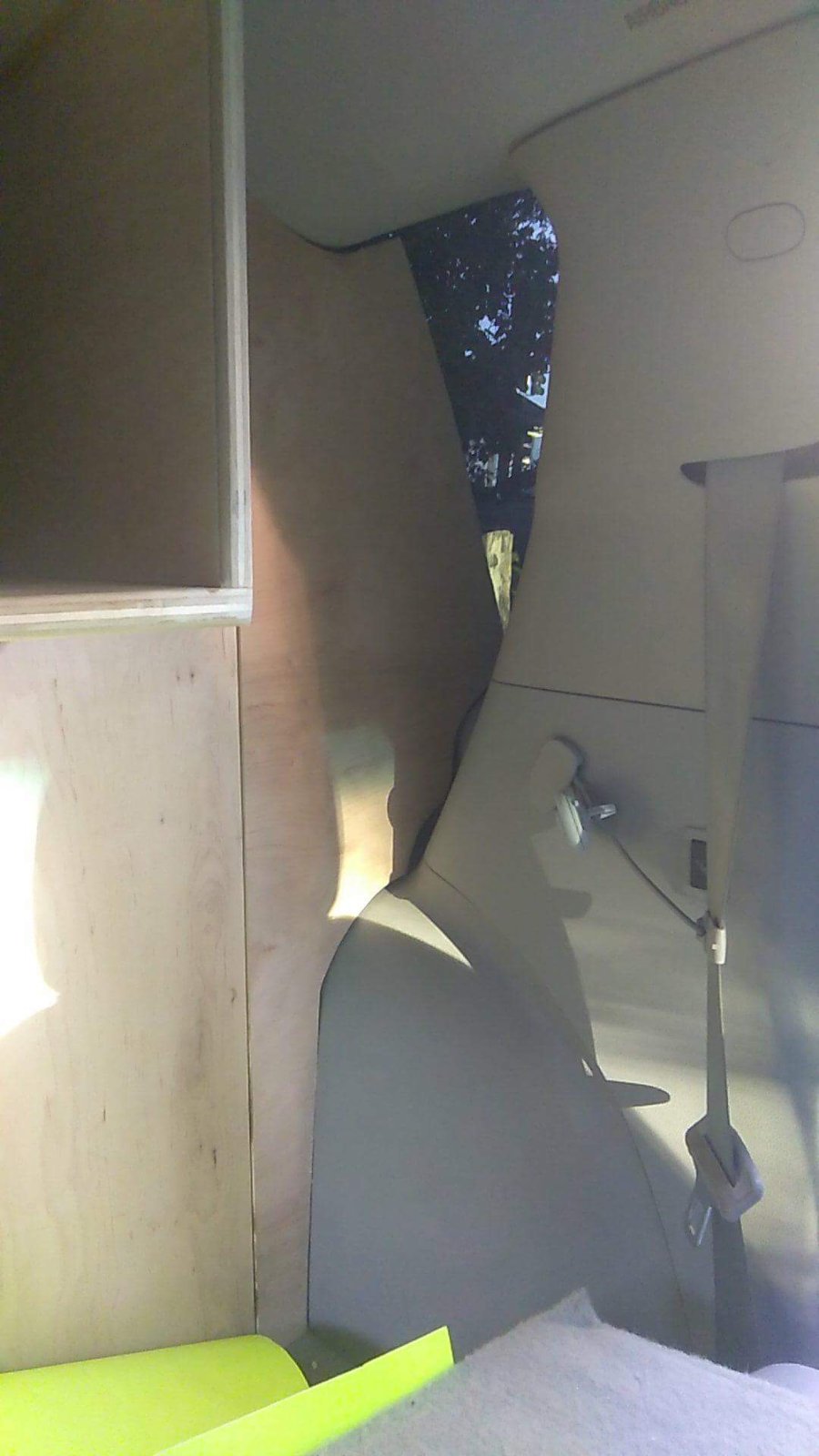

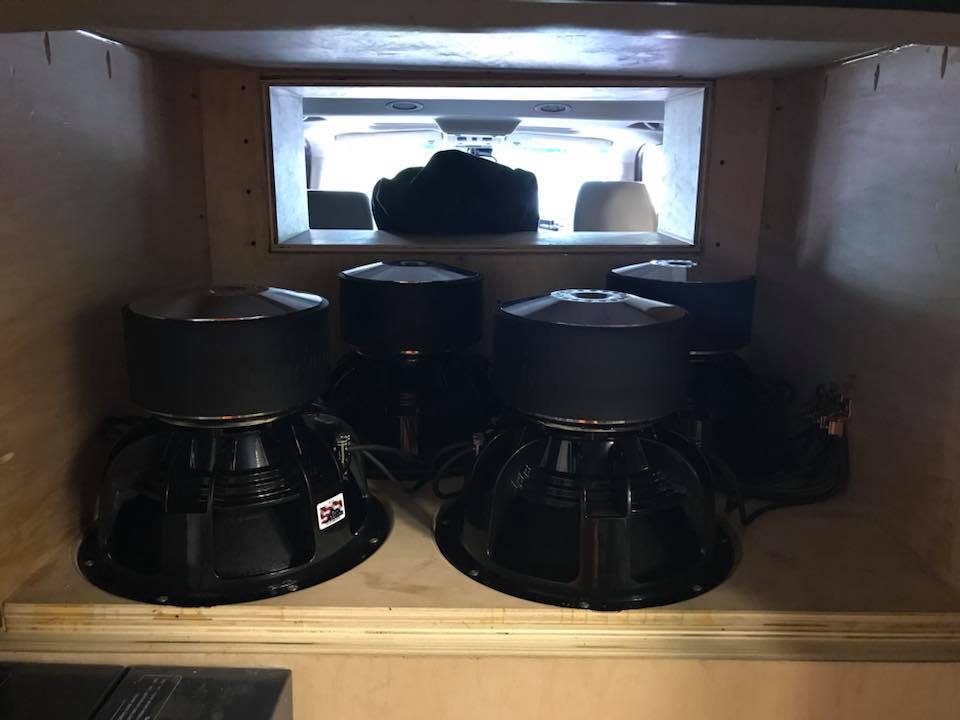

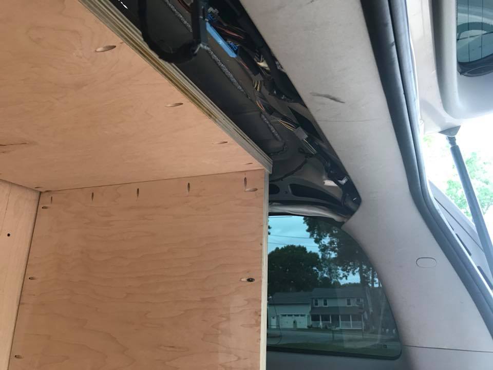

It sounded ******* incredible... yes that's past tense. I ripped it all out (subs and box) when I ran into a bunch of electrical issues. Plus the box was so tight to the roof that it squeaked when I went over any bumps or off-axis turns and it drove me up a wall
I'm rebuilding to a much smaller setup but will sound equally as good and I'll be gaining some cargo area back. The doors are staying the way they are

How many cubes in that box? What’d you tune the port to? And did you ever get it on a meter before tearing it out? Looks like it had some real balls to it.
Can’t wait to see what you do next, those doors are pretty sick as well!
Doug118
Doug118
Sep 22, 2012
558
1,052
Thanks. The box was like 25ish cubes net. Tuning... I have no idea lol. I started out with like 330sq/in of port and made it so it sat like 1” before the face of the seat. I’m not a fan of meters. It played flat from 25-50hz and could play down to 15hz without any problems
Thats because u built a box and not a wall. When walling a vehicle U have to make it one to the vehicle. Gotta seal it off proper. Not hating just saying if your going to build it build it right
Doug118
Doug118
Sep 22, 2012
558
1,052
Yup you’re right, it wasnt done right

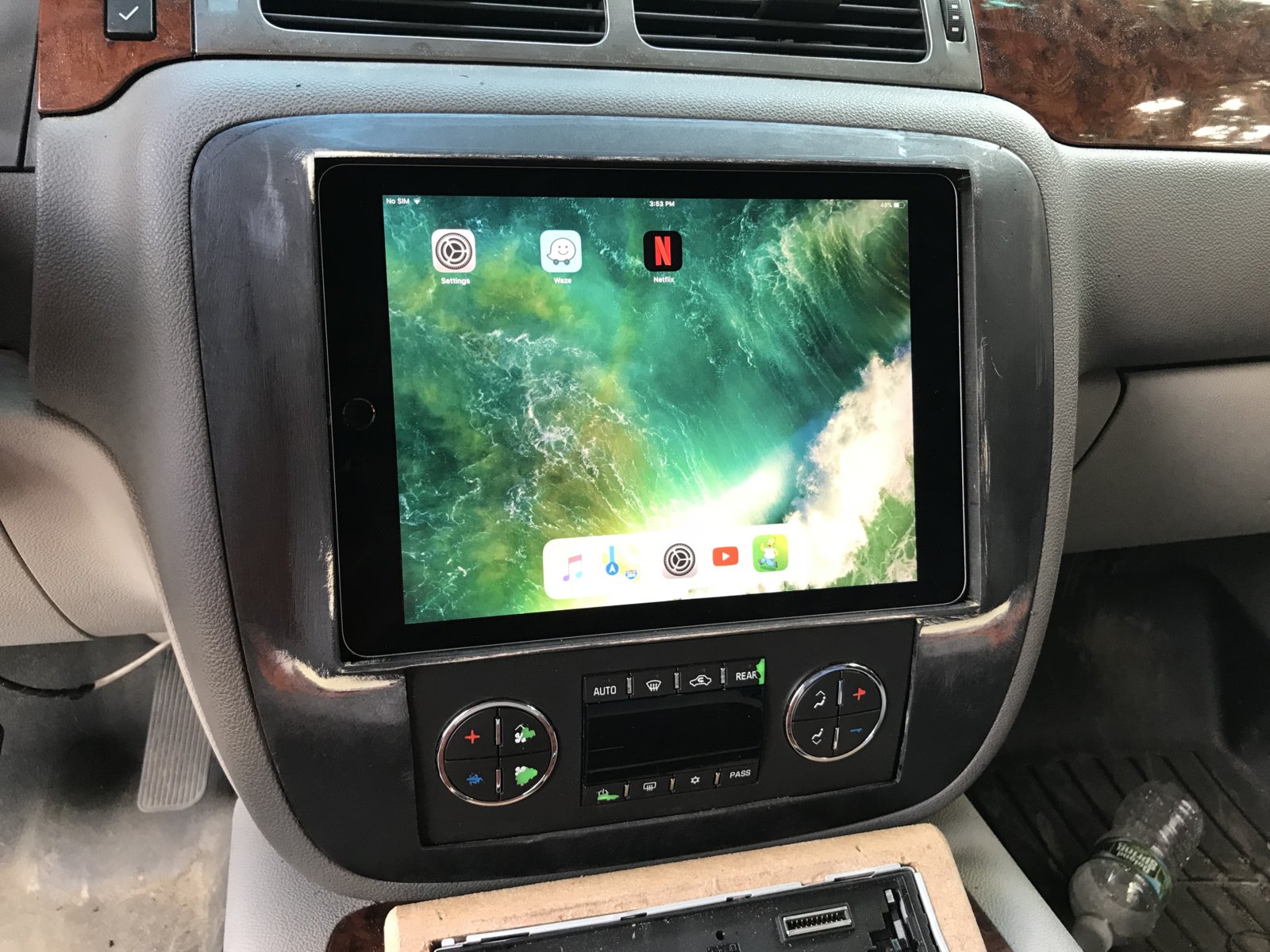

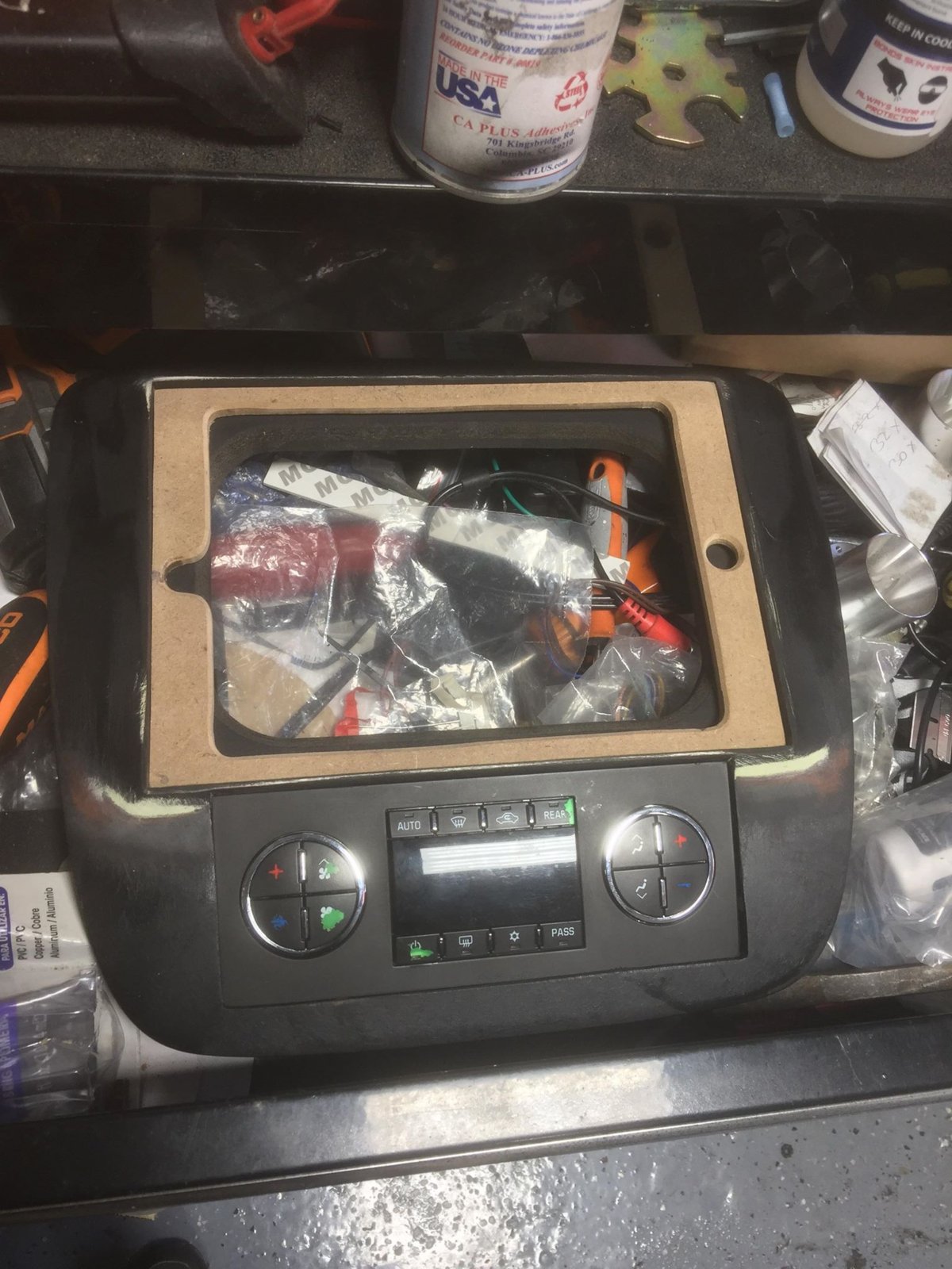

And this what the center console should look like. Love it. I would go with a 10.1 Android 2 din radio though. I rather the Android eco system
I've never been a fan of androids. I've yet to see a full size ipad in one of these trucks that looked this factory so I'm really happy with the result

Looks good and better than anything I would do. That matt black on climate control stands out. I think the next version should have a face plate to cover everything except buttons., super thin but its the weakest point look wise. Even a glossy black would work better.
