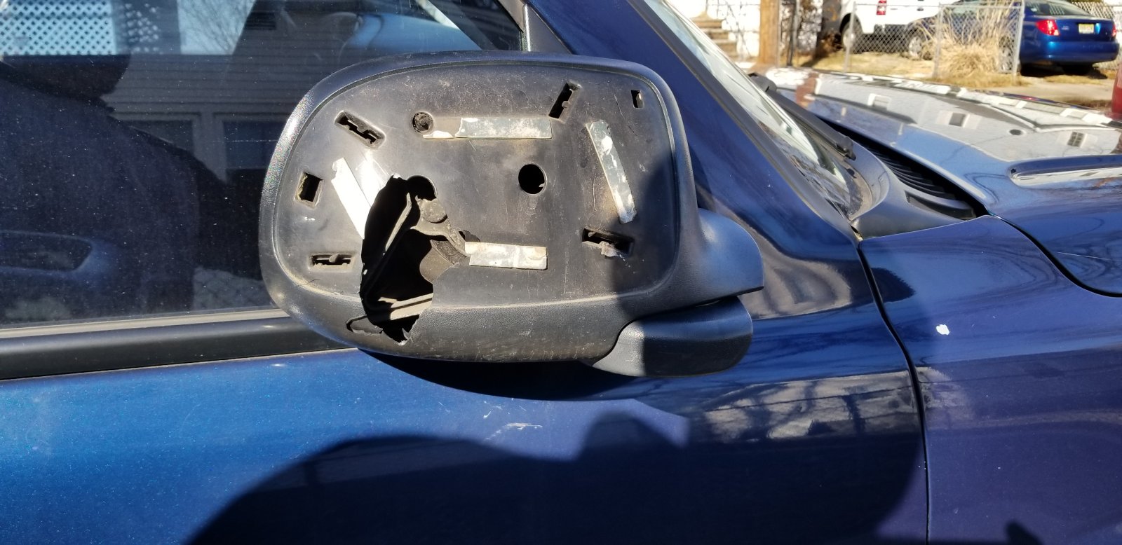

The color matched mirror covers are held on with double stick tape. You can pry them off carefully without any damage and you can reuse them on another set.
Interesting. I’ve pulled apart a couple sets of mirrors and the caps I’ve pulled apart all had plastic snapping clips holding them in place on the mirror housing and no double sided adhesive anywhere.
33,336
51,819
Yes, it's broken.
Only tape was used to hold this one on.

Hmm, I've only seen the tape used.View attachment 482043
Yes, it's broken.
I'm all fairness mine did have the plastic clips, but just like a lot of other old plastic clips, they tend to break easily when pulled on. So foam tape is probably recommended even if the clips are still there.
