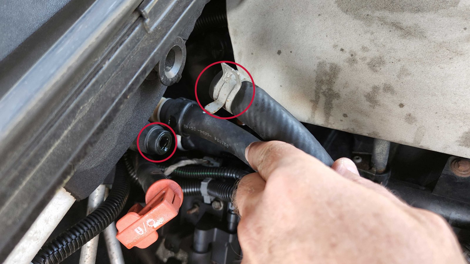

If you have rear heat, get new "T" fittings for the heater hose connections. The plastic can simply give out with no warning.
This just happened to me Friday...
I am just over 200k on my 04 Z71. Just driving cross-town, the nipple that one of my heater hoses connects to simply snapped off while driving. Connection broke off clean...
They are $20 parts and not very difficult to replace. I had this happen just as I pulled into the parking lot of my barber shop. I did the repair in the parking lot with basic tools and was back on the road.
I had no advance tell-tale signs of failure. It just broke and my water pump was pumping coolant out at full force.
I was lucky I was 5 miles from home, was able to have tools brought over to me and the nearest NAPA was still open and only 1 mile down the street.
Had this happened on the highway, out of town, I could have had a much bigger ordeal.
Replace them before that happens!
GM original is best.
My best option was the NAPA Solutions part, which was in stock and only $20.
I don't expect it to last forever, but I think it will last as long as I own this Tahoe.
