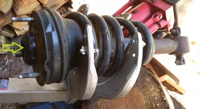

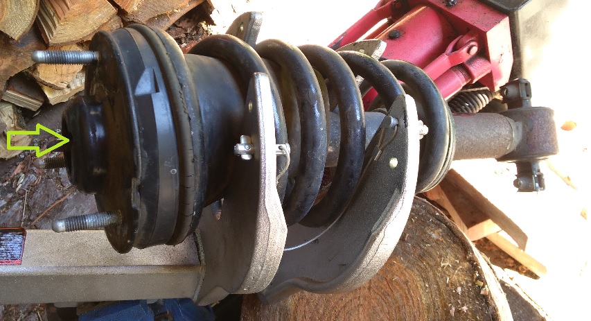

Loaned this tool at Autozone. It probably is a versatile tool, but it took me a while to get used to it. After multiple tries I was able to compress one strut assembly to a degree when strut removal could be performed.
I failed to remove strut. The nut and the threaded rod end are so rusted that they appear as one piece. No tools helped as the nut is located inside recess area.
Apparently I am not smart enough. All the steps above likely would not be needed if I ever inspected the strut nut before proceeding.
