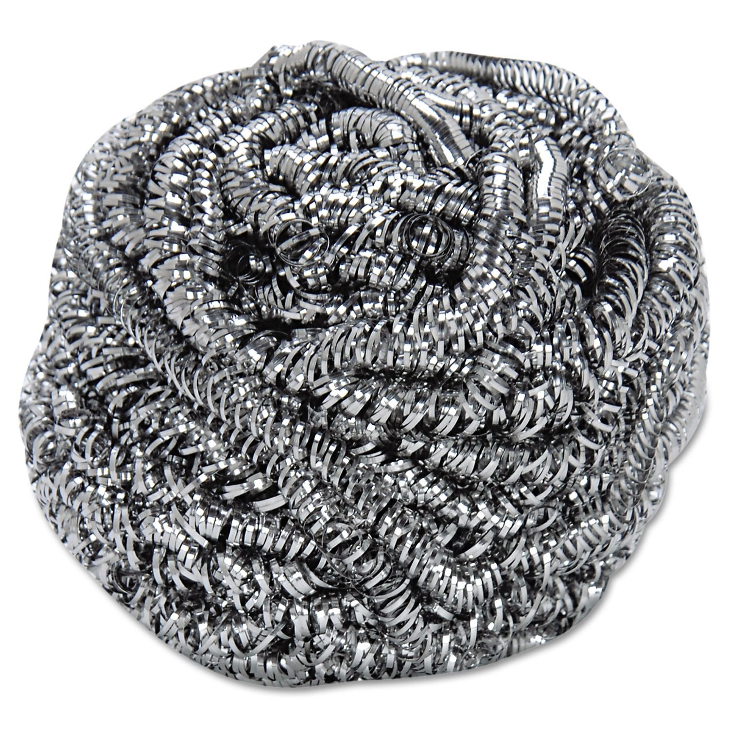

I'd add a stainless scrubber pad to the top of that mesh screen as extra filtration media. I did this to my catchcans.com one and I believe Ken did the same. For the price, I don't see how the multi-hundred-dollar ones could perform any better.
Scotch-Brite 214C:
Scotch-Brite 214C:
That's funny... I didn't see your response until after I responded... lol
I put the scrubber in the bottom (dirty side) of my can and it works great.

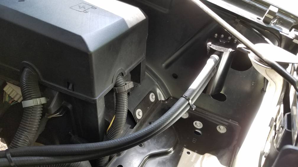

I ordered one. I figured for $40 it’s worth a shot.
I mounted mine in front of the engine fuse box above the 2nd battery tray. I used an existing hole in the fender to mount the bracket with a small bolt and nut. I was able to get behind the panel to hold the nut via the larger cut-out hole near the smaller mounting hole.
Easy to get to and not in the way of anything if/when servicing or working on the engine.
