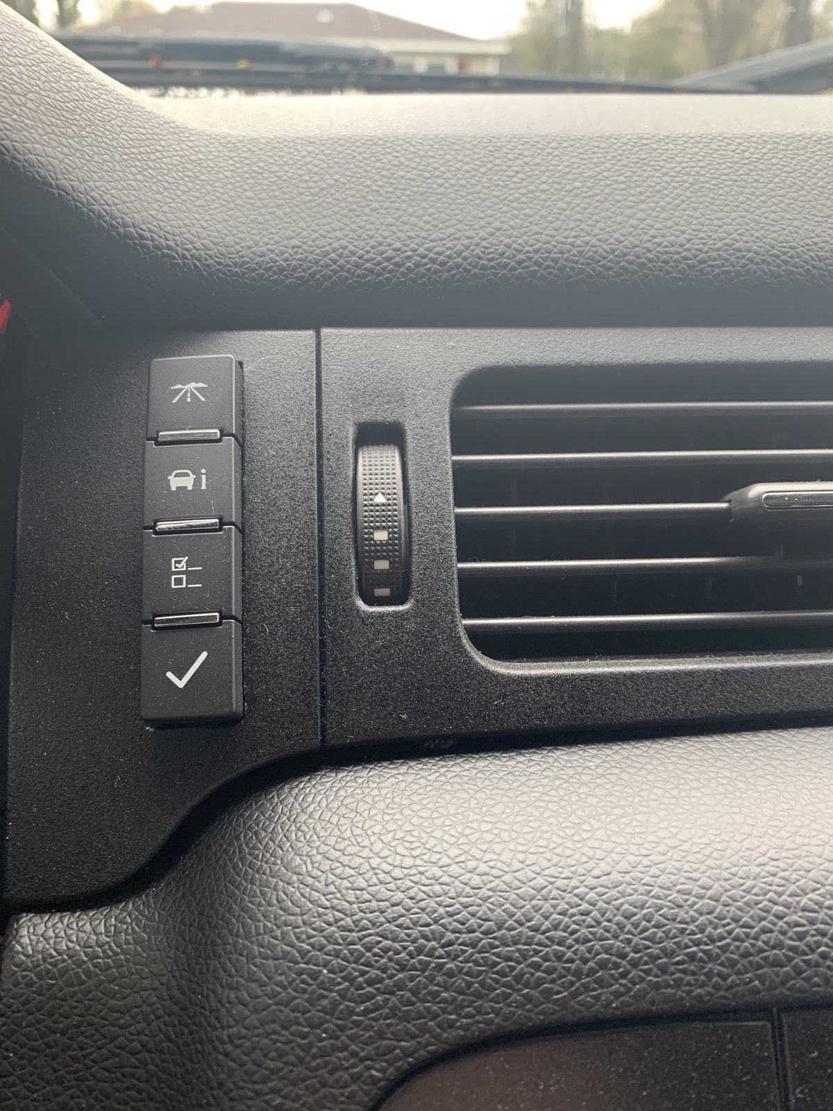

The stealth mode for the lights can be toggled on and off, if you install the DIC buttons. The PPVs don’t come with them, but the wire is already in place, behind the vent trim plate. Pretty easy diy, Inexpensive. I cut the hole for it and had it installed in an hour or so. Can’t upload a pic, saying the file is too big.

Now that I’m looking through the options...I may be incorrect

Yeah, I’m wrong. Looks like the dealership can do it. I wouldn’t think it would cost much at all. I wish mine came that way...I’d much rather have to turn my lights on vs turning the DRLs off, every time I start my truck.
