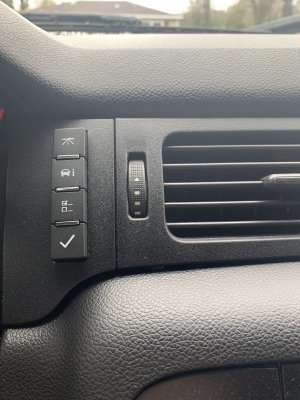

The stealth mode for the lights can be toggled on and off, if you install the DIC buttons. The PPVs don’t come with them, but the wire is already in place, behind the vent trim plate. Pretty easy diy, Inexpensive. I cut the hole for it and had it installed in an hour or so. Can’t upload a pic, saying the file is too big.
