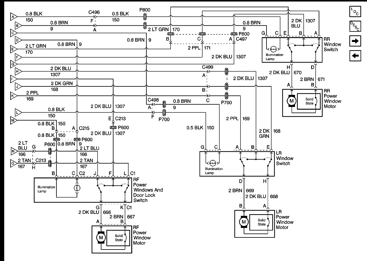

Here are the diagrams for a four-door 98. It should be the same for your 99.

I replaced the switch and it works fine now.
I also replaced the master switch on the driver's door...
All windows operable from driver's door, RR window works on its own switch now too.
Looking to put a new switch in the LR door and will order one for the RF door as well.

LR door switch is in and all is well.
Looks like I had a bunch of bad switches
