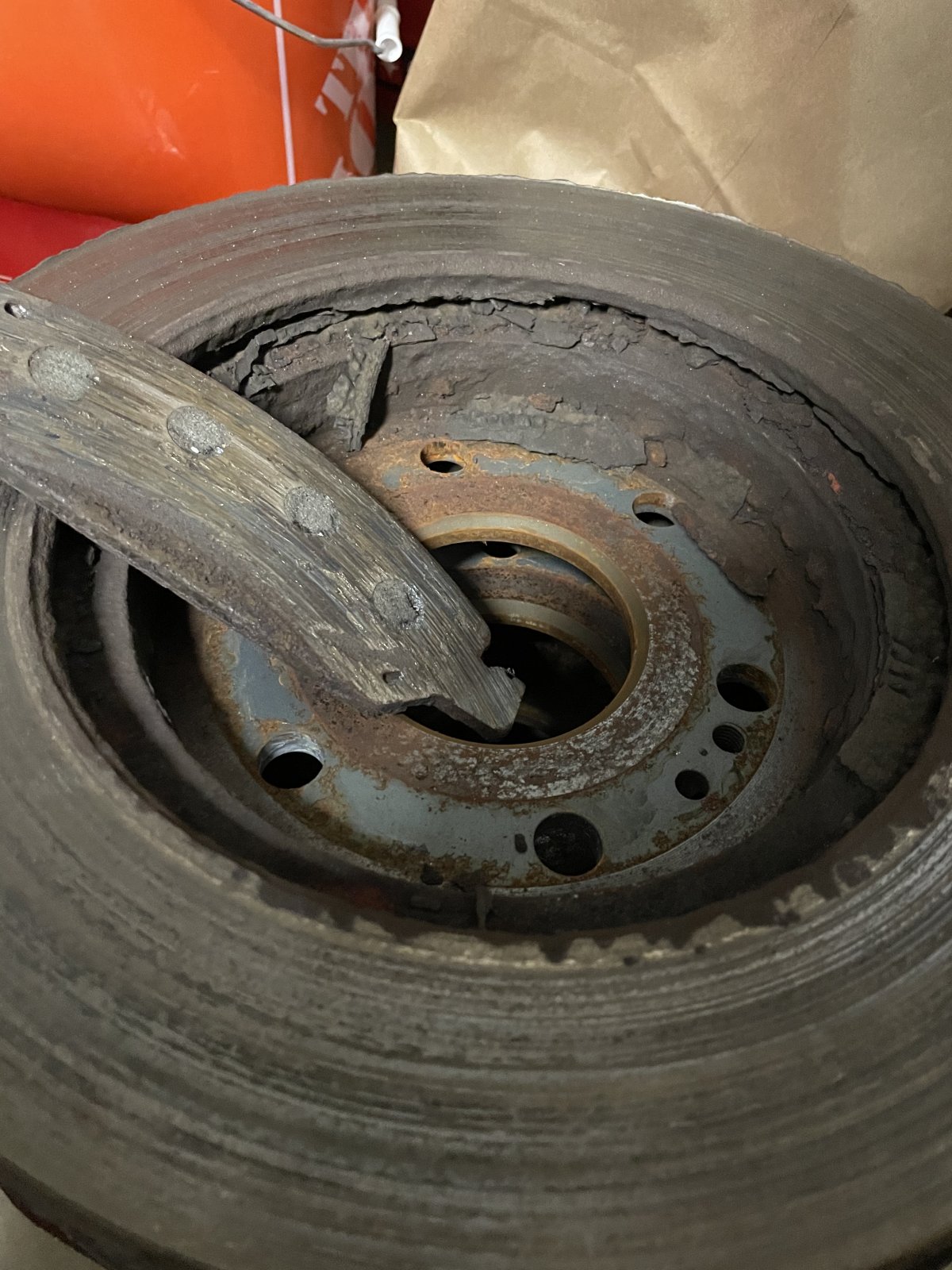

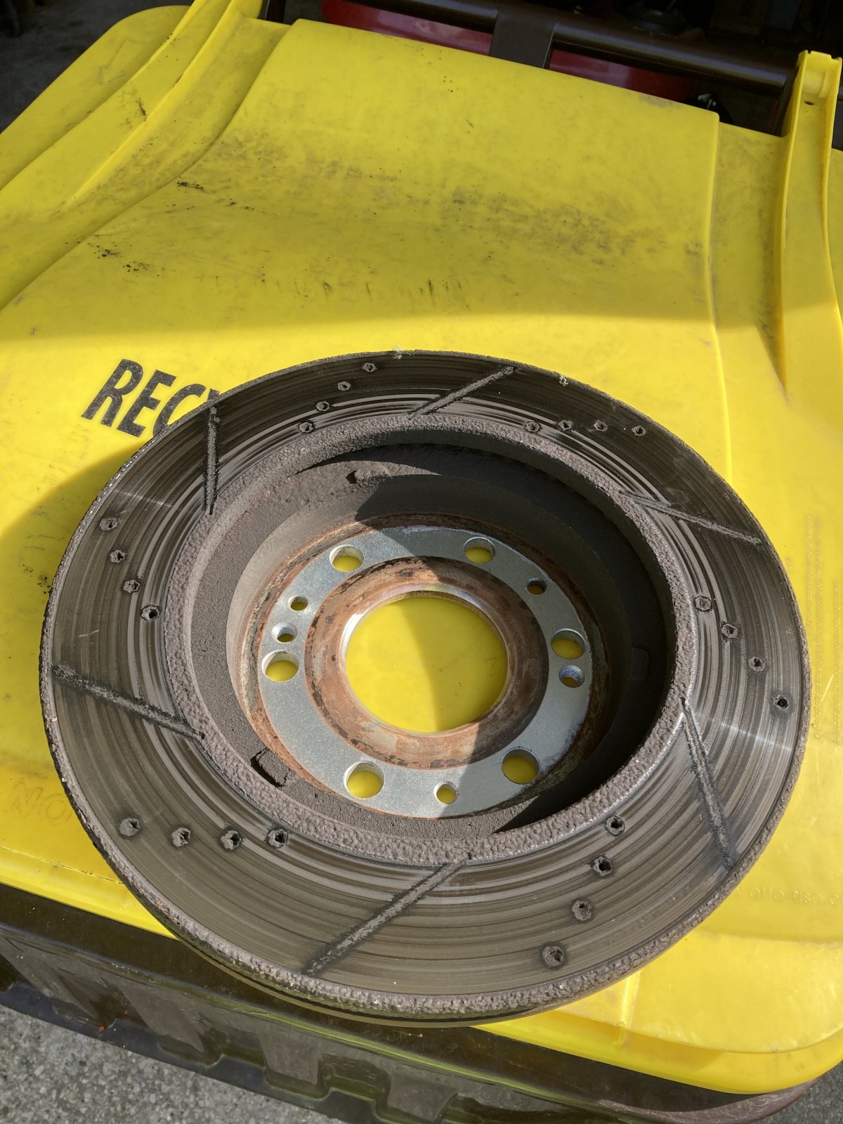

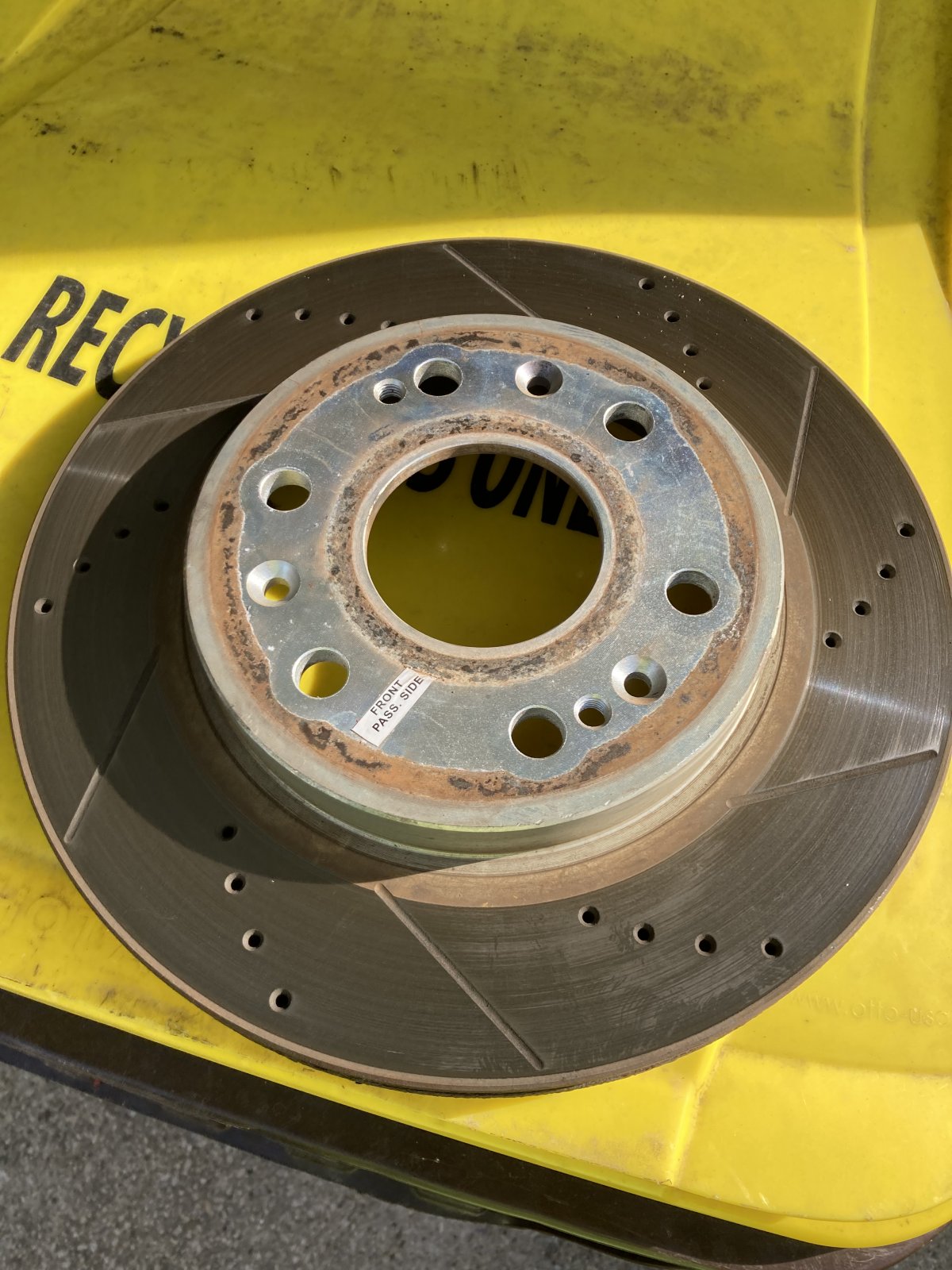

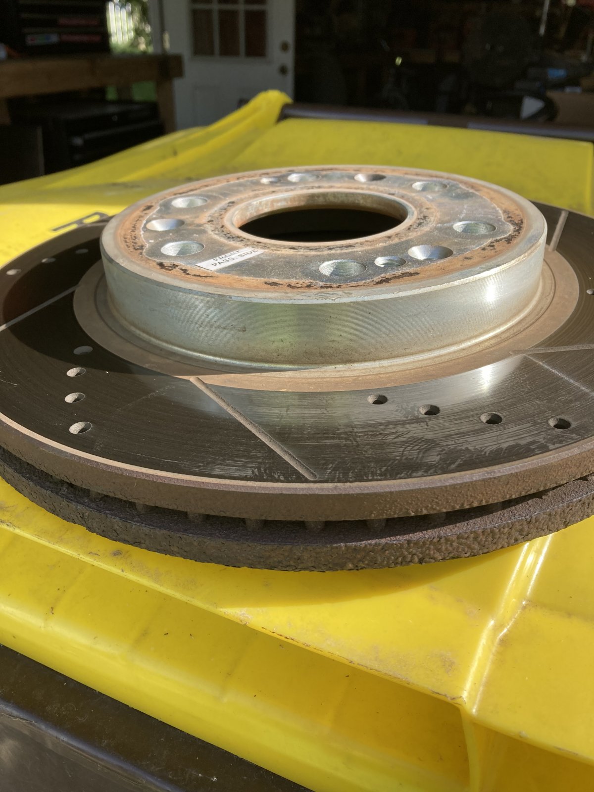

What happened on the back side?
pretty sure he had a stuck caliper, nothing inherent to the rotor would cause that.
Yes. However I replaced all the calipers a year ago, and now I have a rear rotor taking a crap in the same fashion. Just sharing my experience, not trying to be a negative Nancy.

rotor isn't going to make the caliper stick, I have had 2 new sets of gmt900 calipers go bad back to back they don't seem to hold up as well as the gmt800's did

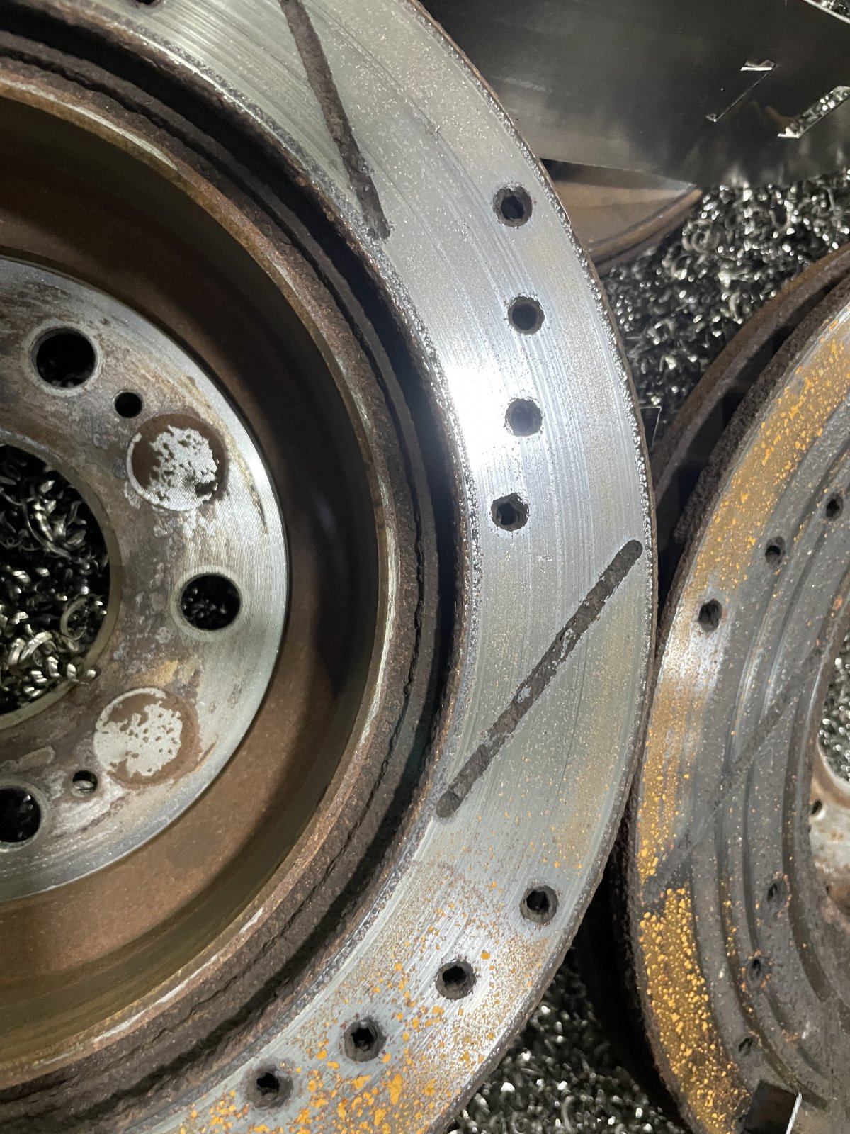

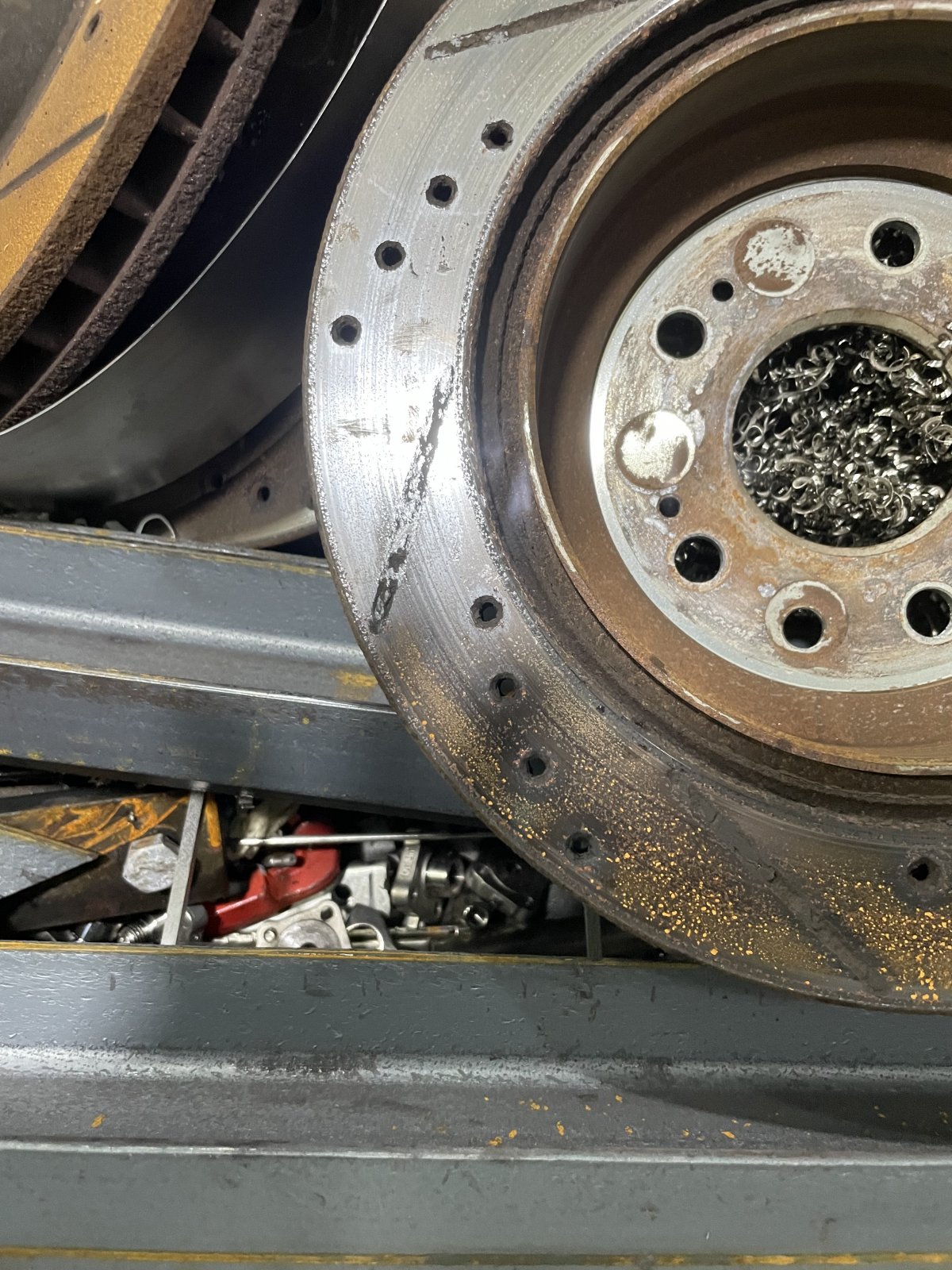

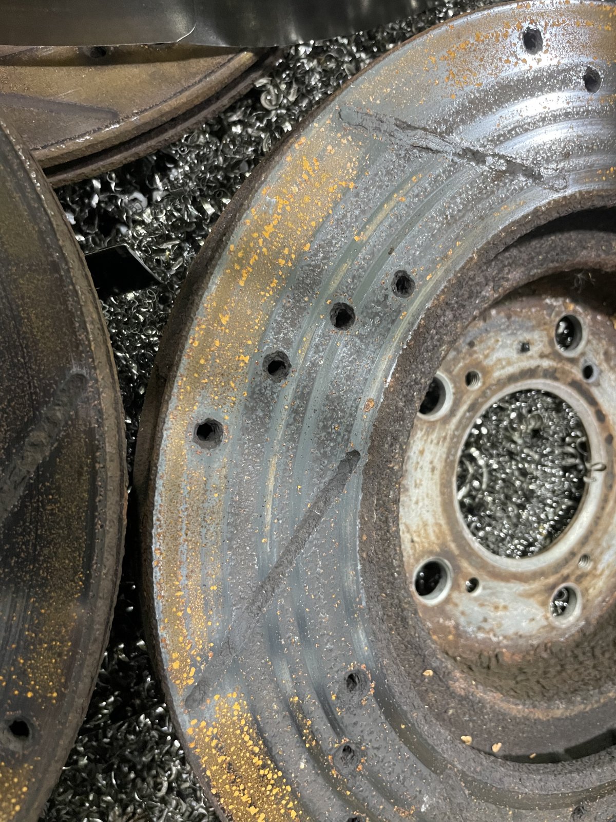

I agree but around here it is a different level of rust. Stuff gets ****** fast! It's like any pit in the surface turns into a ridge around the rotor super fast. Here are some that are in the scrap bin today. I am not saying I wouldn't run them but I wonder if the life expectancy would be lower around here. I think @89Suburban has experience.

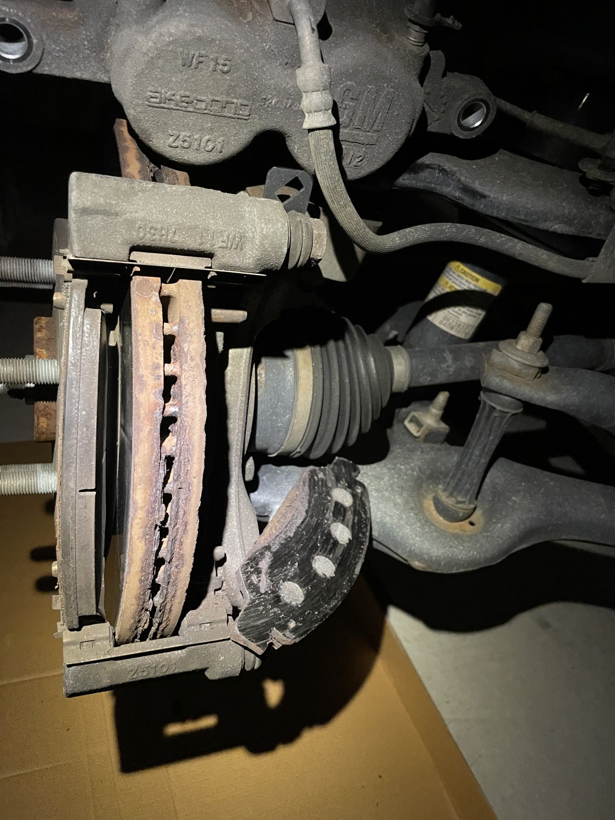

Rust does not discriminate. 3 years old 60k miles OEM components . Slide pin rusted to the bracket on this corner, other 3 rotors were just as bad.
