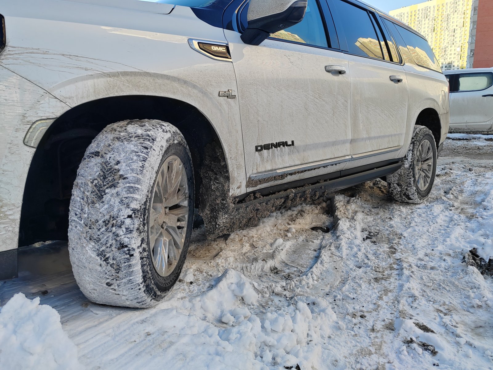

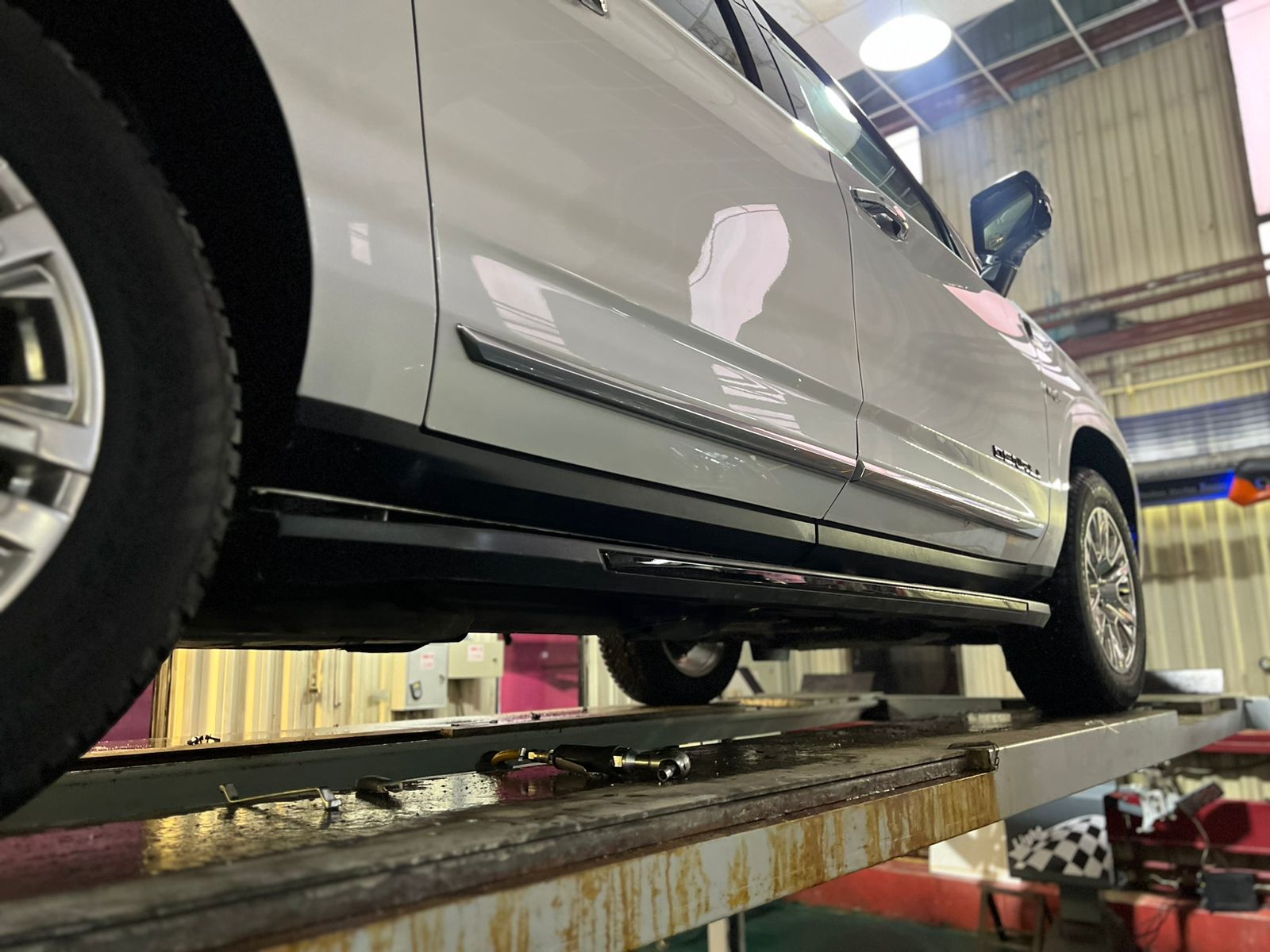

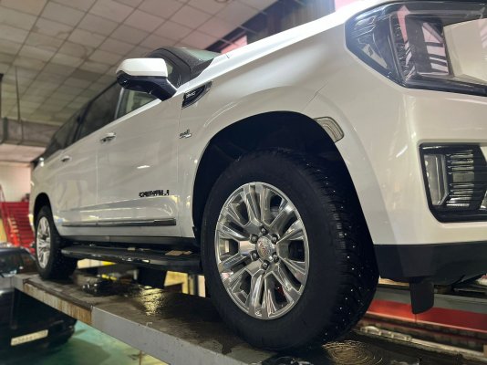

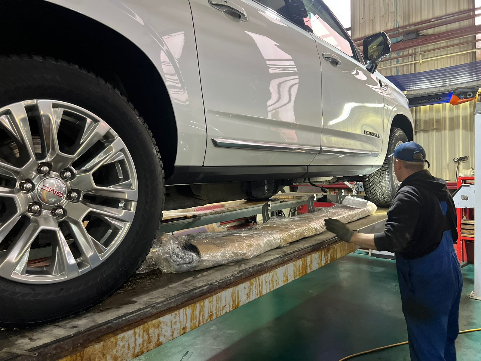

As I said above, the steps do not want to work in snow and mud conditions. I'm tired of driving with the steps disabled. And I bought myself fixed ones. Finally, I’m happy that I have rapids in winter, and I don’t have to jump into a tall car)
