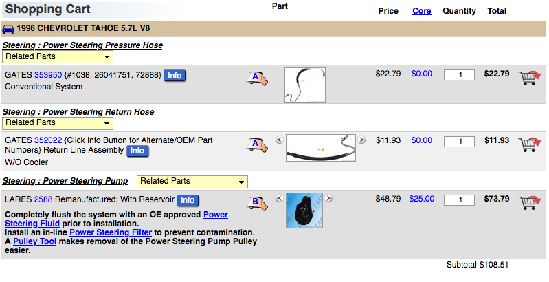

I just drove 5 miles to get some brake fluid to do my rear brakes. It's 80+ outside but steering was already getting stiff when I got home. Fluid was very hot, but no sign of air/foam in fluid.
Here's my shopping cart. Unless anyone has any better recommendations? No Delco parts available at RA.

I think you are on the right track but since you said you have had the problem for close to 2 years, since you put the new box on, I still feel there is a suspect problem there.

Flushing the fluid has definitely helped a fair amount. I think I may have had this issue to a similar degree before I got fussy after I changed the box and all the steering components. But I had let it get to the point where it was kind of dangerous to drive. Not helped by a ******, lazy mechanic.
PS pump was last replaced under factory warranty apparently for leaking in 2001. It seems acceptable for the moment but it wasn't a very hot day today. PS pump replacement is in my future, along with all the other things I'd like to do. Thanks for the help.
