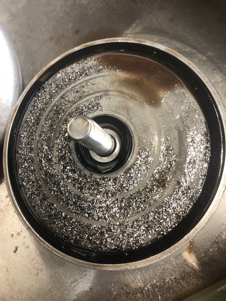

One note on milking the trans if you know it's shuddering: I did that and went from a lower cost torque converter replacement to a full trans rebuild with metal blown through my entire system because I left a shudder go too long. I'd say the price for the latter is 3x just paying for a torque converter swap and you can have a shop do the rear main seal while the trans is out. It's a doable DIY if you have the patience, tools, space and back stamina.
My torque converter that was shuddering and pushed over the edge:
