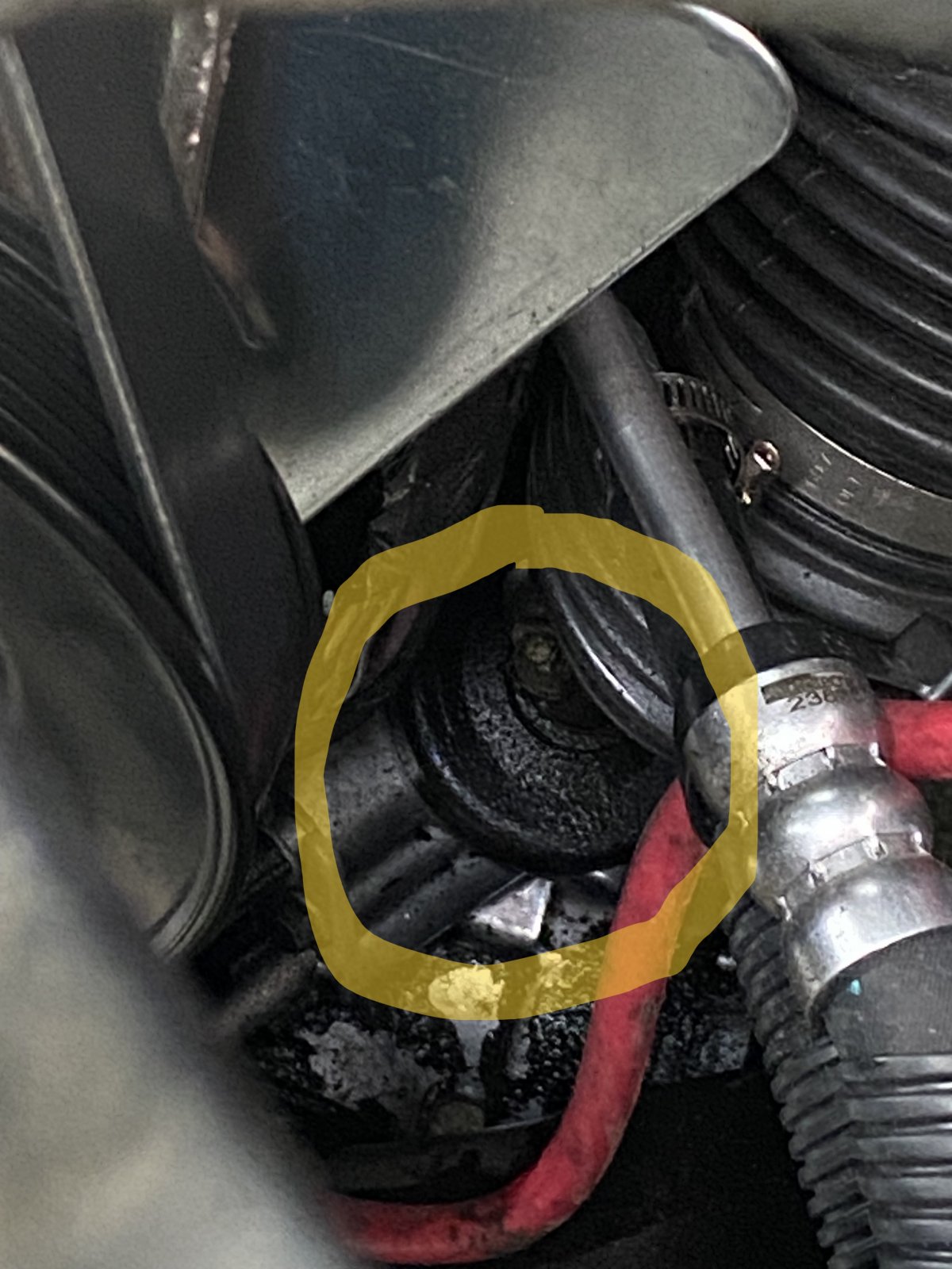

Hey guys, recently did my power steering pump and hoses, still seeing a leak. Its coming from where the shaft comes down into the rack. Am I 100% in need of a rack and pinion replacement or is this leaking seal pictured below serviceable?
Thanks
Edit: I know for a fact its not the high pressure lines

Yup, looks like the rack to me. Had the same thing happen on my '07 and I replaced it with a reman which has been fine for a few years now. But the good news is that they now make *new* replacement racks for about the same price as a reman - you can get them on Rock Auto.

It’s not uncommon for them to leak. I’m guessing you replaced the gaskets inside the rack where the hard lines connect?
If so, are you 100% sure that you got ALL of the old material out?
Also, are you 100% sure that the new seals were properly seated (usually be using an 8mm socket to set them deep enough).
Doing this ensure the lines seat properly. Most times you need to physically set the top line to prevent the plate on the bottom line from flexing while installing the hold down bolt. Make sure to use some blue loctite on that 11mm bolt.
If you don’t go with GM, take a look at Plews and Edelmann. They have top notch customer service and gear (hoses, rack and pinion, pump…etc).
I know its not the seals on the lines. I cleaned everything up and watched it piss from the round seal where shaft goes into rack... Ive just been adding fluid to be honest, can get decent mileage without draining out reservoir. Bad bad bad but gotta get to work

It’s not uncommon for some of the old seal to be left inside the rack when replacing the seals. You really need a good light and a pick to ensure you get them cleaned out. Then soak the new ones prior to install. Use a 5/16 or 8mm (maybe a 10mm) to set the new ones to depth.
Granted your rack could be totally shot, but just trying to be hopeful for you prior to throwing new parts at it.
Its to the point where now im suddenly not losing fluid but its as if I dont have power steering in certain slow parking lot turns. I gotta decide to keep this thing or not (its real beat up looking and takes in water, was in 2 wrecks, was decomissioned and probably maintained horribly) I got it for 5K a few years back at like 130K miles, and its been one thing after another pretty rapidly since. I only put 20K miles on it.
