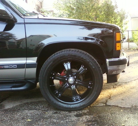

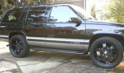

Doing great so far! Got a few nicks from mounting the tires and installing them on the truck. Can't notice much, if any road damage. Other than losing a center cap wheels are holding up. Does anyone know if you have to have 3 piece rims to powdercoat the center and lips different colors?
