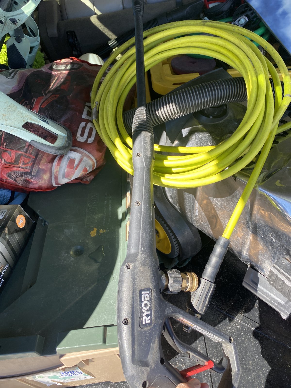

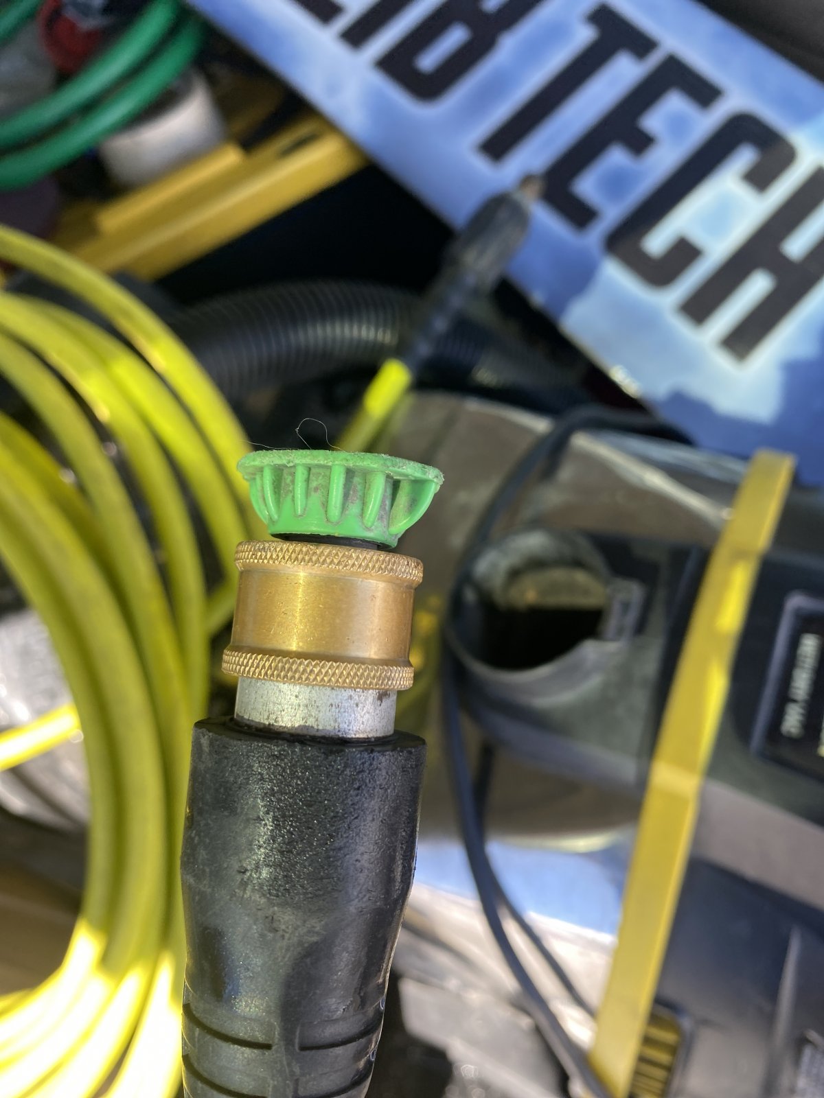

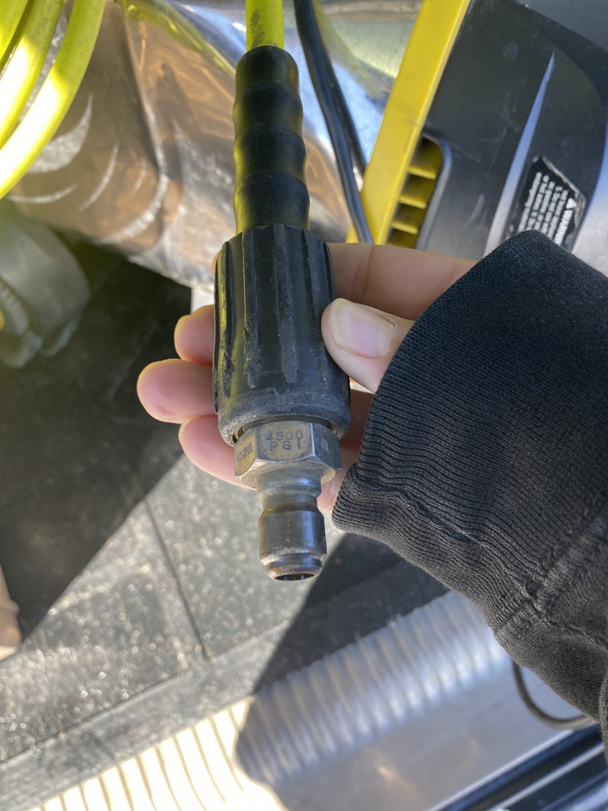

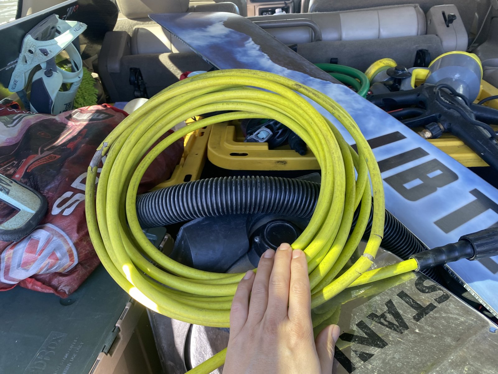

So I’ve had a few of these because of my detailing business. The solution is did was bought a ryobi pressure washer and bought M22 pressure fittings with quick release ends, and use them with the Portland pressure washer. I buy the ryobi hose one because the Portland pressure hose is way to short. I bought a 35 foot ryobi to be able to get all the way around most vehicles. And also the ryobi hose and trigger/wand combo will with any standard size pressure fittings, and most soap cannons. The M22 fitting is what portland used to connect their hose to the unit. Lowe’s and Home Depot both carry the connections. Here’s a photo of the quick connects on the hose and the trigger i use. I’ll snap pics of the connects on the pressure washer when I get home in a little bit.

@adventurenali92 AWESOME, exactly what I needed to know. Thanks! I'll go to Home Depot and pickup the parts :)
