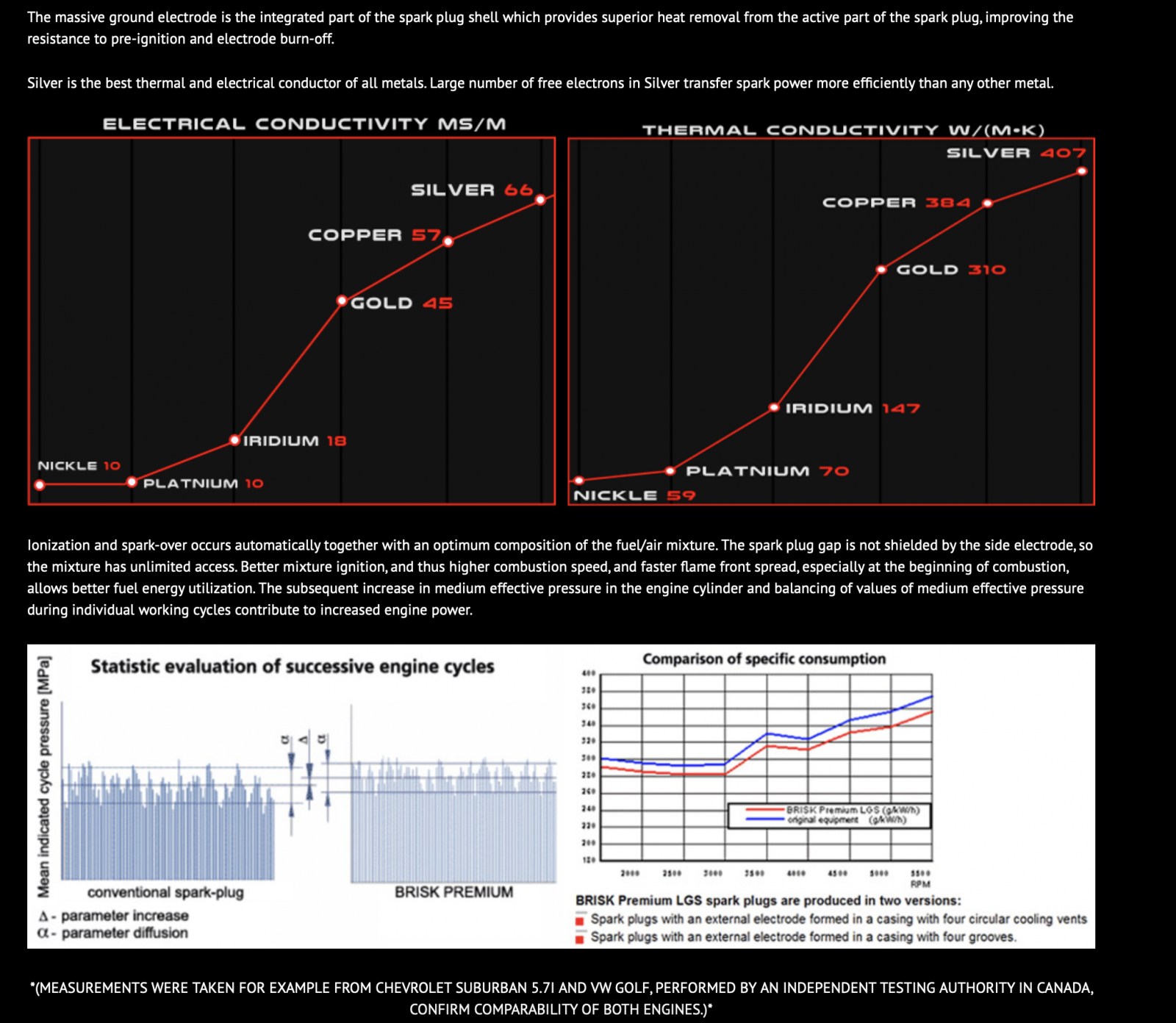

For boosted guys, Platinum and Iridium plugs perform at a lower level than copper spark plugs, because they are less conductive and they tend to overheat. However, the overall longevity of these two types of metal is better than copper plugs. In reality, copper has the best performance of all three and the worst longevity.
52,949
NGK TR6 work great for my blown 6.0 but don’t last long.
Very nice. I didn’t know that. Maybe someday.. [emoji16]
