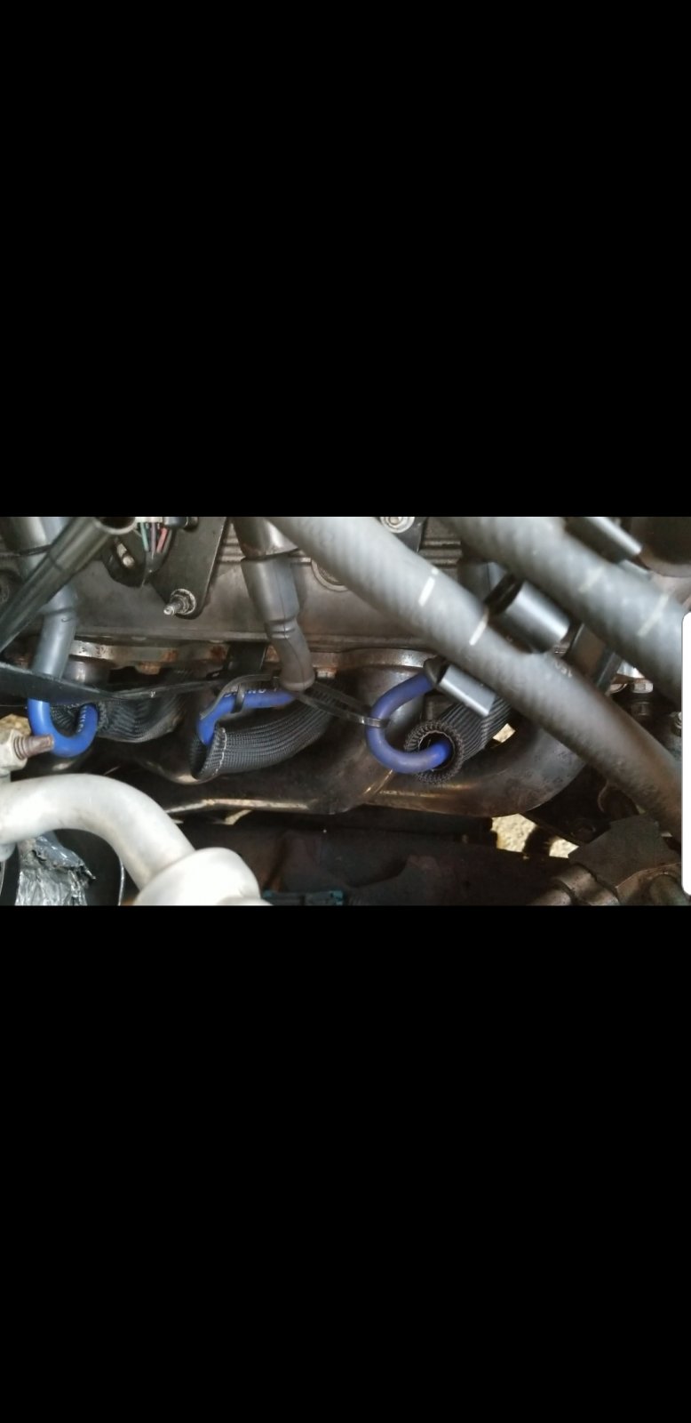

I ended up using the Taylor wires with their sleeves. So far so good.

I will take some pictures tomorrow of mine installed, so you get better idea
