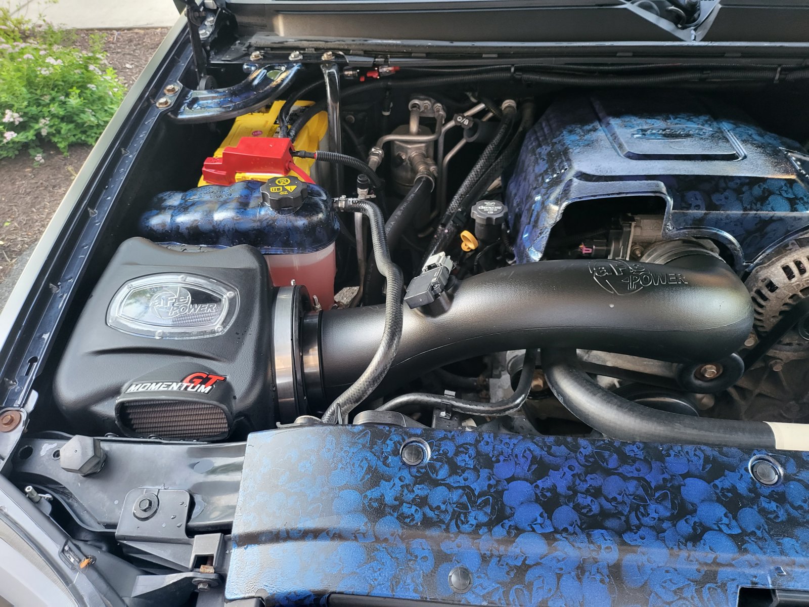

Hydro dipped some of the plastics under mine

Its a water transfer film. I get the film & activator from a company called OHW Paint. Their base color paints are also really good but I've also used regular krylon or rustoleum as a base too. Paint the product in the base color, in this case I used blue, and then you would fill a vessel large enough to fit the part in with warm water. Lay the film across the water and spray with the activator then push the part through the film & it transfers to it. The film I used in this case was a skull print. Ive also done headlights in carbon fiber, and some other trim pieces in carbon & also a flame pattern.

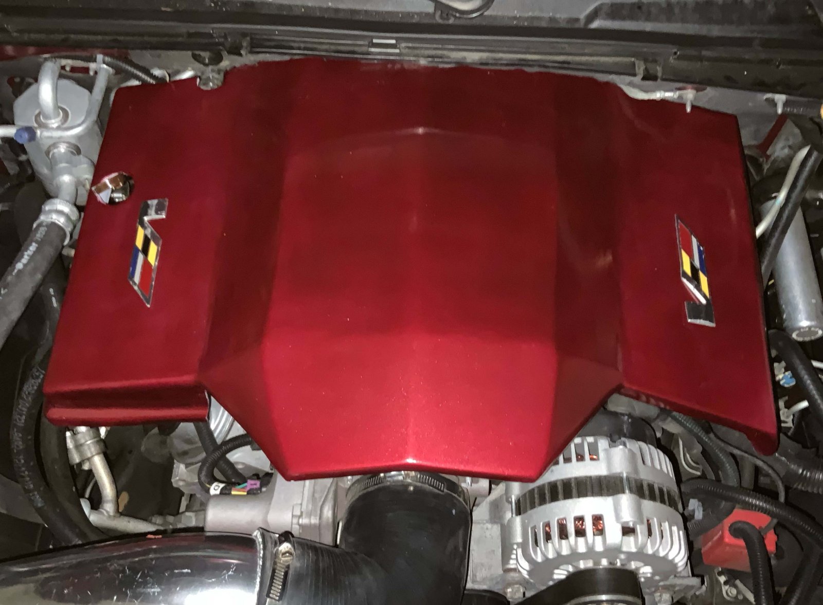

Thanks for your ideas. I really like the dipped finish. Maybe I'll give it a try. I decided to go a different route and made a new engine/fuel rail cover from fiberglass. Here's a couple of photos.
