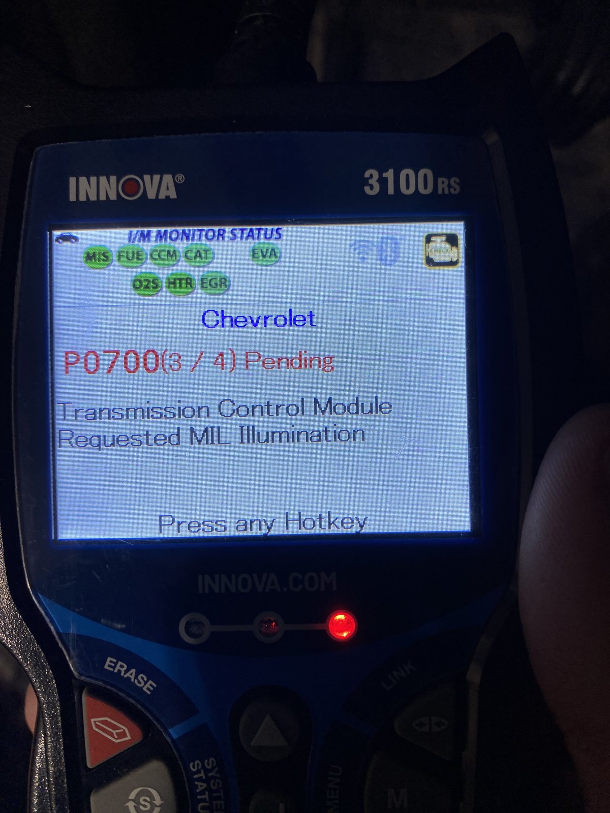

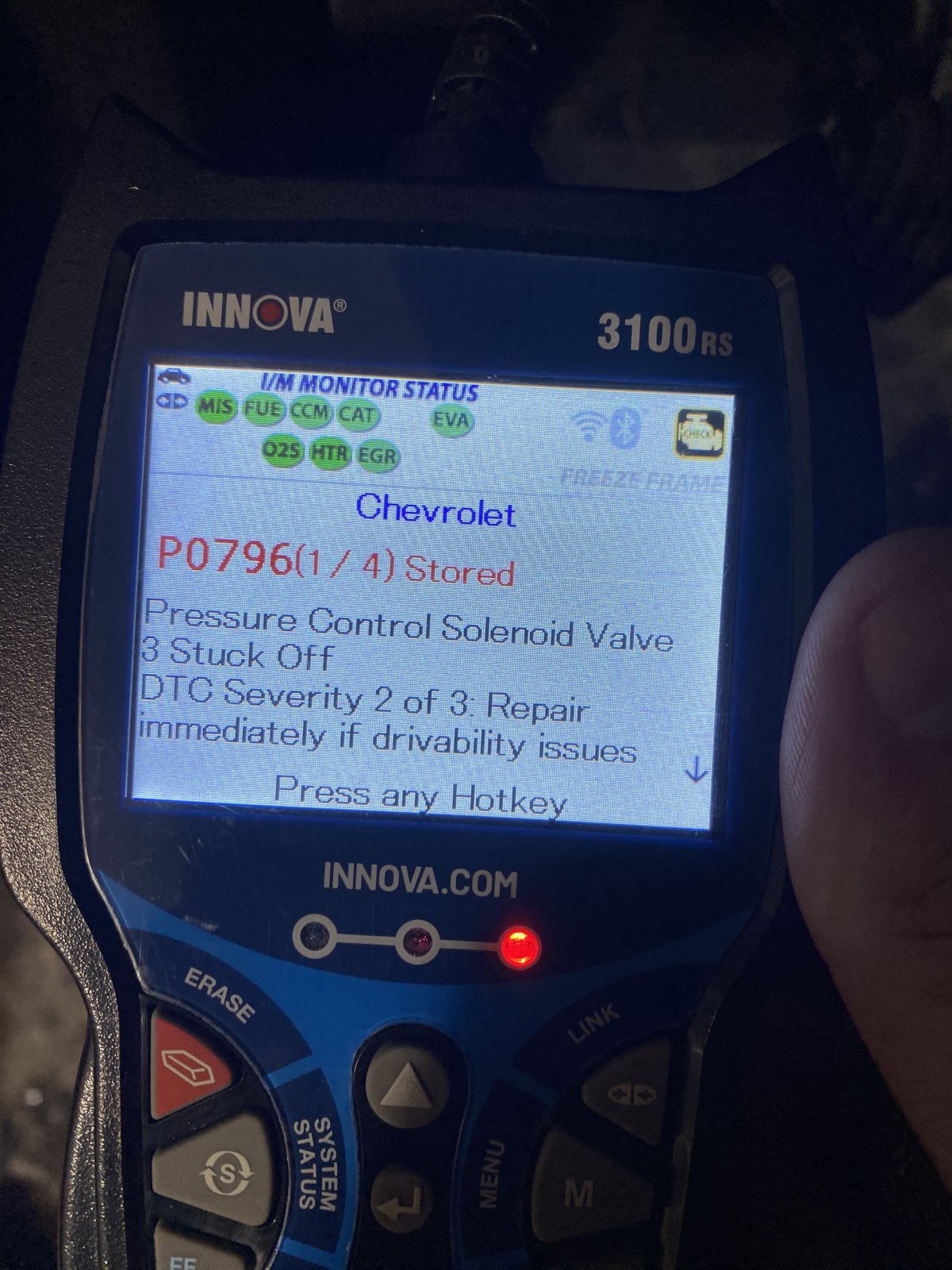

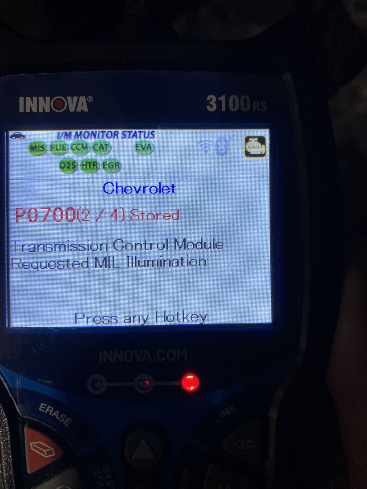

30,701
48,338
@Joseph Garcia @Doubeleive @swathdiver
I scanned it - here are the codes- now I’m freaking out
well, I would go to a LEGIT transmission shop that has worked on these transmissions and see what they think, I am no expert but in some cases the techm can be replaced if that's all it is and there is no metal found in the pan. cases like that are rare but possible. you might be looking at a rebuild though.

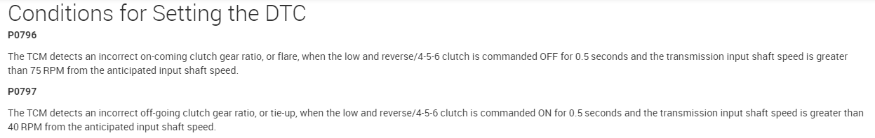

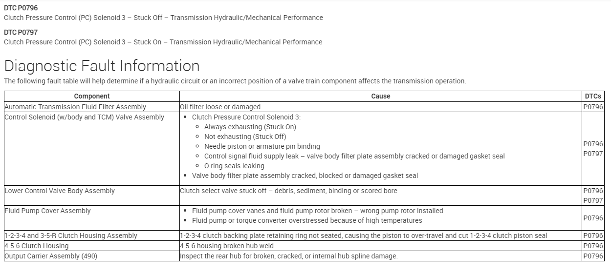

Oh boy, I'm looking at the shop manual for my 6L80... well, here's what it says:
9 out of 10 transmission shops are going to want to either rebuild the entire transmission or replace it with a remanufactured one. A new GM reman and converter will run about $5-6K installed, maybe less depending on the market and dealer and comes with a 3 year 100K mile warranty and can be serviced nationwide.
If you want to know exactly what's wrong with it, get a bi-directional scan tool on it, like a Snap-On Solus or GMs MDI with GDS software on a laptop. Otherwise, you'll get the standard, "your transmission is bad, it's need to be replaced" answer.
As you can see, you might get away with a new valve body/TECHM and torque converter.
View attachment 392240View attachment 392241View attachment 392242View attachment 392243View attachment 392244
