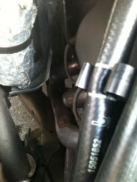

here are some pics that the mechanic took:
stock manifold:
and the headers:
i was reading on other forums that my motor mounts might be bad. i was gonna see if the engine moves a lot when revved later today when i get a chance. i know they are really expensive to replace, and i wouldnt really want to do it unless i was sure it would make the headers fit.

the steering shaft was bending when the header was on. it wasnt just sitting against it. he said that it was nearly 2" too far over to fit. i opened the hood and revved the engine and it didnt move barely at all, so i dont know if its the mounts... are there any slimmer steering shafts i could buy to fit on? is it safe to grind down the shaft?

man that sucks bro, i dont recall me having any issues with the steering shaft let me take a few pictures and try to help you out brb
***************************** edit for pics *************************************
here you go
here is the passenger side
Hope this helps you, gl hopefully everything will work out for you
