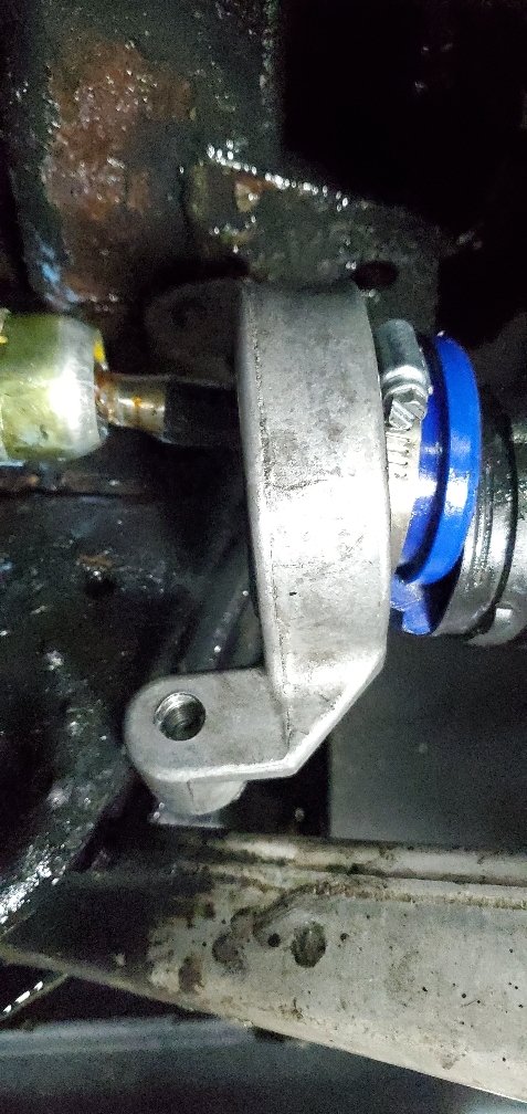

I dont agree with easy to install. I did mine last night and if your not working on a lift and have the right tools I wouldn't attempt it. The bushing goes on very very tight, I had to use a very large crow bar against the frame with a combination of wacking with a sledge to get it on. I only took one pic because I remember someone asking how to get the bushing in the bracket. It was tough i was so frustrated I even broke one of the 18mm bolts. Then the rack has to drop to put on the other bracket because the diff is in the way and even then you have to really wedge around to get it on..

I’m surprised you got it on. After an hour of cussing and hurting my hand, I gave up.

Yea, I'll take changing the motor mounts over this one any day. For the first hour I was certain it would never go on. I went and got some emery cloth and cleaned the rack as smooth as possible then gave it a go again with a 4 foot crow bar.

Did it shave off any of the material getting it on? When I noticed the pieces of the bushing being shaved off I just stopped and figured this bushing was molded slightly wrong or something. I didn't try a pry bar or anything but I did take the inner tie-rod off and tried to use a dead blow hammer but access wasn't good.

No shaving on mine I had it pretty greased up once I had it on the first nub flush I would wack the bottom of the mount with the sledge then use the crow to level out the top. So far the bushing just feels like a new bushing. I'm not sure if the headache of getting this on is worth changing a regular one every year or so. I'll update as I go. I have changed my rack several times over the years so this is just another trial and error.

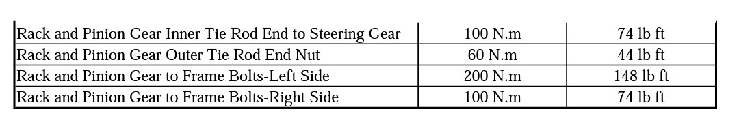

BTW I'm not sure if I mentioned but I snapped one of the 18mm bolts and spent a long time getting it out. Anyone know the torque specs for these bolts?
