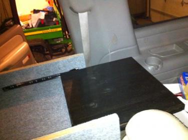

Some pics from the weekend project- not quite finished, waiting on some parts...

So i've added rear cargo door Xenon lights, a Xantrex battery monitor, a West Marine 6 place switch, and just finished the third seat desk. I've also gotten mobile Internet which i'm using now. I think i'm almost ready for a Yosemite weekend.

Thinking i'm going to change the battery shelf...
As it is now, it supports 100 lbs which means I have to shim it up in the center to support the 160 lbs. I'm looking for some 200lb drawer supports, any suggestions?
