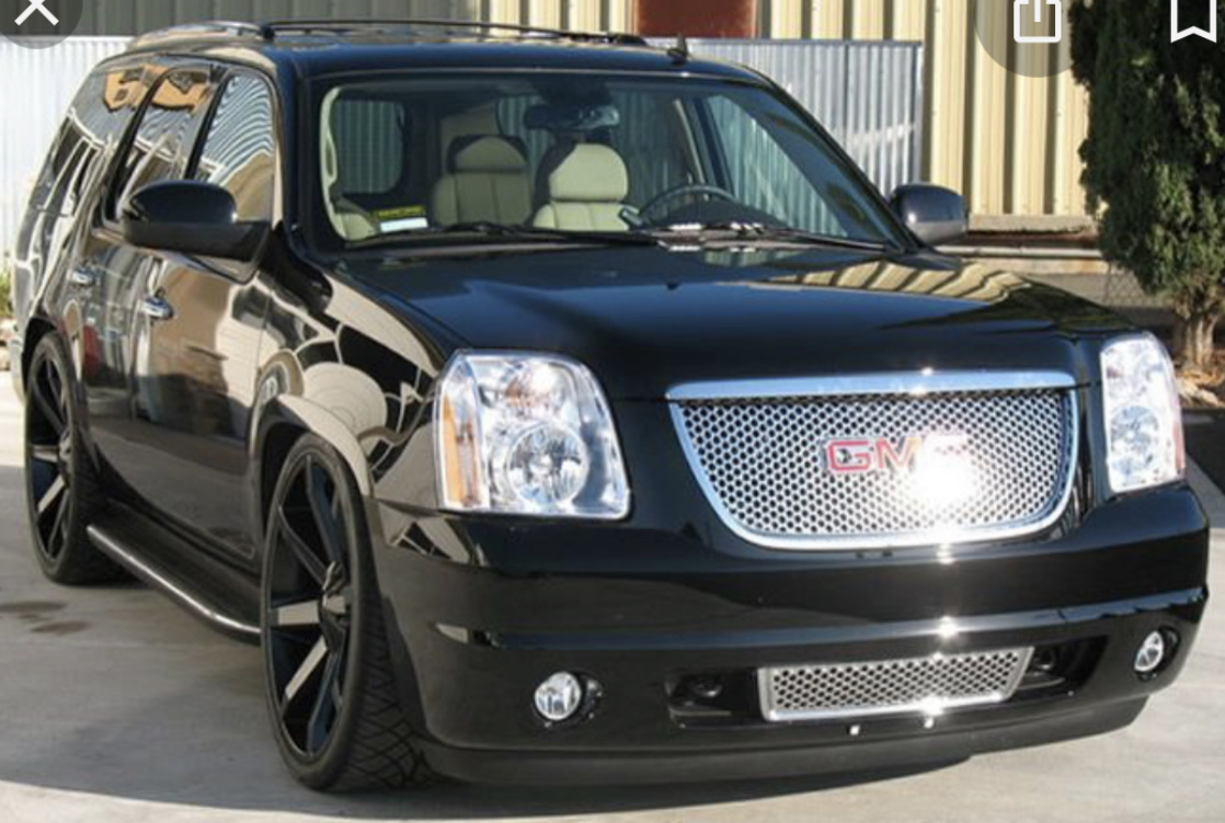

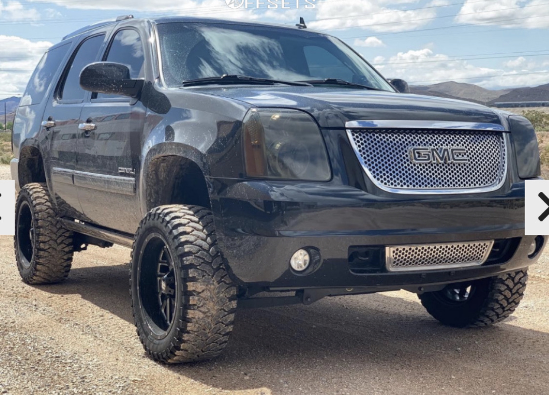

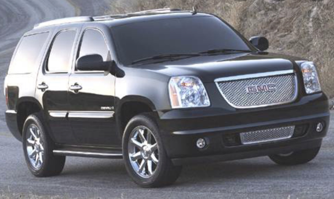

Use the poll to vote for the Yukon you’d prefer to drive. I’ll be interested to see what everyone chooses!
A:
B:
C:

For me it's a toss up between B and C. I do like them both. Trying to decide what way you wanna go with yours?
Yeah...I think my head is going to explode trying to decide which route to go! Haha! I just realized if I take the roof rack off and take my suspension spacers out I can go with a 6” lift and 33’s (which is the same as C) and still fit it in the garage. I’m really digging B as well (although wouldn’t go that low to keep the install simple).

C if it's a 4x4 but not a drop bracket lift because they are cheesy and I'm lactose intolerant.
What lift do you recommend for 2007 Yukon without autoride? I do plan on taking it off road, so articulation would be nice. Max lift height I can go is 6” with 33” tires. Would you piece together your own suspension parts or go with a complete kit?
I don't know a ton about the NNBS trucks but a basic mid-travel setup is a good go-to for under 4" of lift. Mid travel typically consists of a better designed UCA built to keep alignments in spec still. Then a good quality coilover or lift strut, it doesn't have to be King or Fox. I just did this exact setup on my Tacoma and used Bilstein 5100 struts with a lift spring specced to give 3" of lift but ride better than stock and coupled with a Camburg UCA it has way more down travel.
Just find a decent UCA and then coilovers of your choice.
Atomic fab and performance has a coilover swap kit for the NNBS trucks so that would be my suggestion on coilovers.
The rear is typically pretty easy on these trucks, a taller coil spring or spacer and longer shocks of your choice.
All this might require longer brake lines which are always a good idea and of course an alignment.
