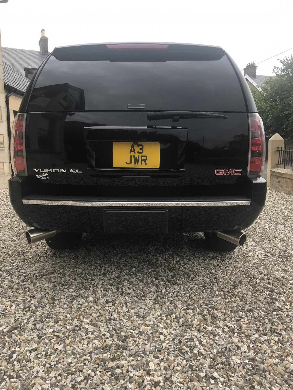

Hello,
I have been having a hard time deciding what exhaust i want to get from my 09 Yukon. I Google search Yukon/Tahoe Dual Exhaust and other than pics of exhaust kits i don't seem to get a lot of hits. I do not want to be a lot louder than stock and i don't want any drone but i really want dual exhaust at an angle out both sides behind the rear tires. I was wondering if people could post pics of there exhaust set up. A local exhaust shop said it would be around $380 in stalled for cat-back full stainless. I saw Gibson has a kit but i have a coworker who has the single exit and after only one year it is rusting pretty bad even tho is stainless so im staying away from them. I also don't like that stock is 2.75 and the Gibson goes down to 2 1/4 piping.
So please post some pics to give me ideas.

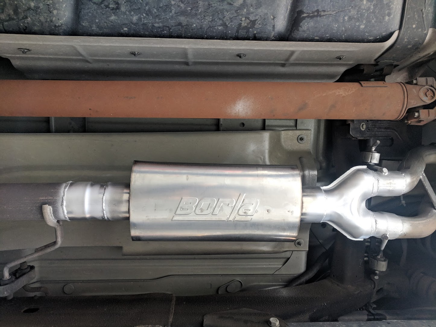

the stock piping on the 6.2l is 3.5 or larger in some parts, not sure if they are routed the same. I put on a borla with 3.5 in and 3.5 out, there was really no point in trying to do a full cat back that would be the same size anyway. it's kind of passive/aggressive if I am on the pedal you can hear it but I can't say it has any annoying drone, then again I have ran modified exhaust for the last 20+ years so I could just be used to it.

mine isn't overly loud, I can hear it when accelerating but it smooths out pretty quiet when just cruising, I really couldn't comment on changing the pipe size I only added the Borla and took off the rear resonator, my 03 5.3 silverado has 3" pipe catback no resonators and it is noticeably louder than my Denali

borla 40946, 3.5 in & out straight-thru, the muffler shop just made me a y pipe for the dual exhaust

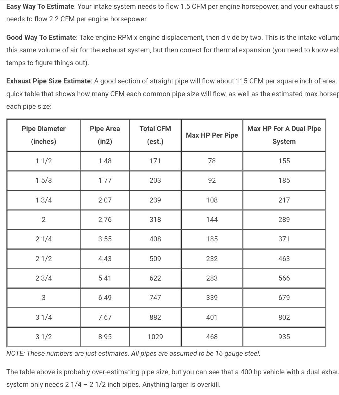

This was precisely my worry! Maybe you have better knowledge on my earlier question? I asked @Doubeleive.
Bigger is not always better... you will lose a lot of bottom end torque by going too big with the pipe. You certainly don't need anywhere near 4" pipe.
Check this out...

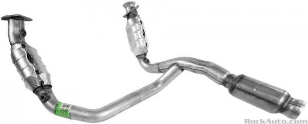

A stock 6.2L puts out a rated 403 HP.... 2 1/2" pipe is plenty big for the Y-pipes.
When I installed my shorty headers and removed the cats I lost a noticeable amount of bottom end... I went back to the exhaust shop and had them build me a new Y-pipe out of 2 1/4" pipe, dropping down from the 2 1/2" Y-pipe from the factory... this restored my bottom end... I also got rid of that awful factory Y-pipe junction that was mentioned earlier and ran the Y-pipe back a little further than before.
