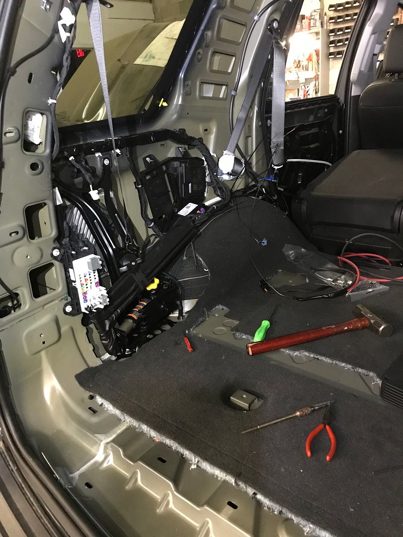

Hey, good people. Does anyone have pics of the areas behind the cargo area side panels? Trying not to have to remove mine just for a recon mission. I’ve searched here and the googles and came up blank. Or if I’m blind and missed them someplace please feel free to redirect me.

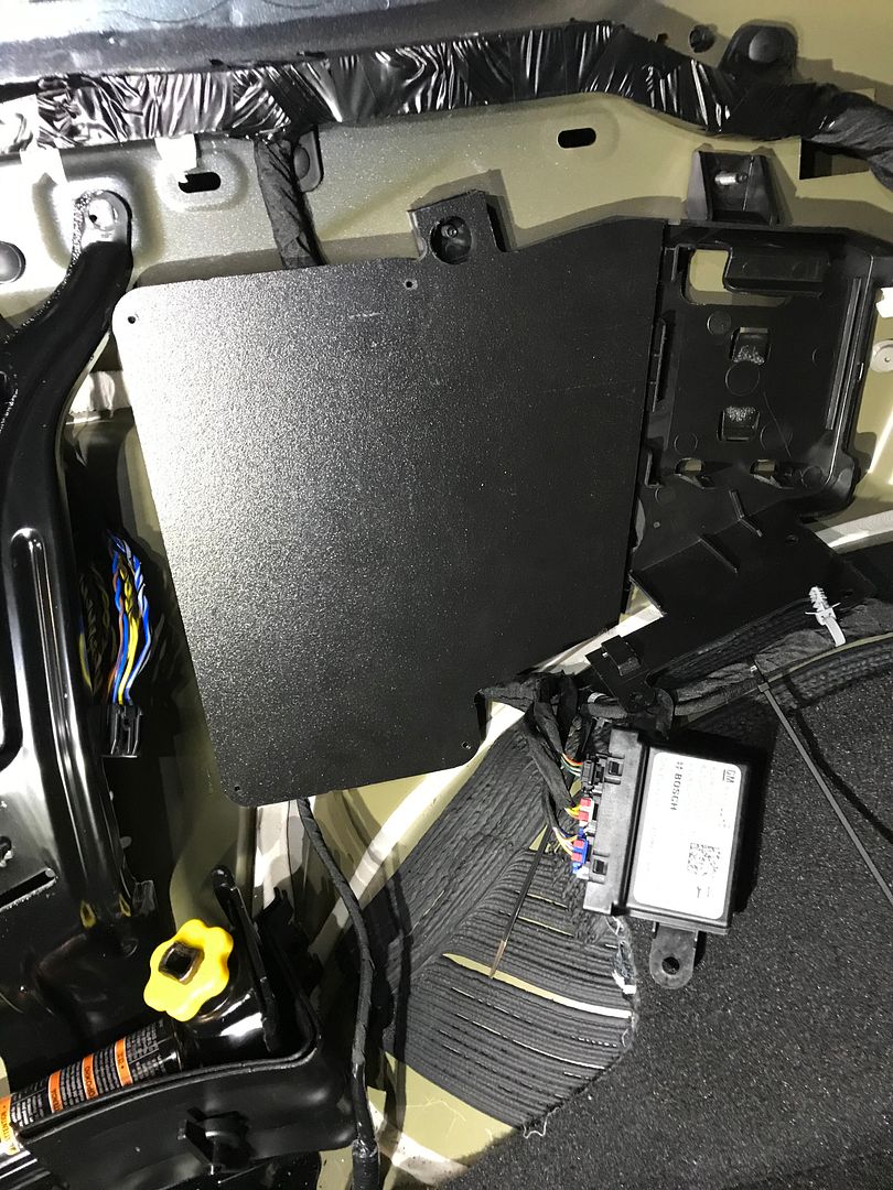

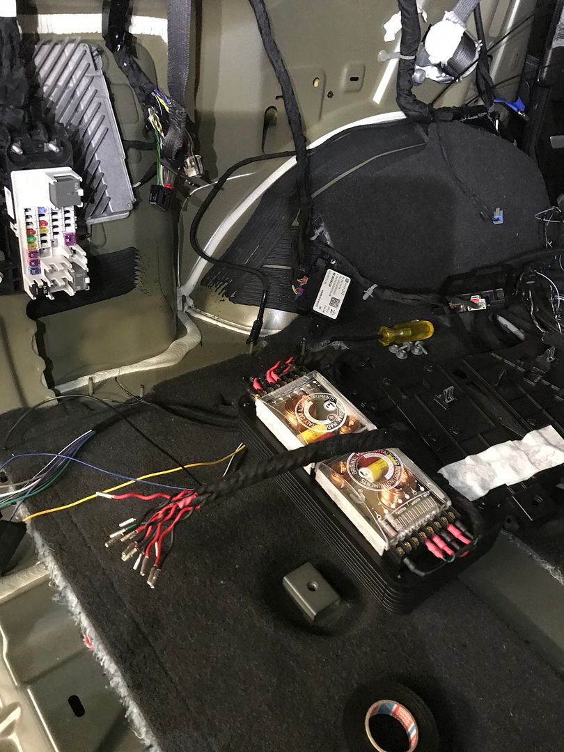

I have pics of the whole interior taken apart on my 2019 callaway tahoe when we put sound deadening material thru out, the drives side panel is where the jack is, and I put two amps in that area, the other side is where the rear AC is located. I planned to put a sub back there but after hearing the JL in the stock Bose under the center console that is the direction I went and cound not be happier. I will try to locate the pics they maybe on my cell

Thank you @hcvone - that’s exactly what I’m looking for. I’m looking at the stealth box too and want those locations for a couple of amps and want to get a feel for the available space on both sides. Much appreciated.

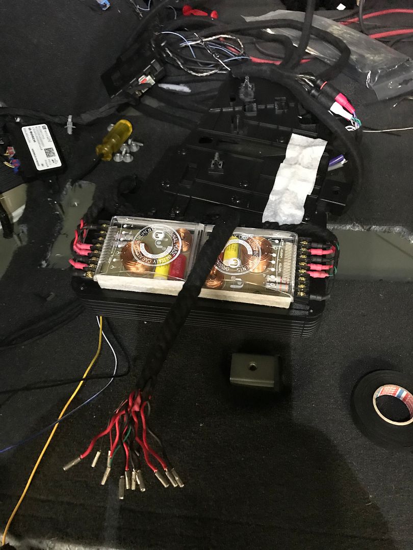

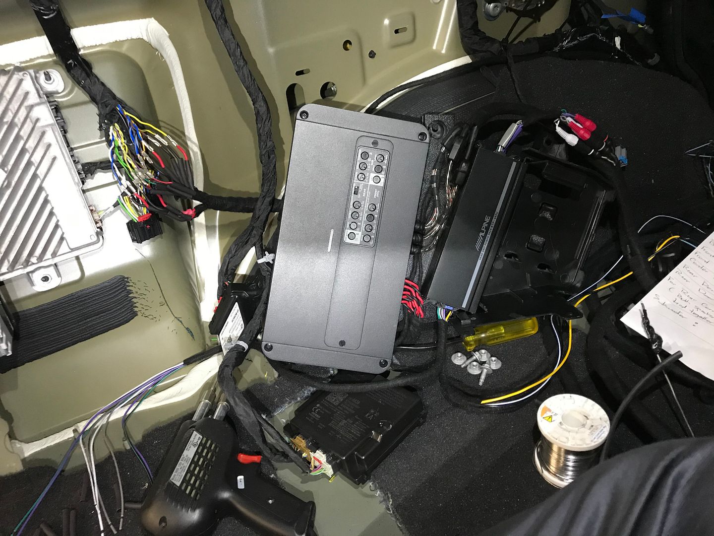

There are more, these are drivers side, nothing was put on the passenger side, but somewhere there are pics when we put the sound deadening in

Thank you! These are great. I’m not doing anything serious back there just want a clean location for a couple of larger mini-amps and might put the sound processor in there too. Looks like plenty of room back there.
Appreciate the pics. If you come across any more, please do share!
