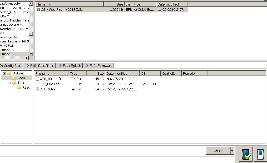

i don't know what I am doing wrong, I have the autocal v2, using efi v8
when I play the last log file I just did (again!) when I load it only plays for about 7 seconds.
this recent file only shows 39kb, shouldn't it be like 1.5mb or something?
the autocal shows it has 4mb free out of 6mb

It should be bigger but the older style AutoCal will have the log files open in the V7.5 Scan program. If you want to call our phone line, we can go over it with you and even remote into your computer to see what may be going on.

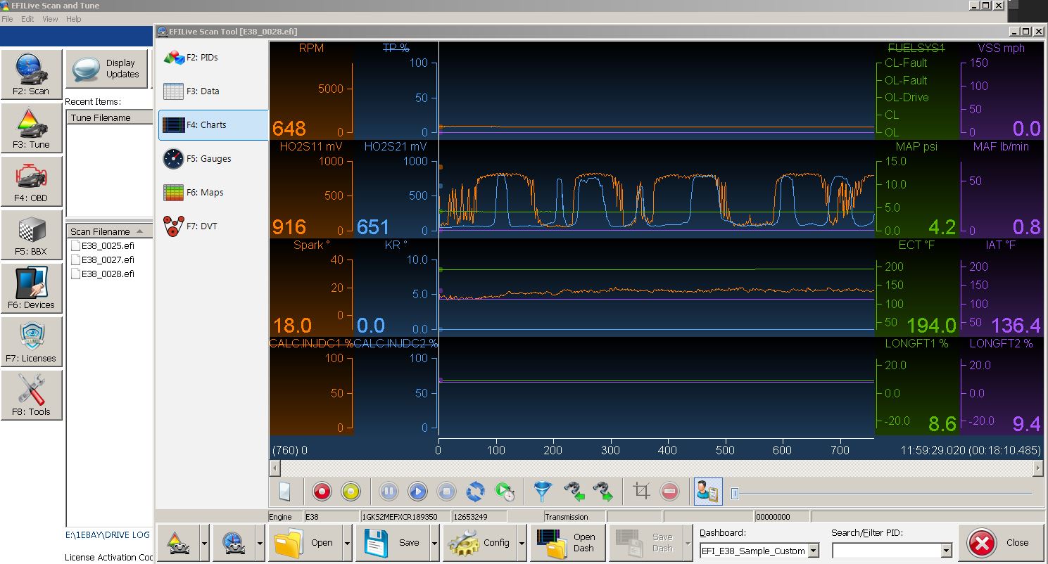

i gave up trying to just save it with the autocal and connected my tablet and just did a passthru log with efi
I sent 2 files, they will be from wesley.finch
hopefully I did it right this time
30,698
48,334
and that was set on engine: e38 which I am not sure if it will show all 4 02 sensors?
if not, let me know which one I need to use and I will do it again
