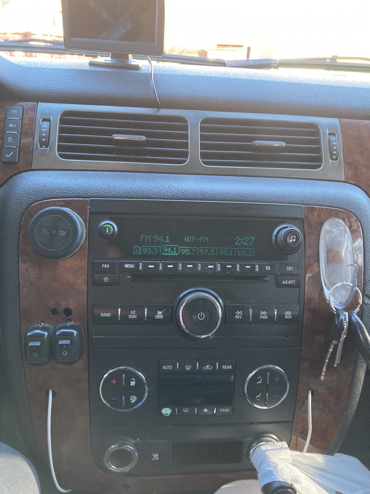

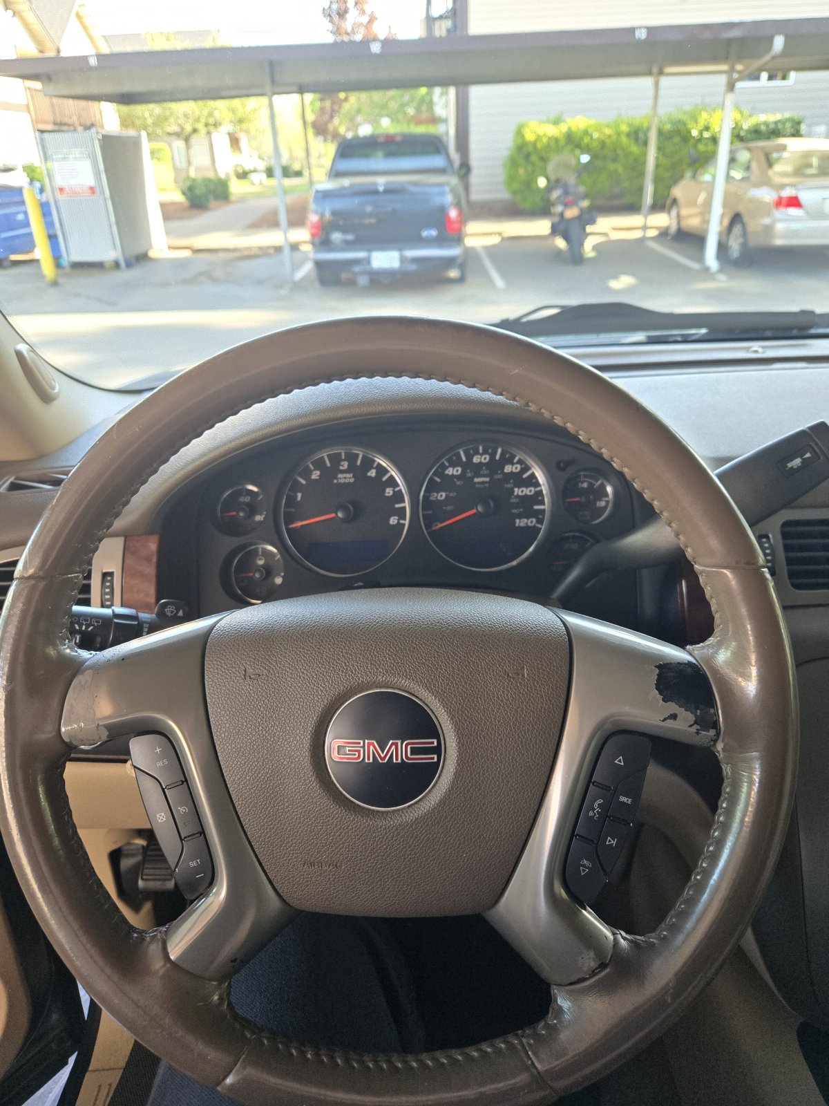

Hey all,
I've had my 2010 Yukon for over a year now and I still can't decide where to put my phone mount. I've got the suction cup style which I've put on the dash in previous cars. I just don't really want to this time because it tends to damage the dash. I'm getting close to saying screw it, though, because I just need it mounted. Can anyone share where they put theirs or, even better, show a pic?
I've considered just to the left or right of the hump over the gauge cluster, low on the A-pillar, or even mounting it low with the arm reaching up.
Thanks in advance for the input!

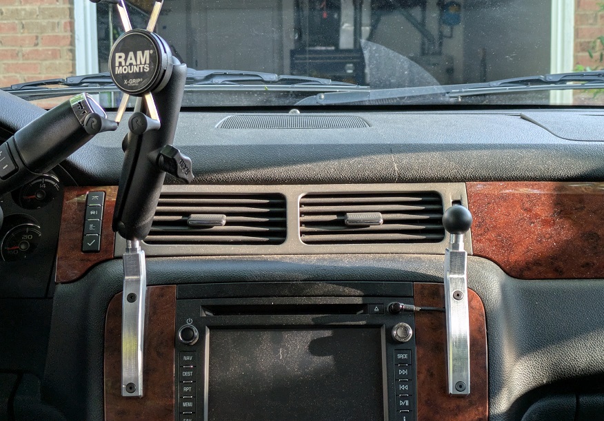

I am going to do a full(er) writeup in its own thread when I'm done with my setup, but for now here it is. I fabricated a couple of brackets using my hobby-size CNC machine to hold my phone and tablet. In short, these mount through clearance holes in the trim piece and are fastened to the structure via plastic-specific rivet nuts from McMaster-Carr. The angles might look a bit wonky due to the lens, but they're parallel to the sides of the radio/HVAC (not to each other) and are perpendicular to the trim face. I'll be adding a bar between them (due to the tablet vibrating, but will also keep sun off the display) and painting them black (SEM 39143). The top of the phone is below my line of sight and the shift lever moves around the phone without any interference (Pixel 7A, ~6"x3").

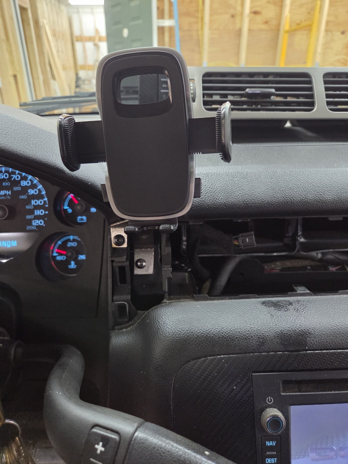

I'm working on a metal bracket that will attach behind the trim piece that contains the vents, stick through the upper seam above the DIC and left-most vent, and allow the phone to sit above it. Ideally it will be entirely above that vent, and entirely below my line of sight to the bottom of the windshield. The bracket is not simple. And my fabrication skills aren't very good. So it's slow going.
I think it's going to work. I got it mocked up tonight. It still needs some minor cleanup on the edges and paint. Teaser photo...

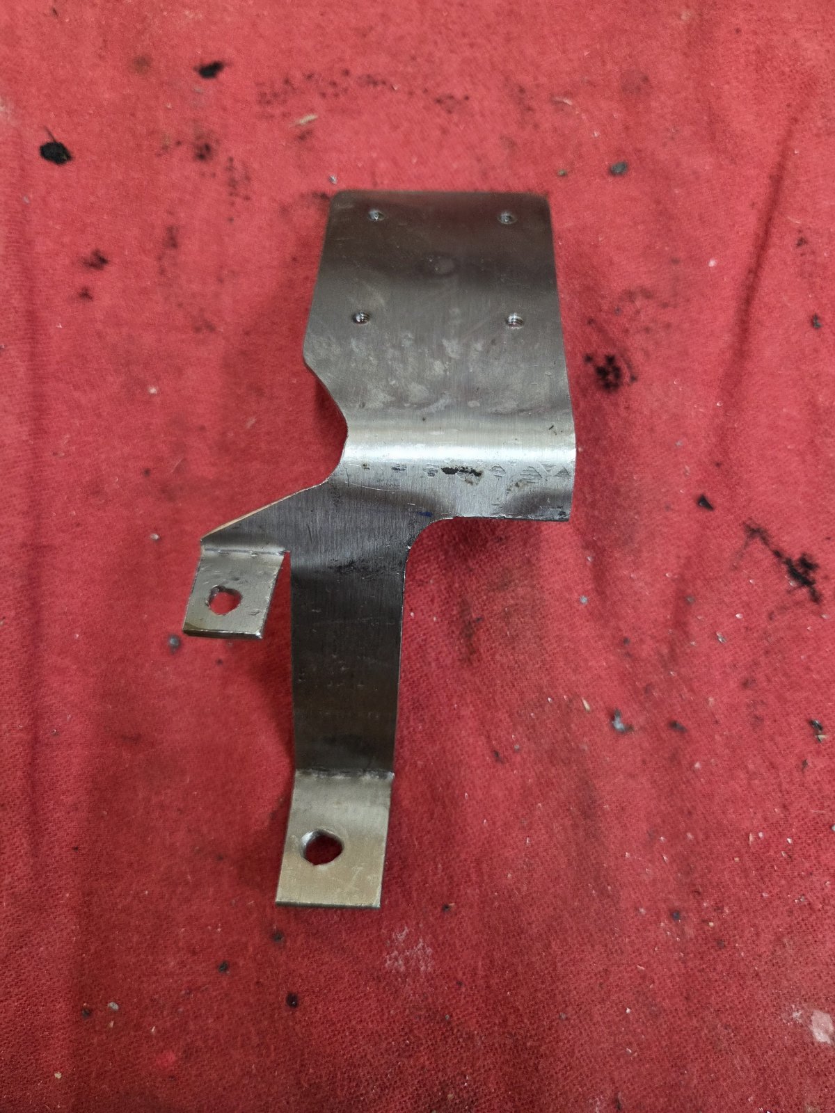

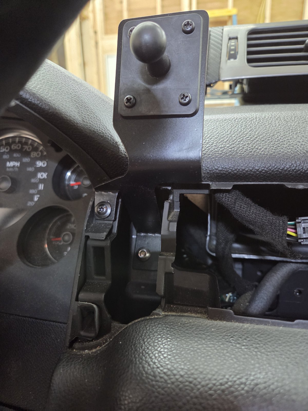

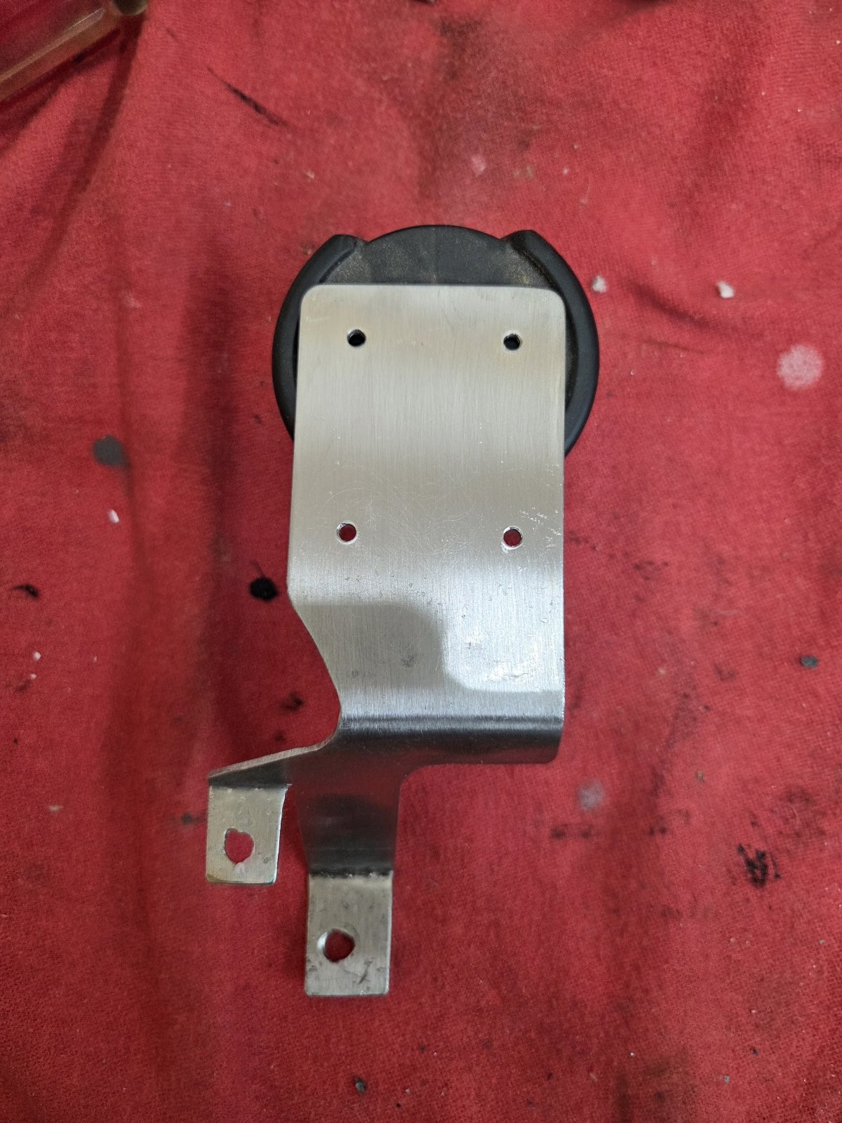

All done.
Here's what I ended up with:

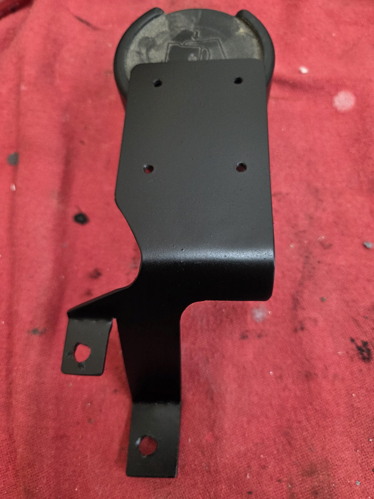

It's made from 14 gauge stainless steel I had left over from another project. I used CAD (Cardboard Aided Design) to work out the shape. It grabs one of the dash mounting holes and an unused hole back inside the dash structure.
Prepped for paint:
Painted:

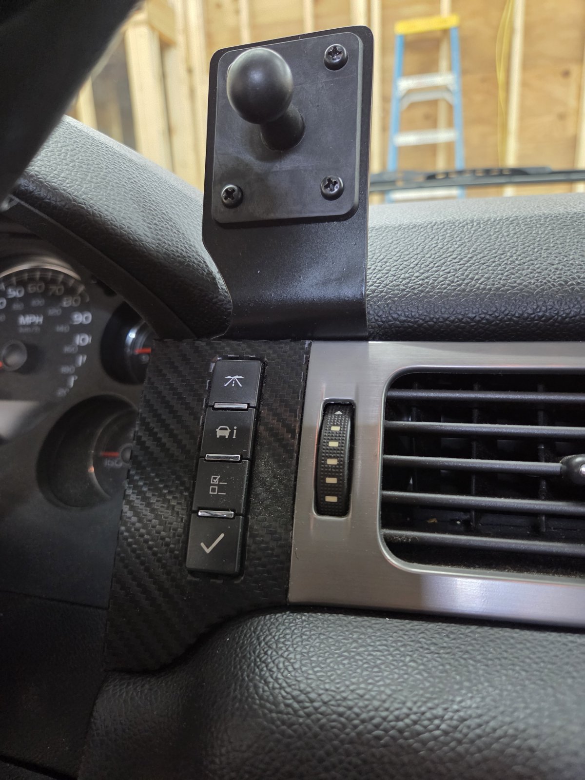

Mounted in dash with 17mm ball mount attached:
Trim installed:
Driver's view. It's exactly where I want it. Above the DIC and vent. Below the windshield. The ball mount and phone cradle are Chiwanese Amazon items that together cost about $35. The cradle even has matte silver and carbon fiber highlights to match my interior.
So far, I'm happy with it. When the shifter is in Park, it blocks the screen. But it's clear when driving, which is more important. It does vibrate a little when in Park. But in use driving around it seems to be solid enough. Time will tell.
