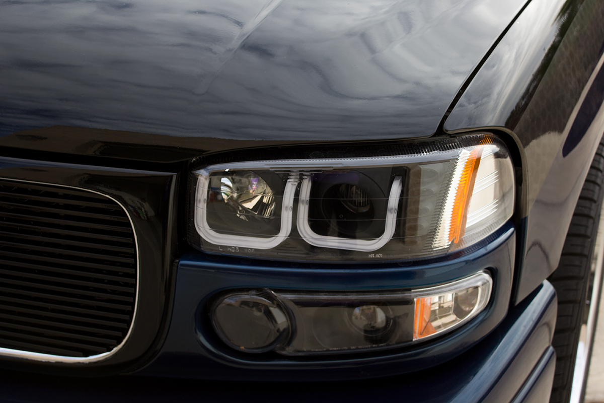

nothing big. just minor details.
and of course, i had a few beers just staring at this gappy GMT800 platform. Big ol gaps everywhere and then i notice the top of the headlight light colored plastic always showing through where everything is dark.
so i just taped that edge off. degreased,scuffed and sprayed it.
better
Ha , i had the same idea for mine. Can't stand the borders on these lights on our trucks. Nice touch!
