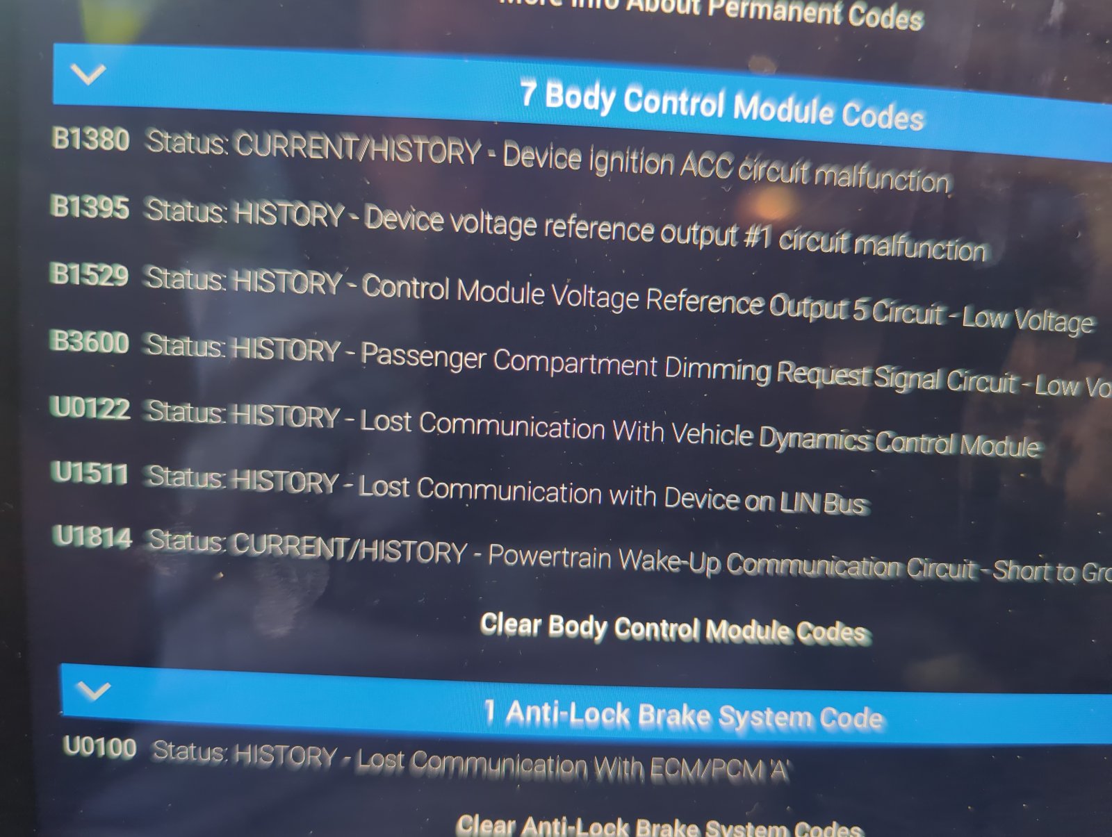

Ran the blue driver OBD2.
G
giroux68
Feb 12, 2017
11
I did try the BCM fuse pull tech. I found on YouTube. So these might be from swapping fuses.
