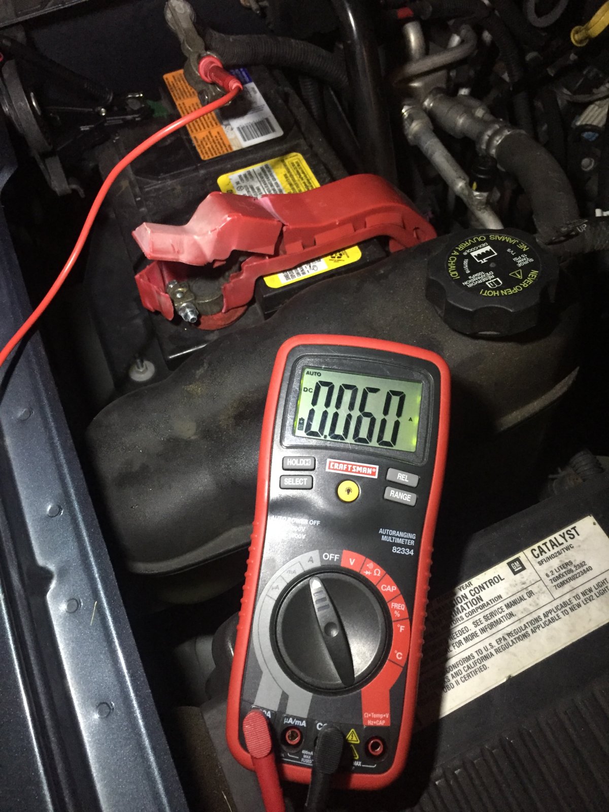

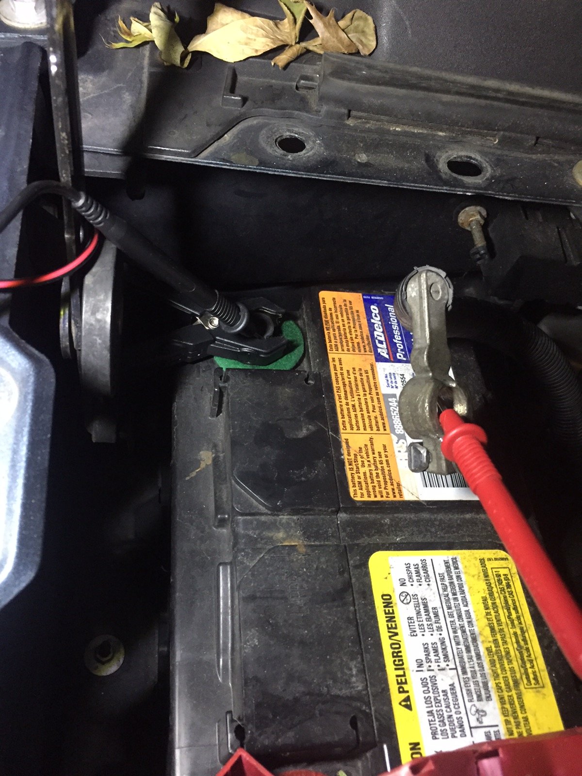

Well that was a hoot. Instead of holding the leads with my hands, I decided to clamp down the negative terminal and place into the negative cable. I must have made a much nicer connection because it didn't start the alarm.
4.5A pops up as usual and within 30 seconds the amps dropped significantly. After a few minutes, it bounced around 0.050 and 0.062
So I guess I don't have a parasitic draw.

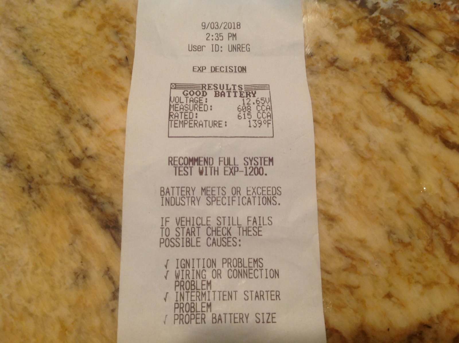

Battery testers vary a lot. Some use a small DC pulse to check resistance and extrapolate from there. Others put a large load on the battery and measure directly. The former can give a lot of false info.
Measured at the battery, what's your charge voltage? Battery voltage after just shutting off the car? And battery voltage after sitting for an hour? What's battery voltage when you attempt to crank it?
When you jump it, where are you attaching the leads?

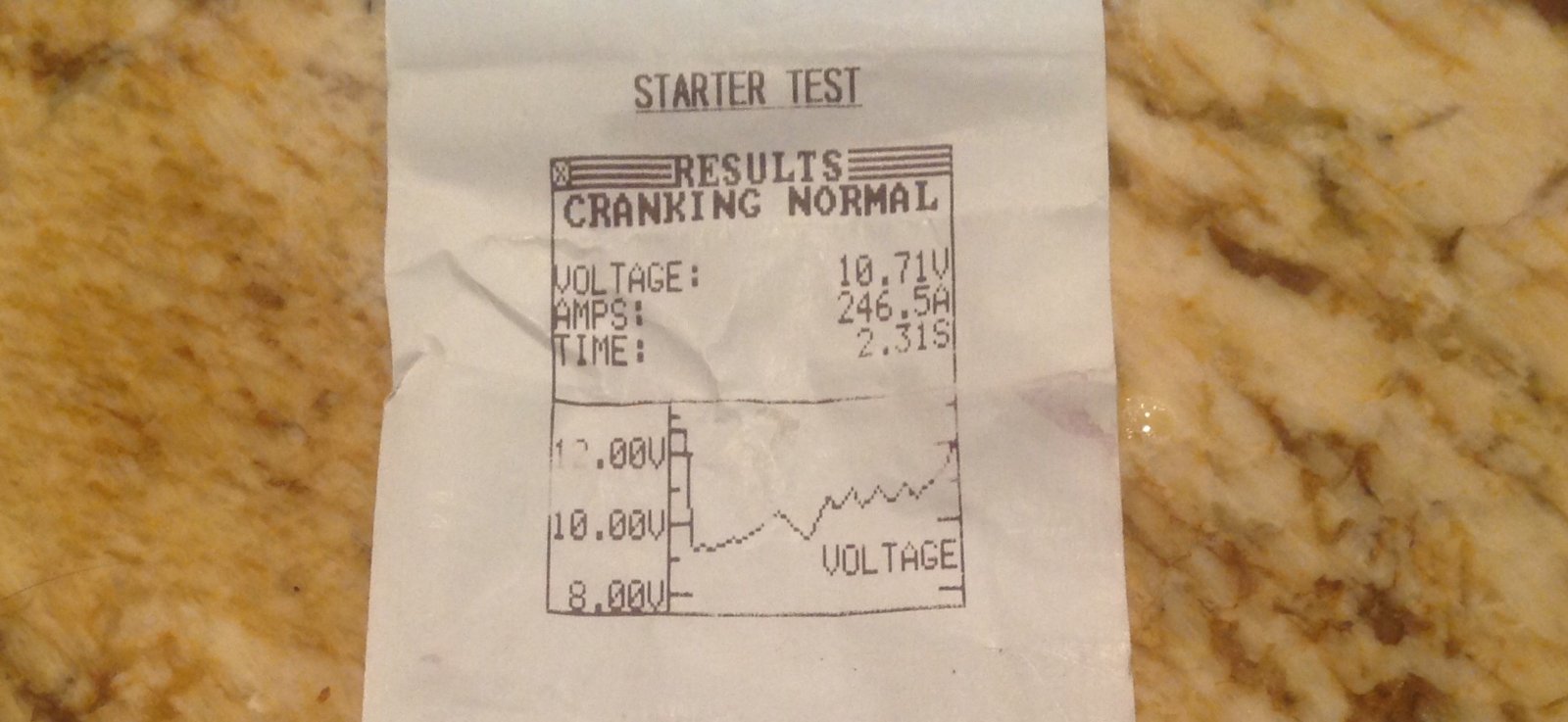

When jumping I use a jump pack (great purchase, saved me lots of headaches). I connect the positive direct to the positive terminal and the negative to the bolt coming off the block
I haven't measured battery, but here is what Advance Auto printed out for me
