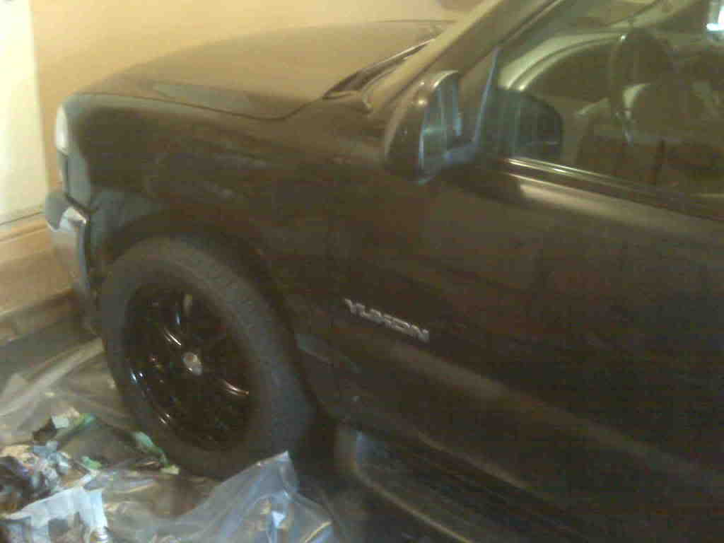

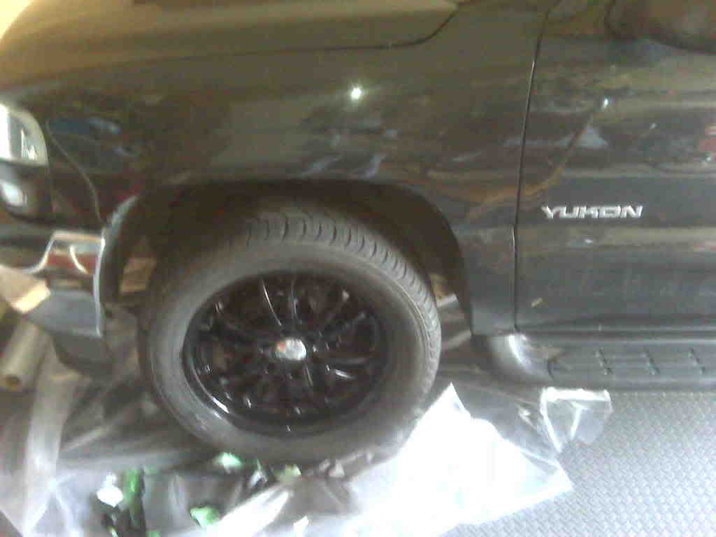

so i finally got around to painting my rim, yes i only did one, i want to see how well it holds up, because if it does not then i am going to powder coat.
what they look like normally
and what the painted one looks like
i love it, sorry lol, camera phone pics

Yours looks much better now.

thx, ya i love it, only thing is i work 6 on 3 off and im not off again till next friday and i dont think i can wait that long to do the other 3 rims, i cant decide if i like the chrome centre cap or if i should go black, i masked it off and when it was covered in tape and solid black it was pretty kool

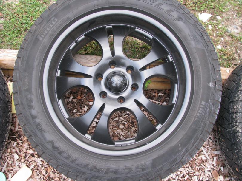

Heres mine with black cap i had chrome too then changed i like it better all black.

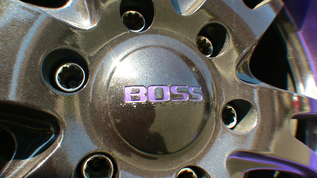

looks good!! I remember when I did the new purple on mine I used a black primer and it looked SICK!!
definitely do the center cap and like clean95 said they pop out just do light coats though because its so rounded it will just run

i like the way you did yours kasey, i am actually doing them right now and should be done tomorrow and i will post pics, as for the process i degreased and dewaxed with cleaner, then sanded with 400 grit, then cleaned again, then adhesive promoter, then self etching primer, then primer, then paint then clear. i think they look good, i popped out the centre caps and left chrome for now, but i think i might try and paint the boss black to match
