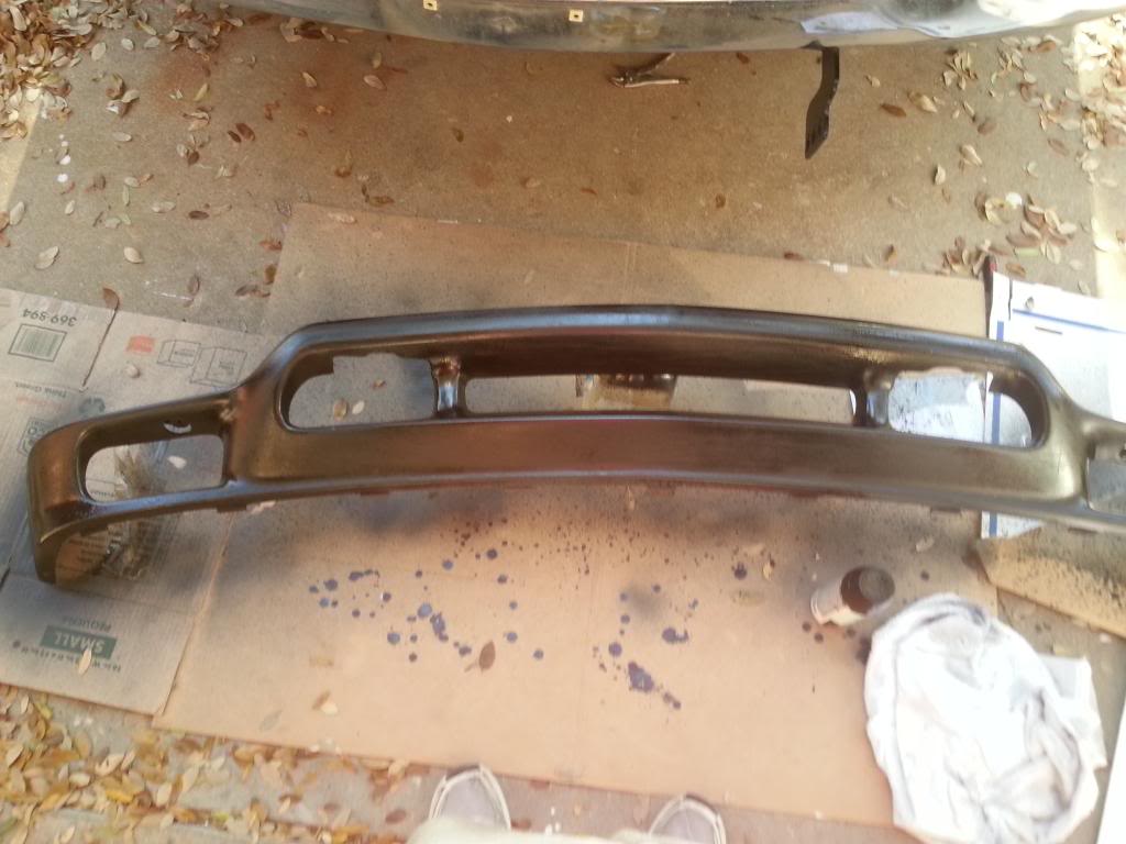

80% through painting, still wet:

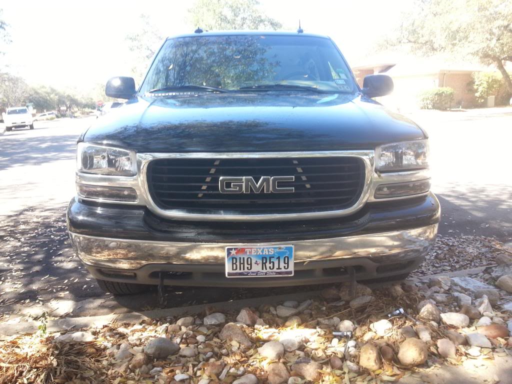

10 hours later, drove 100 miles, 4 hours later drove another 100 miles:
Can't see the valance too well in those last ones, sorry. Will get it out to a parking lot for some real pictures this weekend perhaps, after a much needed wash n wax.

Started sanding with some low grain stuff, but as you can see in some parts, it scuffed it through the rough, or rather the material, a bit more than it should. Switched to 200, which worked it a bit better. To anyone doing it, I suggest starting at 200, or perhaps an even higher grain. Painted the valance with rattle canned black Krylon Fusion. Perhaps I had a bad can, but even after attempting declogs and shaking like I couldn't shake no more, it still didn't aerosol like the Rustoleum. However, it was fine enough that after a few coats it was looking good. I wasn't very systematic about it, just horizontal sweeps followed by vertical and then repeat, then went over areas that needed more. It's simple paint. Let it out to dry for a few hours, put it on in the evening after a late dinner. No issues, dried fast.

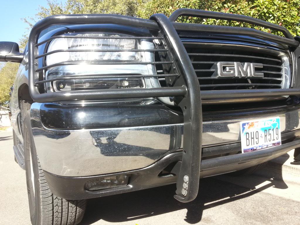

Sanded the grille guard with 50 grain in some spots that had stickers, rips in the powder coat, and rust, as well as an impact site or two or three ANYWAY then covered the whole thing in 200, which for some reason seemed perfect. Sanded because I didn't strip the powder coat because I don't even know how to strip the powder coat with my resources. Rattled canned Gloss Black Rustoleum, went really well. Hit all sides at least 4 times, more on the mini bars. Much more black than it was before, though pictures may not show it. I'm very happy with its outcome, looks brand new compared to how it did before. Mounted it that evening maybe an hour after painting. Was dry enough for it, no marks left behind.

Nice write up.
Yes, the valance is not always the easiest to get off, especially with your grill gaurd i would assume. My problem is i can not fit under my tahoe w/ the lip attached to the valance, well either way for that matter, tahoe's too low. lol.
But looks good and much better black then gray.
jomulk56
Resident Lurker
May 1, 2009
1,237
11
IN
The black looks a lot better than gray, good job.
