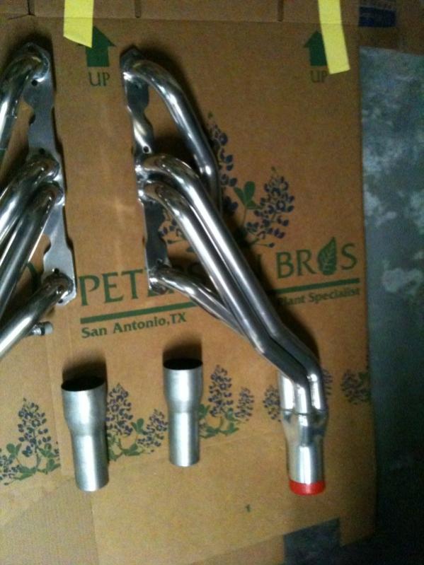

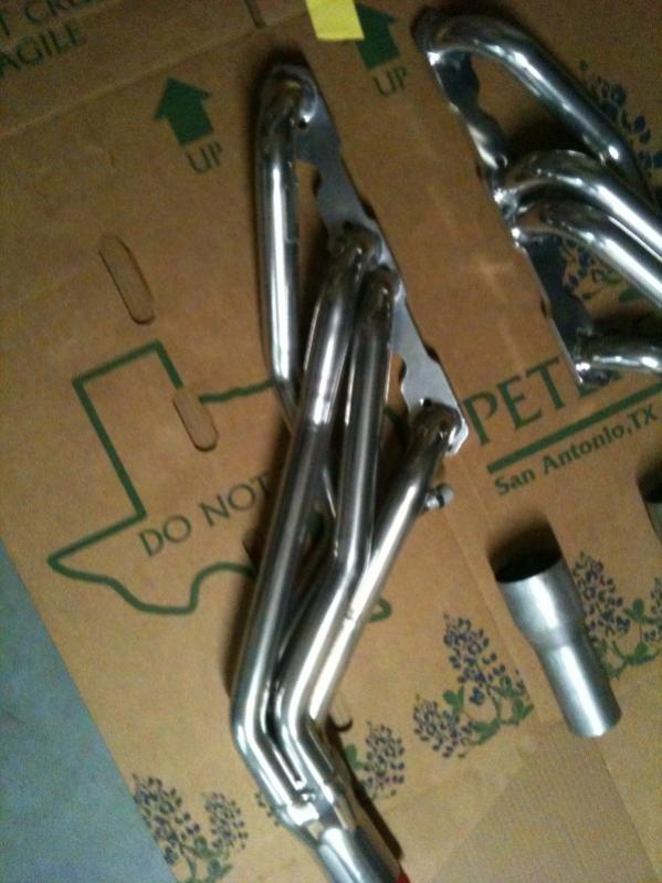

There here!!! I will get better pics of them with my planned set up later this week. Product looks great and is heavy compared to some headers I have looked in to flange is also nice and thick overall impressed upfront.

SO educate me on these, are you going to have to drill/weld in a spot for your upstream o2?
Are those coated?

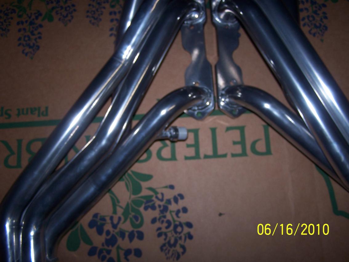

They are already equiped with the o2 sensor bungs for the left and right bank. The egr connection is found on the drivers side header the LTs have a spot for it to hook back up there to remain emissions legal. The biggest hassel will be sheilding the fuel lines as they recommend they even supplied the material to shield the lines!
---------- Post added at 07:17 PM ---------- Previous post was at 07:12 PM ----------
In the rebuild of my exhaust I will be adding two highflow cats and x pipe the o2 sensors will run one in each header then one after each cat. Justin said he will have to retune to modify the ECM for this.

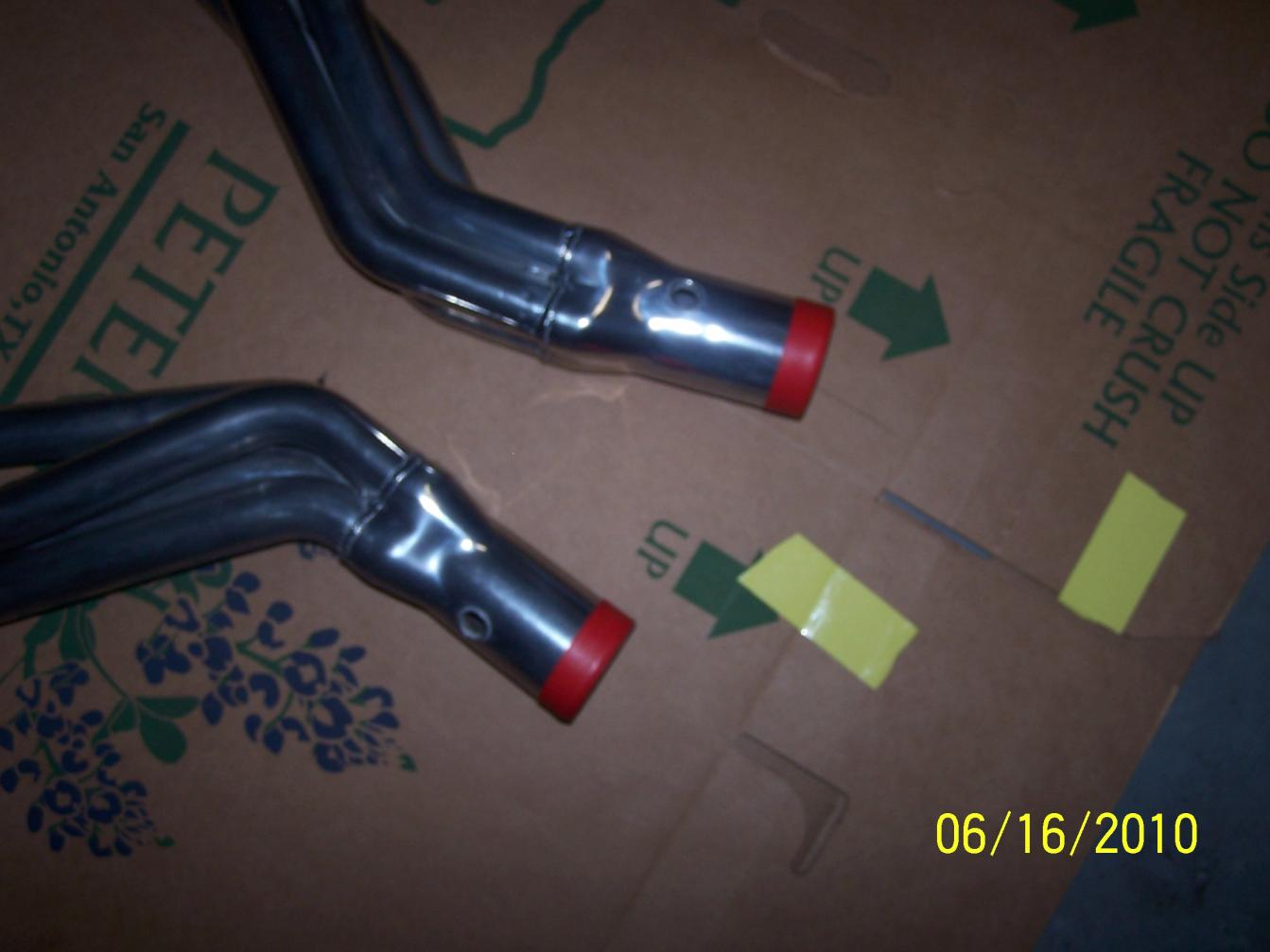

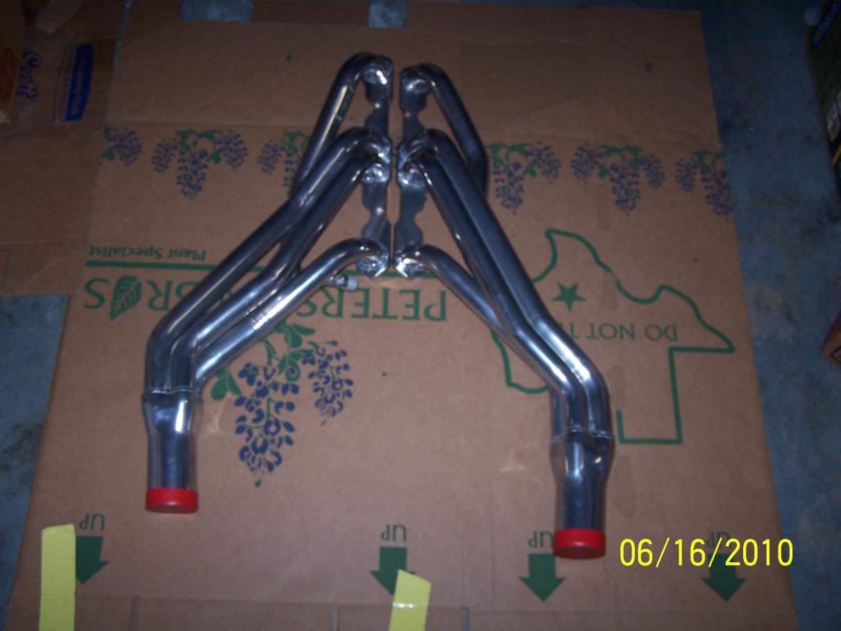

Well after newborn and promotin at work here are some updated photos. no install yet hope next week should be a fun ride to the shop open headers! have decided to run dumps but back towards the bumber in the left and right corners to help on the drone.
cool man, you'll love em...put mine in last week. They really wake up these engines!

BTW dont use the piece of crap paper gaskets, get some felpro's at autozone :waytogo:
Put em on dry, re-torq after a couple drives.
