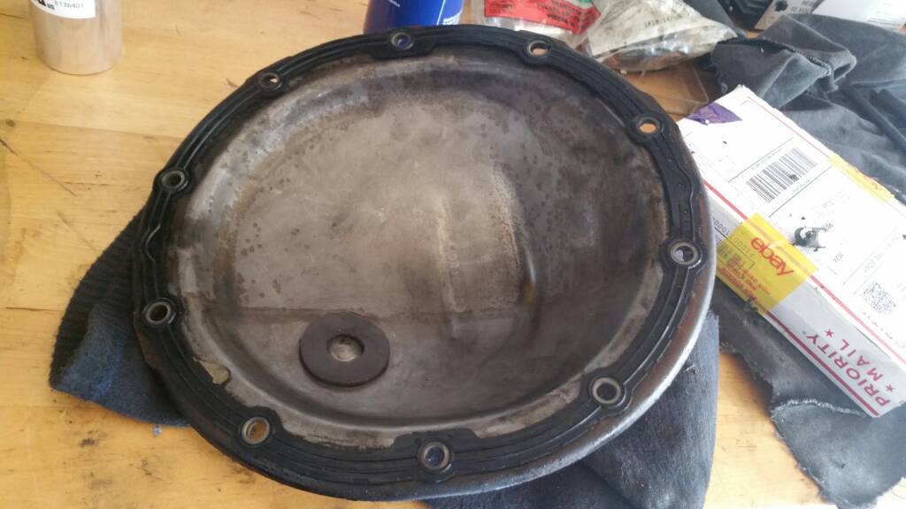

When I changed the rear differential fluid I used the rubber steel core gasket. Fits perfectly. Wanted to throw this up for the people who hate using RTV.
Truck from the factory had a paper gasket that fused to the steel. Was a pain to take off.
