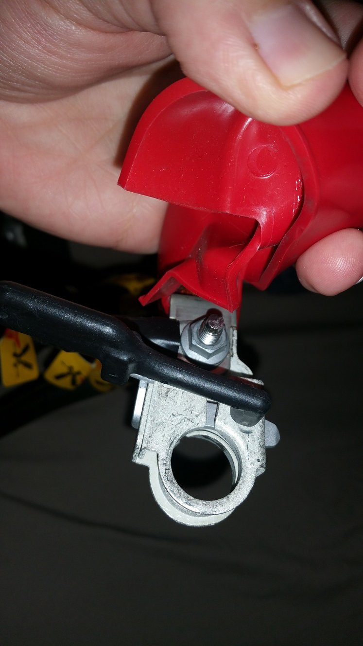

Well I cleaned and tightened both battery connectors and that seemed to work for a min.

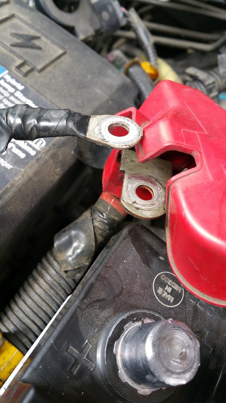

I get a P2101 on Monday so I took off the battery terminals cleaned the terminals and connectors really good - both battery and wires + taped up some exposed wire
Cleaned the ground on the front of the engine block + taped up some exposed wire
Cleaned the 2 connections coming from the fuse box + put some “liquid” electrical tape on a small part of exposed wire.

Sometimes the cables you mentioned cleaning and taping have corrosion under the rubber coating going up the cable you can’t see. To trace the ground wires a wiring diagram comes in handy. You can usually find them on line free.
