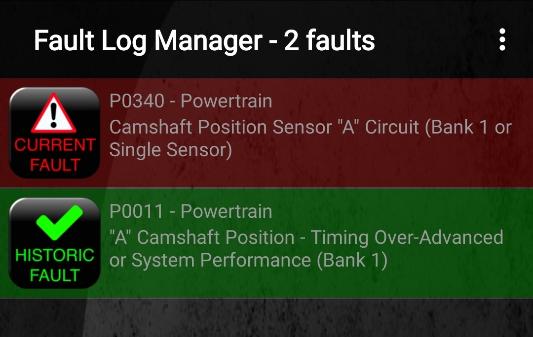

So today, after picking up my Denali after having a heavy duty transcooler installed, it hesitated to start and the check engine light was on. Didn't even make it out of the parking lot. Shop scanned and got the dreaded 011 and then p0340. I have the 'historic' fault in my Torque Pro, and it also showed the p0340.
Obviousy the camshaft position sensor needs to be replaced. Is the different camshaft causing issues too?

Wow 200 is pushing it...did you see temps like that before your tranny replacement? I rarely see over 175, even in 100 degrees heat.
I wouldn't think the cam sensor fault would cause your tranny clunk. Seems like a lot of other more common issues would be more likely.
