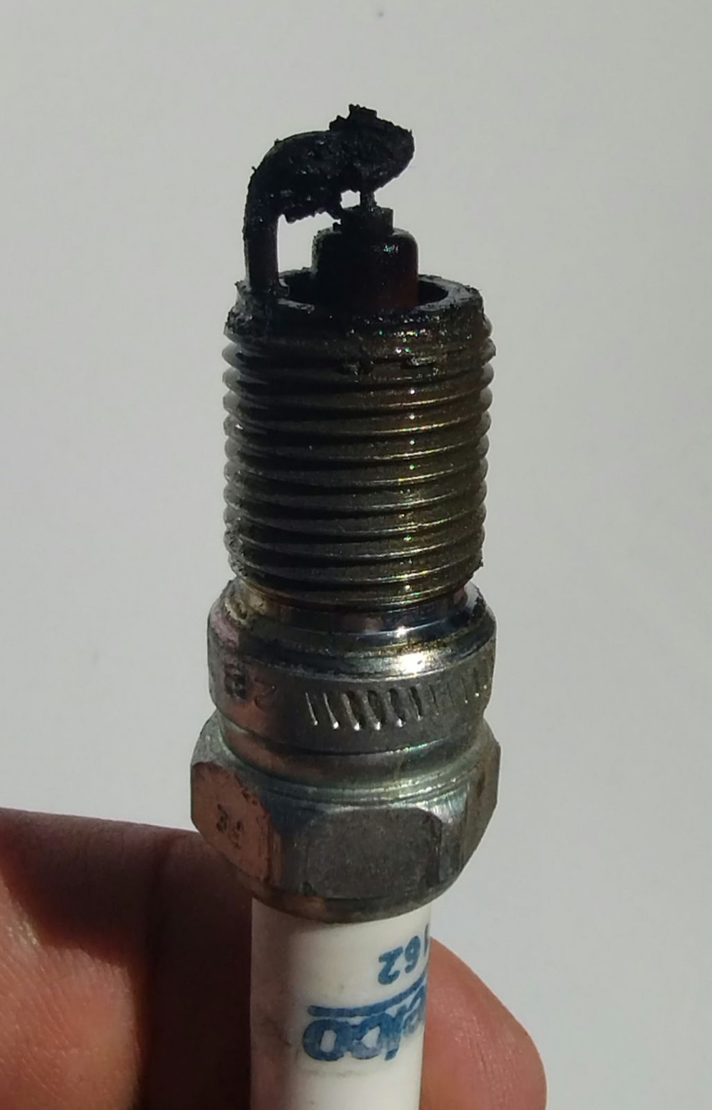

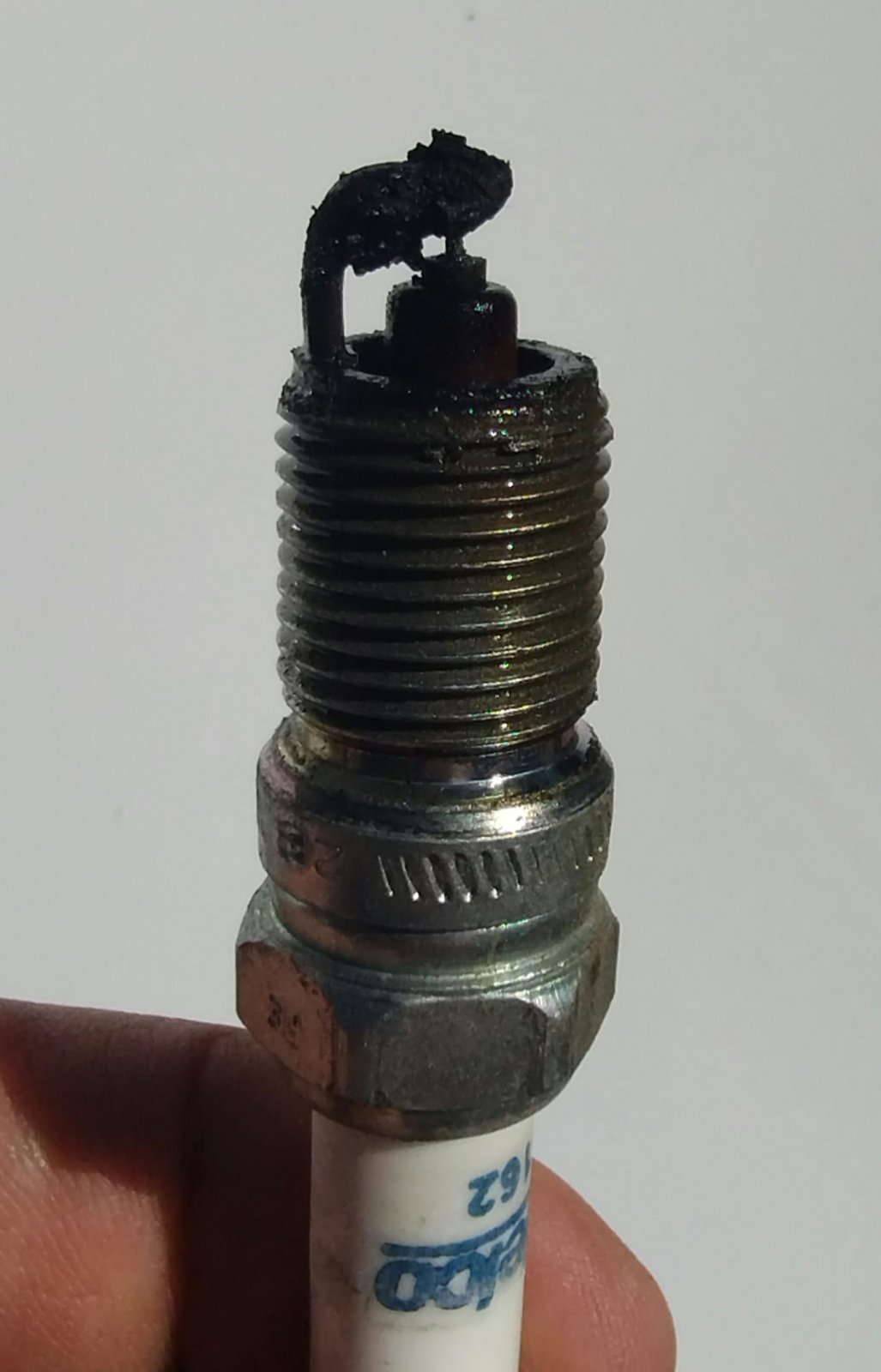

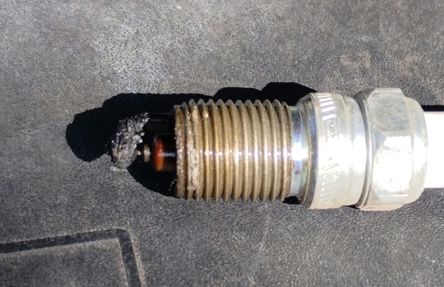

On the way home from East Texas, the truck threw the code, I limped her home and started researching. I went and picked up a new coil and spark plug this morning. Removed the spark plug and it looked like THIS. Also, the Traction Control and Stabiilitrak went offline.
I've NEVER seen a plug with this much gunk on it! Had anyone else seen this?
I installed the new plug and coil. She's marginally better but still missing. Went back, got the codes read and still has the P0301 code and also threw a Mass Airflow Sensor code so I bought some cleaner. Removed and cleaned that sensor but, still a marginal miss. The Traction Control and Stabiilitrak are back online.
So, has anyone seen a plug come out looking like this and, what else could I be missing to get rid of the miss.

that is an impressive bad looking plug.
I'm. guessing oil burning. the 2 things that. Come to Mike is search donjetman threads about rings coked up and what he did to free them up. if it's older than 2011 and you haven't done it. there's an updated valve. cover for. better oil. control. less being sucked into the intake. and then add a catch can.
byond that. I don't know besides a rebuild

Oil Consumption for sure!! Check some other plugs as well.
Updated valve cover, Rings, maybe bad valve and/
or valve seal/valve seat
will allow tons of oil into the chamber
Do a compression test as well
To add: whenever you get hard codes like misfire, the stabiltrack/abs/etc
will all light up.. That's normal.. due to it being disabled by the Engine Codes being
thrown

Would it be worthwhile to run a quart of ATF in her for ~50 miles and dissolve what apparently is a lot of gunk in the cylinder heads before performing an immediate oil change?
there's a lot of debate on if the atf actually cleans anything. I don't believe it's doing much in your case. you need to keep the oil from getting into the cylinders and burning. either from the intake port or piston rings. which is why you pour the solvent into the spark plug hole and let it set for a while and try to eliminate it getting in thru the pvc system, with the updated valve cover and catch can.
byond that, it's replacing parts. like those valve guide seals, I believe those can be done without pulling the heads. but they are under the valve spring.

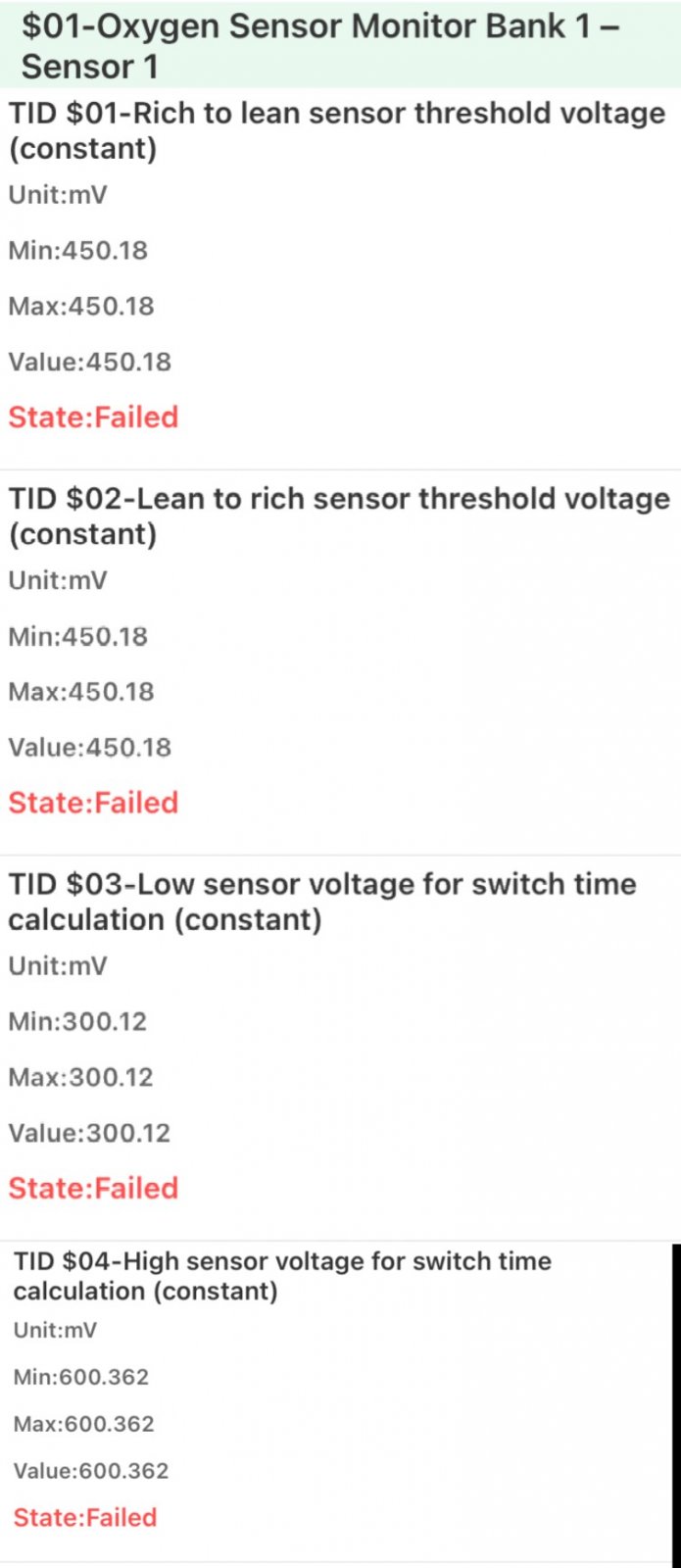

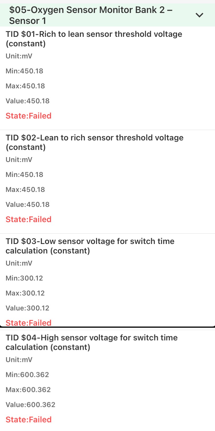

Since there are valve covers that help with this sludge mess I'll get those however, my immediate focus is on dealing with the miss.
I bought a couple different affordable OBD readers and it's giving me some data. Although, I'm not certain if I'm understanding it.
Does the fact that it's seeing issues with Bank 1 and Bank 2 mean that there's a miss on Bank 2 that isn't being registered as an official miss?
