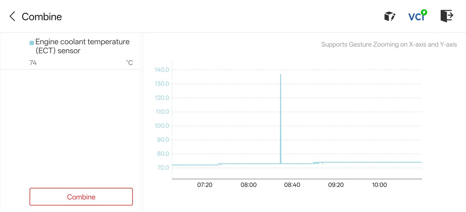

This is interesting. It's running right now maintaining about 74C which is about 165F (I can't get the units changed to F). The upper hose does have heat. I have a graph running on my scan tool to show the progression of the system heating up and there was a spike where it went to 135C.

the thermostat could be sticking, if you do not have the part available or handy and need to drive it, you could pull the thermostat and be better off than overheating.

I kinda wonder now if the issue is something to do with the coolant temp sensor circuit. Is there something that messing up the value being broadcast over the CAN network. Why would the data when I was running the graph spike? Was there something that was making the gauge read artificially high?
I had a similar issue about a year ago that I never figured out. The gauge was reading about 180F and the value being broadcast matched. I changed the thermostat thinking it was stuck open some but that didn't fix it. The issue went away afterwards though so I never figured it out.
