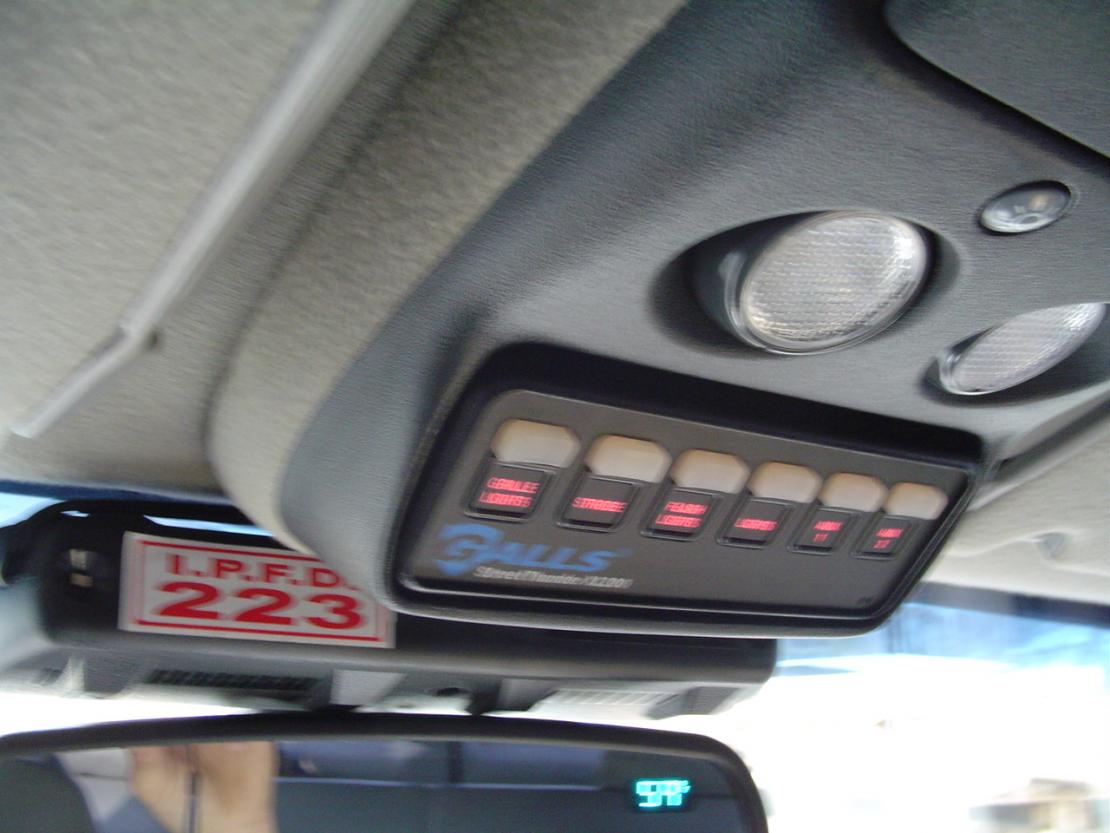

I have a 98 2dr Tahoe with no rear heat (see Attached Picture) which i put my switch panel in for all my emergency lights. I just picked up a used overhead console from ebay for a 99 suburban with the 3 buttons for the garage doors. I want to hook up the garage door openers so they work. there are 3 wires, Orange white and black. What wire goes to what ?

Orange-switched 12 volt or hot all the time depending on what you want
Black-ground
White-dimmer for the backlit switches
Then you'll have to program it, I don't have any info on that, check the Homelink website
Do you happen to have a link for that switch panel or did you make it? I've never seen one before

Thank. My factory wiring harness has 3 wires already. black , orange and brown. couldnt figure out where the brown went so i cut it and just ran a new wire. Programing for those are actually really easy thanks
