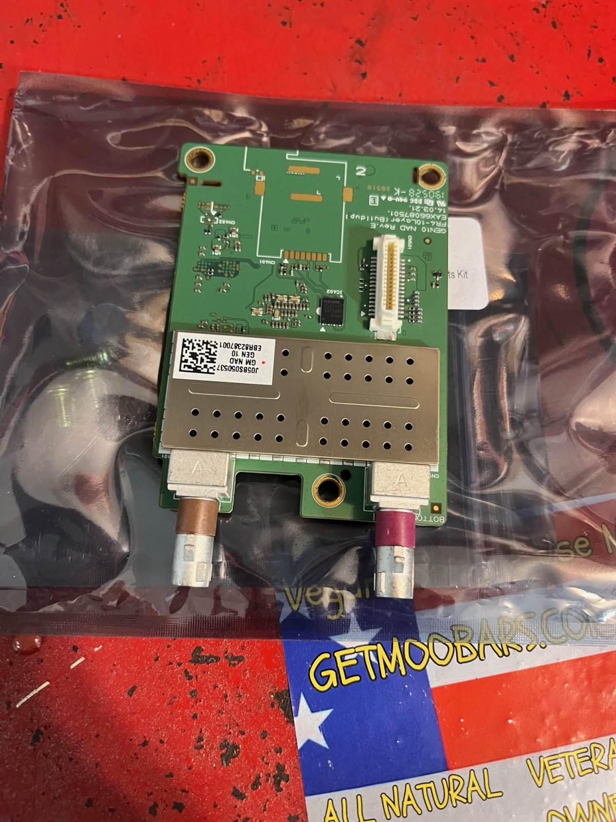

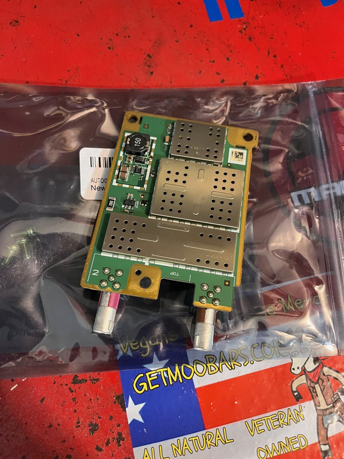

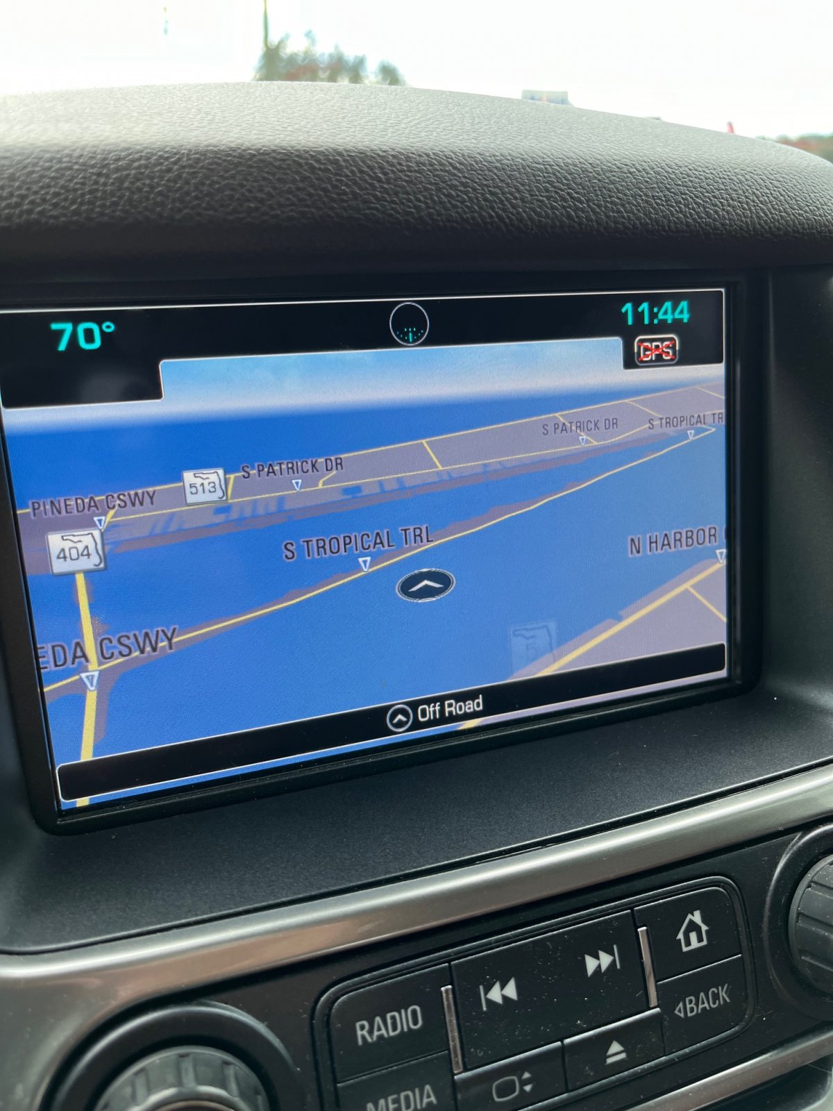

Ok, it was in the same location but I couldn't get the box out without removing the mounting frame which required additional dash parts removal. It was like wedged too tight for me to get it out.

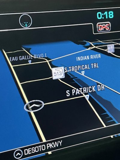

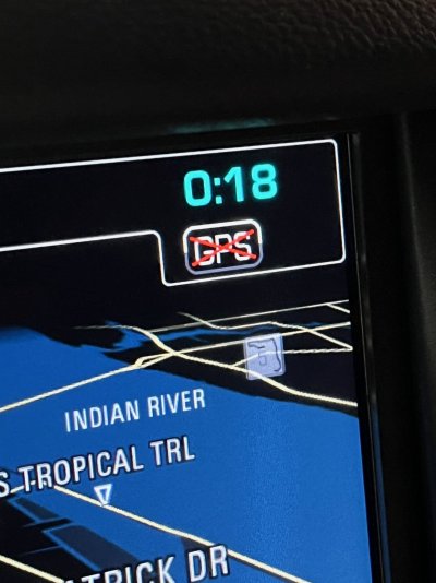

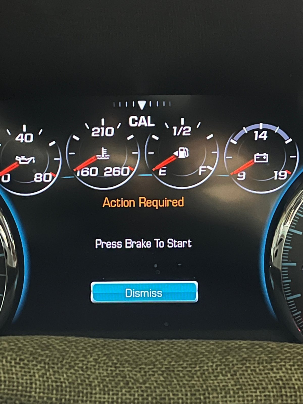

Anyway, circuit card has been removed but unlike my Colorado, there were two connections on this card; on burgundy and the other brown. I know the burgundy is for Onstart. Is the brown for XM radio?
Currently shows CAL top center dash, GPS on NAV page has a red X thru it, but the Navigation is still operating by showing my movements on the map page. Is this due to my iPhone being connected and borrowed?

B-train, the circuit card is removed and everything is reassembled and working fine.
Just went back and reread the entire thread. Looks like the brown connection could be cellular instead of XM. Either way, my NAV is still tracking movements so onto the next level of detachment...

Update; I turned off my iPhone, then attempted to use Onstar, and finally tried to see what was available to include phone contacts. Nothing was working so I turned my phone back on and shortly thereafter I noticed that the 'speed' indication in my HUD was no longer there. Switched back to GM navigation and found myself over water lol...so I guess it has finally taken and no longer usable.
