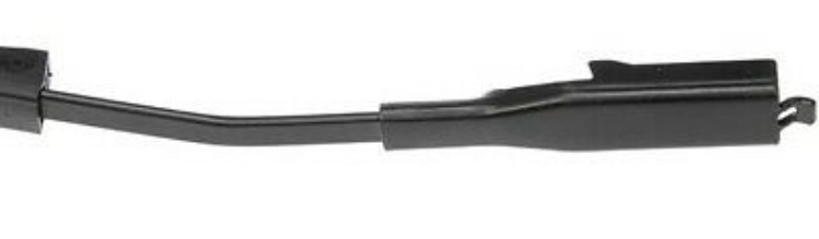

This style

Theres a period I guess GM got creative. I think theres an old TSB to replace with J hooks, but not for free
My wife stopped at an O’reillys once with our 2007 and the store manager couldn’t figure out how to even remove the old wiper so he basically busted it into pieces and got it off, then he couldn’t figure out how to get the new one on. Fortunately he did this to the passenger side. He said maybe your husband can figure it out and wrapped the end of the arm with duct tape and sent her in her way home. I couldn’t believe it.

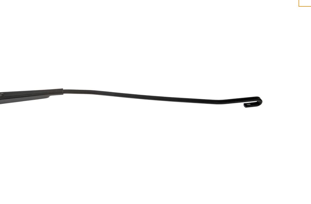

weird the one I posted above is the same one that was on my 00, 03, 04, 12, my 18 is the only one that has even been different is has a fat wide clip
I think they only did that on ‘07 and ‘08 and maybe ‘09. Can’t remember what my ‘09 Suburban had. Didn’t have it that long. My ‘13 has what your picture shows thankfully.
