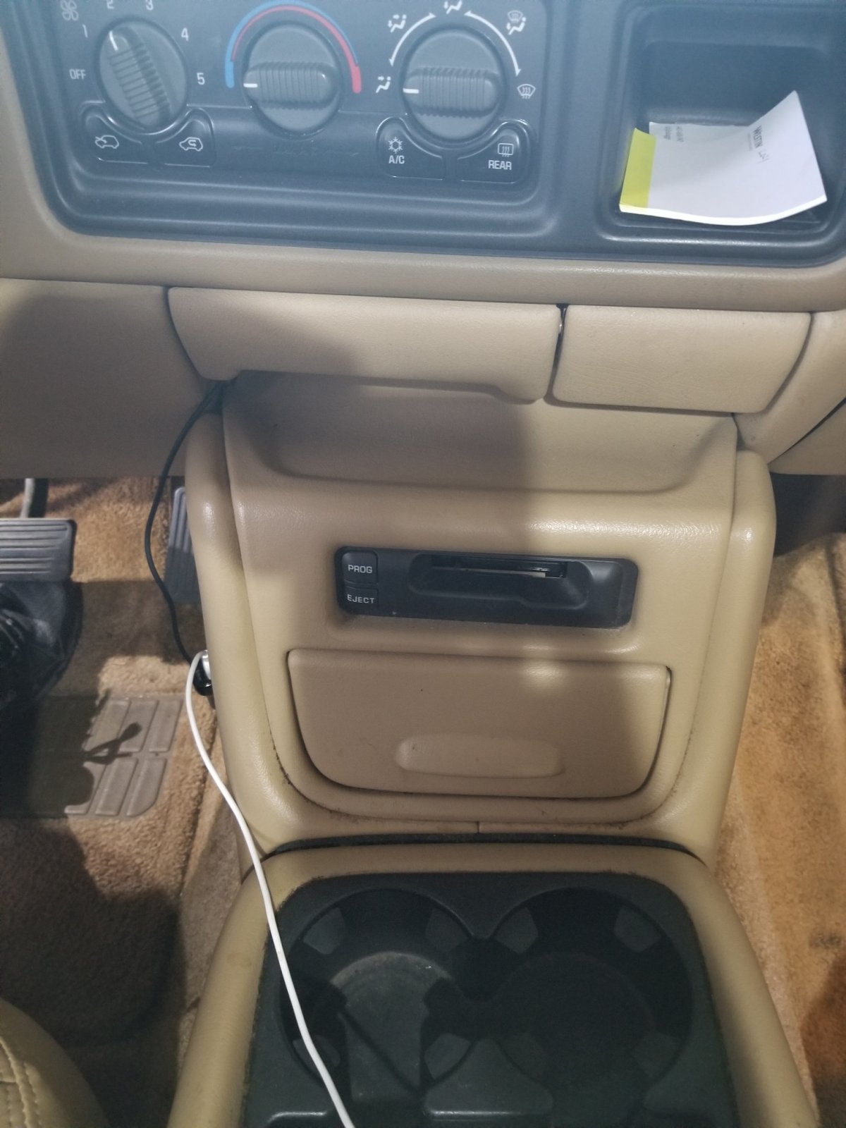

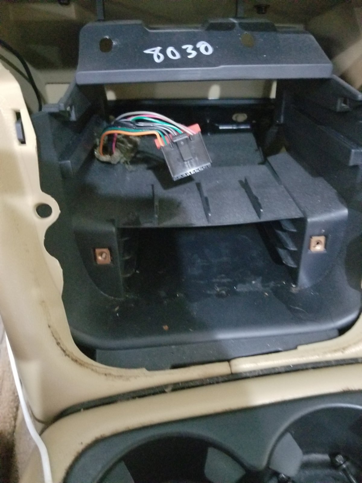

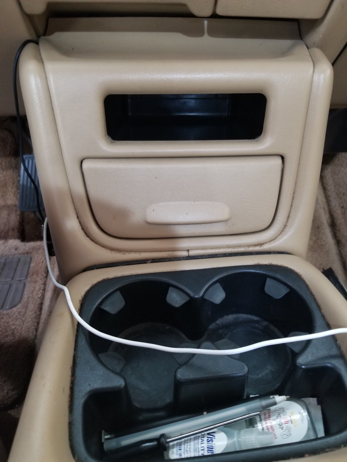

This is a stone cold simple project but I'm going to throw it out there to help anyone tired of looking at an old remote cassette player. It cost me $10 for the part from Amazon, took 25 minutes, and fits perfect. It would have taken 10 minutes at most if I'd had a 7mm (9/32") socket vice using a box end wrench inside the trim.
Process: Lift the lower cubby door, remove the two 7mm screws, lift the trim piece up. Remove old player by pushing down on two levers on either side of it. Disconnect the player's wire harness at the back. Slide new cubby hole in until it clicks. Put trim down and then tighten screws. $10 and 10 minutes. YouTube has a couple of videos. https://www.amazon.com/gp/product/B00DDYNUC0/ref=ppx_yo_dt_b_asin_title_o00_s00?ie=UTF8&psc=1
