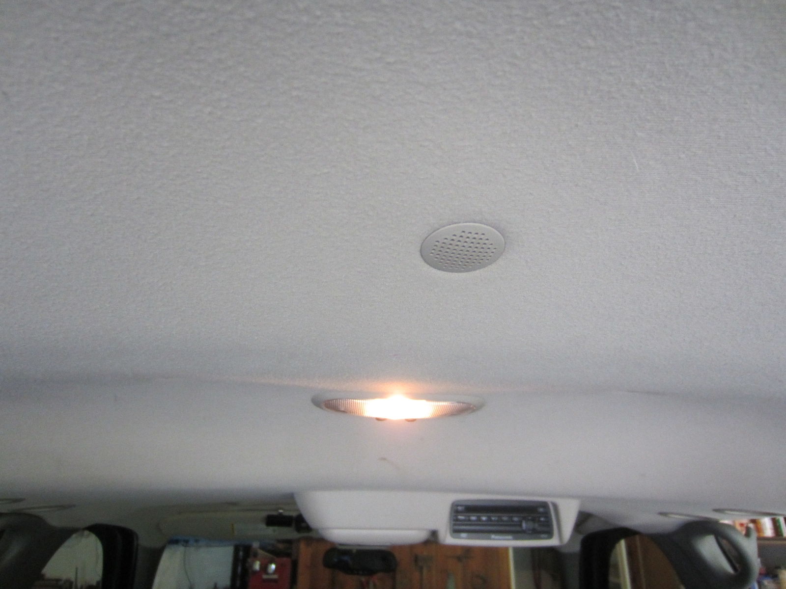

    2006 Tahoe. This little button is in the roof of the truck above the rear seat. It's making a noise like a fan motor and I can't seem to control it... so what is it and what does it do?
    Thanks!

    You should have two, funny story about this, when I first got my 04 suburban I thought they were the microphones for the Bluetooth, so I kept talking into the one above me. Duh Headstrike. Anyway, they are only about 30 dollars at rock auto and are not hard to install. they usually don't last very long before starting to make the noise again.

    Try taking it down and blowing it out with compressed air first.

    Thanks for the comments guys. I'll hit it with some air and see if that quiets it down.

    They are cheap on amazon, I keep forgetting to install mine.
