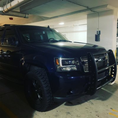

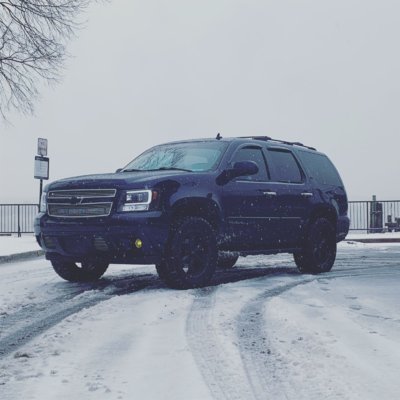

Ok 2.5” installed
GLcash
May 14, 2016

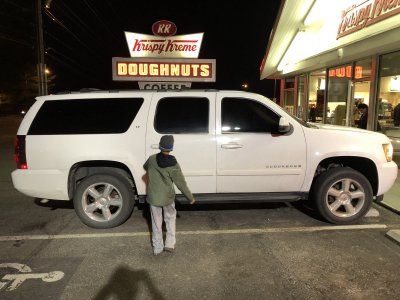

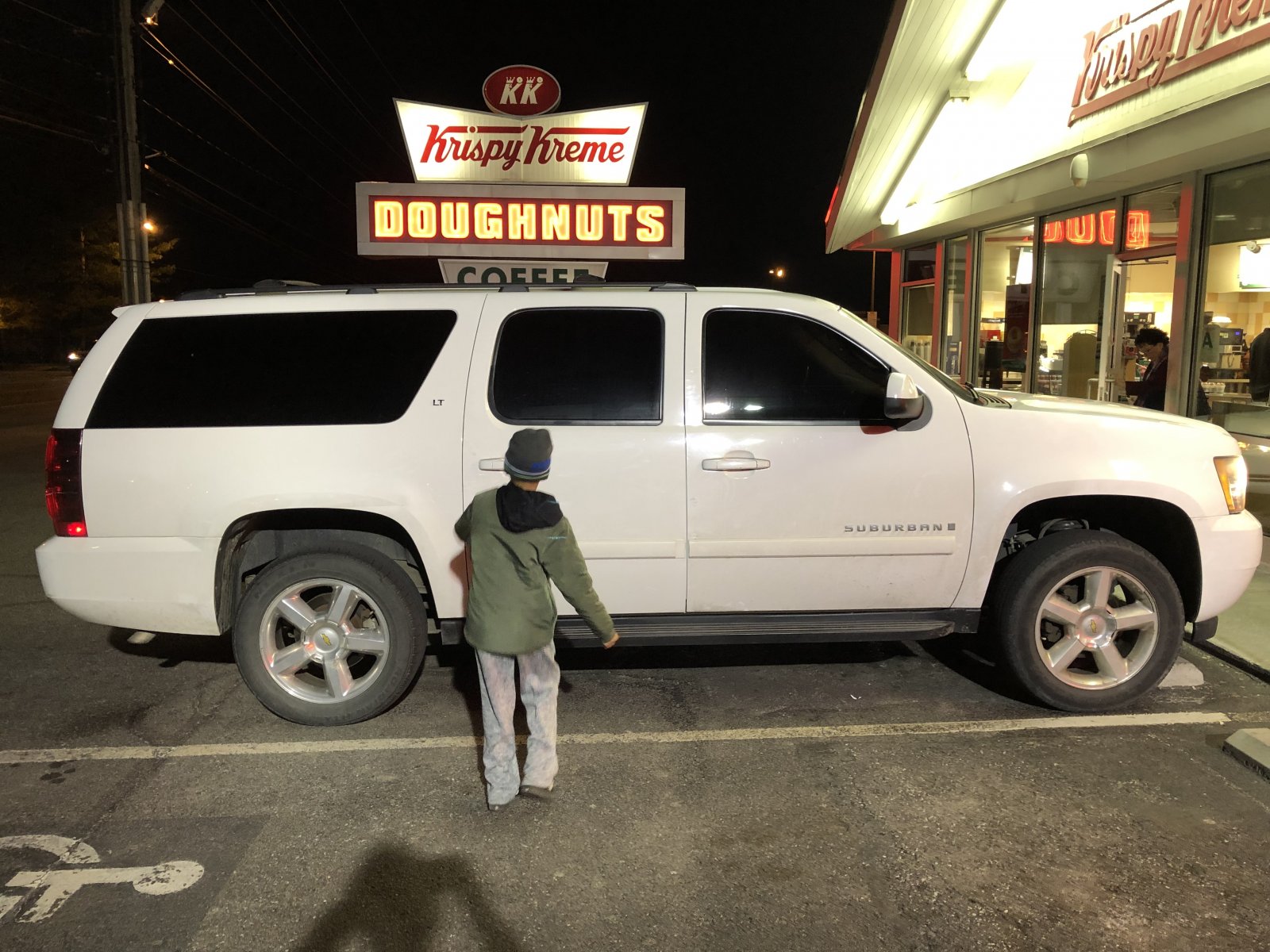

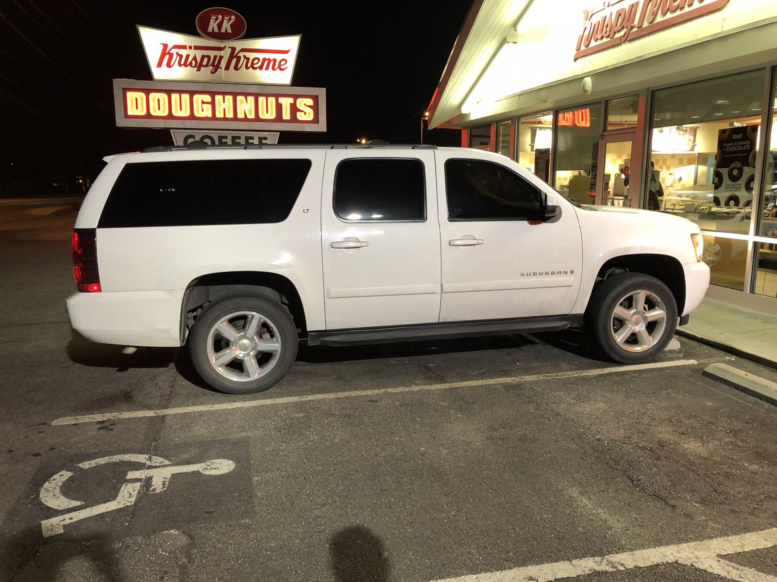

installed the CMM 2.5” leveling kit today on my 2007. Now it’s time for new deep tread tires! Thinking about the 295/55/20
DC6C0264-B942-4A04-A461-C940AA78B2AC.jpeg 80020A8C-F890-466A-80E6-E952E94A052D.jpeg

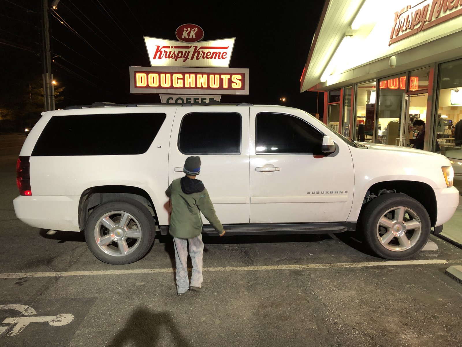

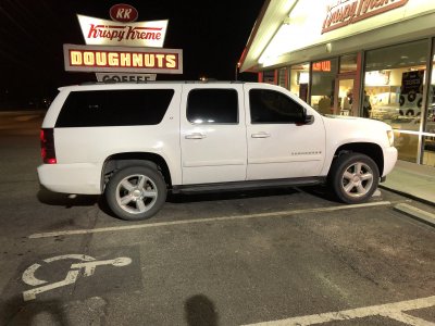

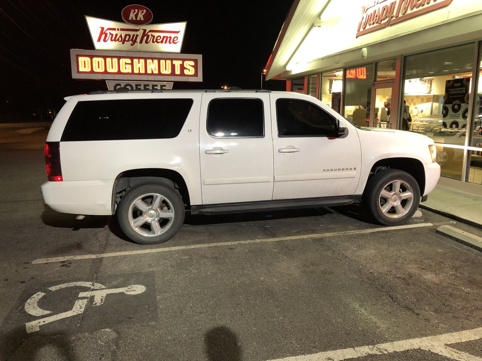

Did the same on 13 Yukon xl. Mine might be just about level, the rear spacer would definitely put a rake back on it.
thanks for letting me know. I have a 2010 denali xl and bought 2.5 for front and 1 inch for the back

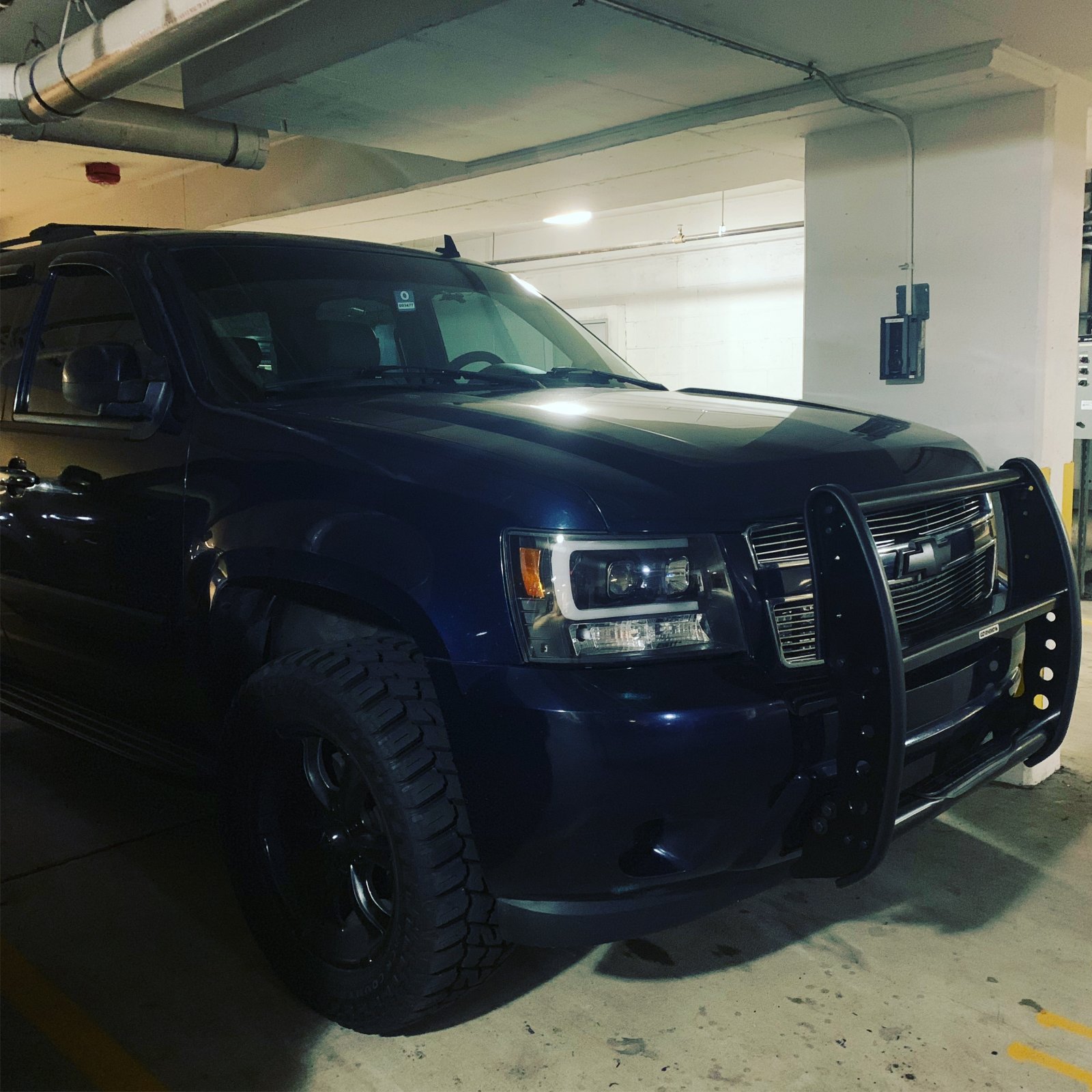

I ran both 305's and 295's. Depends really on the tire. I had Nitto Mud grapplers in 305's, had to do quite a bit of trimming and remolding of the inner fender liners. Also had to trim a tiny bit of body metal from right behind the madflap area in the front wheel wells. The 295's Nitto Trail Grapplers fit better. And the 305's only rubbed at full lock after the trimming, etc.
