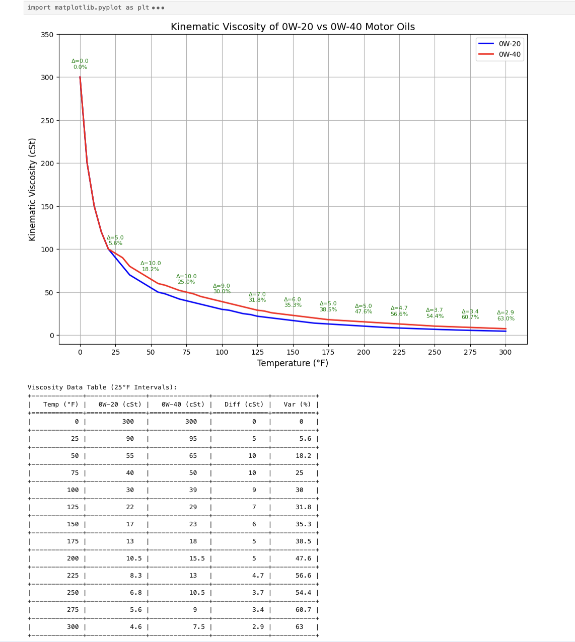

Interesting looking at percentages of difference over temp.
Kinematic viscosity is a measure of a fluid's resistance to flow under the influence of gravity. It essentially describes how easily a fluid flows when it's not being actively pushed or pulled by an external force (other than gravity). It's the ratio of a fluid's dynamic viscosity to its density.
  • Lower cSt values indicate a thinner oil that flows more easily (better for fuel efficiency and cold starts)
  • Higher cSt values indicate thicker oil (better for high-temperature protection).
  • Measurement: Kinematic viscosity is typically measured at 40°C (104°F) and 100°C (212°F) for motor oils, as these temperatures reflect typical engine operating conditions.
Any errors are Groks. Just had it tell me this then asked to write python to graph it. My wife has a 23 Yukon 5.3
Automotive engine oil pumps do not necessarily pump at the same rate regardless of viscosity, as oil viscosity significantly affects the pump's performance. Here’s a concise explanation:
Key Points:
  • Oil Pump Design: Most automotive engines use positive displacement pumps (e.g., gear or gerotor pumps), which are designed to move a fixed volume of oil per revolution or cycle, theoretically delivering a consistent flow rate regardless of viscosity.
  • Viscosity Impact:
    • Higher Viscosity (e.g., 0W-40 at low temperatures): Thicker oil increases resistance to flow, causing higher pressure in the pump and potentially reducing the actual flow rate slightly due to internal leakage or pump inefficiency. The pump may also require more engine power to operate.
    • Lower Viscosity (e.g., 0W-20 at high temperatures): Thinner oil flows more easily, reducing pressure and allowing the pump to maintain its designed flow rate more effectively, but it may lead to lower oil pressure if too thin for the engine’s design.
  • Pressure Regulation: Most engines have a pressure relief valve in the oil system. If viscosity is high (e.g., cold 0W-40 at 0°F, ~300 cSt), the pump generates higher pressure, and the relief valve may open to prevent damage, diverting excess oil back to the sump, which can reduce the effective flow to the engine.
  • Temperature Effects: From your viscosity data, 0W-20 and 0W-40 have similar viscosities at low temperatures (e.g., 300 cSt at 0°F), so the pump’s flow rate would be similar in cold conditions. At higher temperatures (e.g., 300°F, where 0W-20 is ~4.6 cSt and 0W-40 is ~7.5 cSt), the thinner 0W-20 flows more easily, potentially leading to lower pressure but similar pump flow if the system is within design limits.
  • Engine Design: The pump’s flow rate is tuned to the engine’s requirements. Viscosity variations (within SAE specifications) are accounted for, but extreme viscosities outside the recommended range (e.g., using a very thick oil in a system designed for thin oil) can cause insufficient flow or excessive pressure.
Practical Implications:
  • Cold Starts: At 0°F, both 0W-20 and 0W-40 have high viscosity (~300 cSt), so the pump works harder, and flow may be slightly reduced due to pressure relief valve action.
  • Operating Temperatures: At 212°F, 0W-20 (8.5 cSt) flows more easily than 0W-40 (14.0 cSt), potentially resulting in lower oil pressure for 0W-20, but the pump’s volumetric flow rate remains nearly constant unless limited by system design.
  • Pump Efficiency: Positive displacement pumps aim for constant flow, but real-world factors like internal clearances, pump wear, or extreme viscosities can cause minor flow variations.
Conclusion:
While automotive oil pumps are designed to deliver a consistent flow rate, viscosity affects pressure and pump effort more than flow rate. Higher viscosity oils (like 0W-40 at lower temperatures) increase pressure and may trigger the relief valve, slightly reducing effective flow to the engine. Lower viscosity oils (like 0W-20 at higher temperatures) maintain flow but may result in lower pressure. For 0W-20 and 0W-40, the flow rate differences are minimal within typical operating conditions, as both oils are designed for similar cold-start performance (0W rating).
