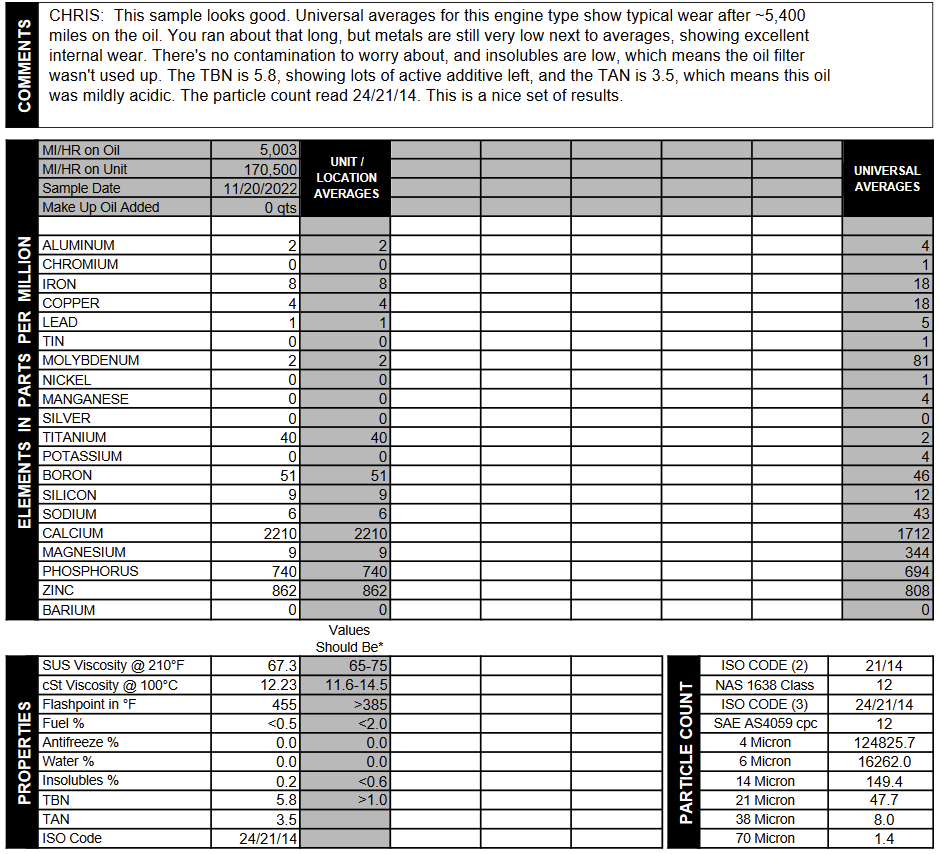

Oh yeah... Because I realize saying that "it's fine" to run a high pressure pump without any data is anecdotal at best and misleading at worst...
Have an oil test from my rig.
Melling m295hv pump w/ the high pressure spring. I don't remember exactly which spring I used.. I could dig it up if needed. Edit: I used the red spring. IIRC it's 70psi. Oil pressure at hot idle is 48-50psi.
Castol 0w40 euro spec, Fram XG3695 (long can, sits flush with the bottom of the oil pan) and a pcv oil catch. I used to run my engine 1qt overfilled on oil out of an abundance of caution - oil drainback from the heads to the pan. Wasn't sure if the extra volume pushed around by the pump would cause an issue at higher RPMs, but that's never been realized. The oil oil sensor on my rig is a great early warning for that, but I've never had it go off, even cranking up a mountain pass at 4k rpm for 8 minutes straight.

Mindless drivel out of the way... Here have my oil test
