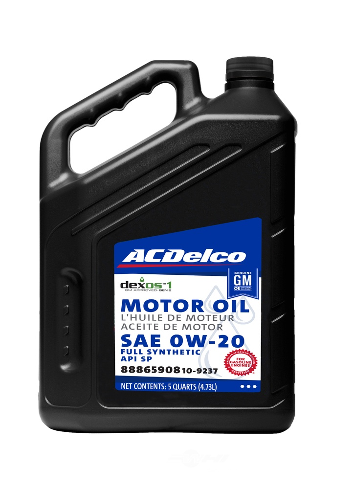

How about the stuff that was made for your truck?

I get that, my question is do I have something seriously wrong internally, or are these engines very sensitive to what oil is run in them. In my Hemi Ram trucks they made all sorts of valve noise with the stock mopar oil so I switched to the penzoil UP as suggested by everyone on that forum.
Just like everyone on this forum recommends switching trans fluid to Amsoil instead of the "stuff that was made for it"...
my question is, is there a specific oil that is best for the 5.3, or does that not matter and I actually have an issue with the motor?

I don't think so. Change oils and consider sending off a sample to Blackstone Labs for analysis.
My engine would rattle in the morning on start up when running Mobil One. After switching to ACDelco's oil it stopped doing it and gas mileage improved a tad. The engine only consumes oil when it is regularly revved above 3000 rpms. Such as when my wife drives it! it consumes no oil when I drive it. LOL

I'm going to dump the penzoil out and refill with OEM and see what happens. Seems like a lot of consumption to not have a trail of blue smoke behind me. Not sure where it's all going, but I'll see if AC Delco oil makes a difference.
